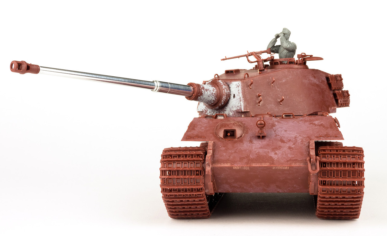

Interesting discussion... I'm actually drawn towards kits with HIGHER parts counts. Not because I like over-engineering but I like the idea of more detail, not less. Plus, I like my projects to be involved. I don't like kits where you can see the entire aircraft exploded onto 2-3 simplified sprues.
I think the Meng King Tiger kit will satisfy my parts count criteria and then some. Looking at online builds, one issue that many have run into with this kit is the weird skew of the wheel axles when the suspension arms are installed. Here is an example from Andy Moore's build review at The Modeling News.

Interesting note, John! The angled axles look very visible in the final assembly from this angle.

The skew of wheel axles seems to be tied to the backing plates, which are glued into the interior of the hull and have receptacles with center alignment pins for the swing arms.
Noting the uniform skewing of all of the wheel axles in the downward direction, my assumption is that the holes on the backing plates does not line up perfectly with the holes in the hull. The backing plate might be set too high. I'm guessing that this a correctable problem... possibly by shaving down the glue edge of the backing plate and lowering it so the holes are centered. You can see from the photo below from another online build that the center pins inside each receptacle sit a bit high compared to the holes in the hull. This is my analysis without having the kit in hand to verify.

That’s a great assessment! I concur. I also thought the two interior “spacers” which are added if no interior is desired push the interior plates out of alignment.

If your solution by aligning the hole patterns shouldn't work, I'm sure some weight in the hull will take care of that. I added about 200 grams in my Meng Panther to make that workable suspension really "work", as I'm planning to place it into a diorama.jkim wrote:(...) Looking at online builds, one issue that many have run into with this kit is the weird skew of the wheel axles when the suspension arms are installed. (...)

That's a good back-up, Torben. Will keep that loaded in the magazine but I'm hoping for the true alignment fix. Some have mentioned no issues with their axle alignment and the idea of Meng providing a fix on later production runs has come up. We'll see... we'll see!
