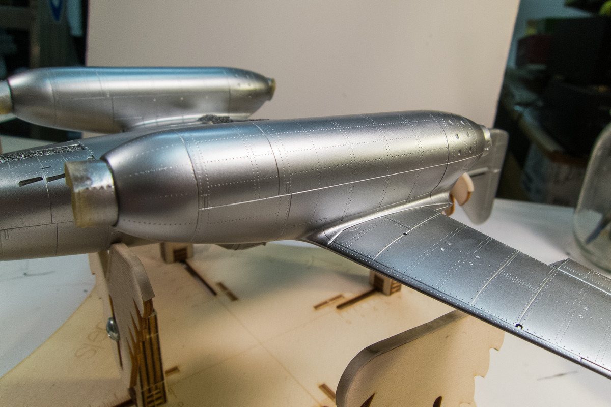

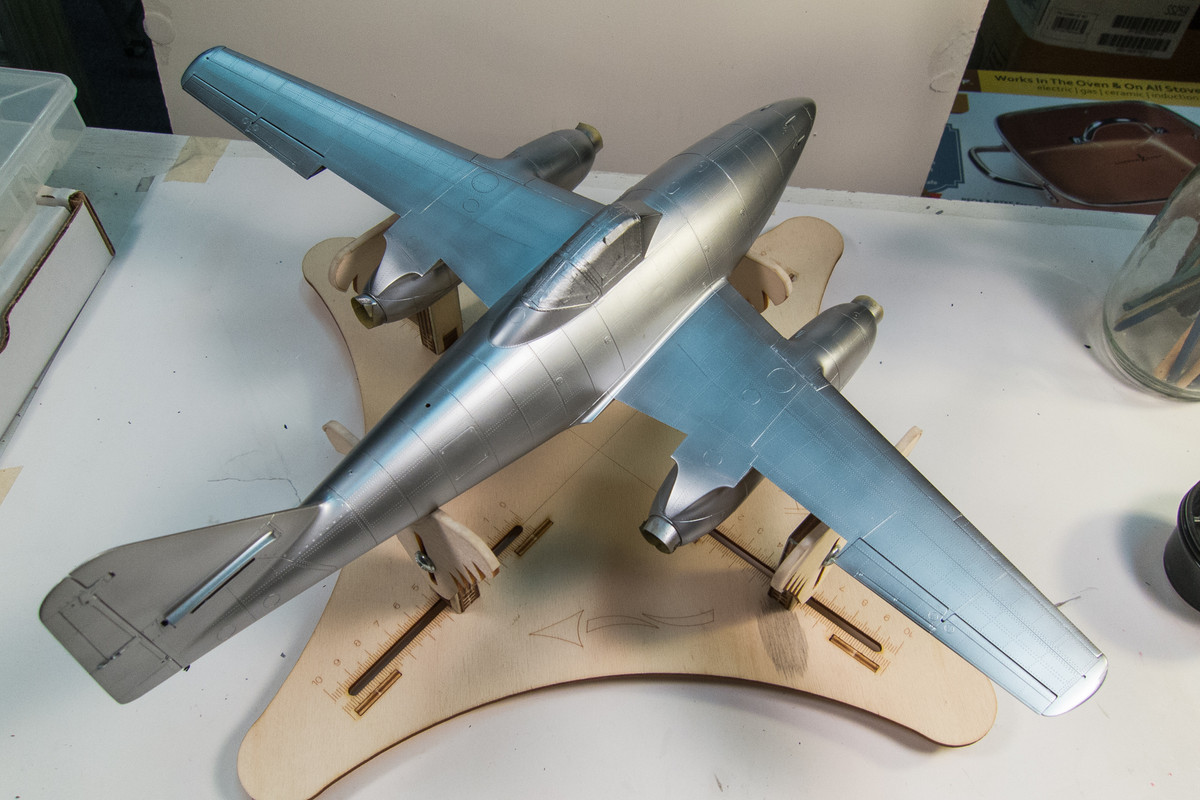

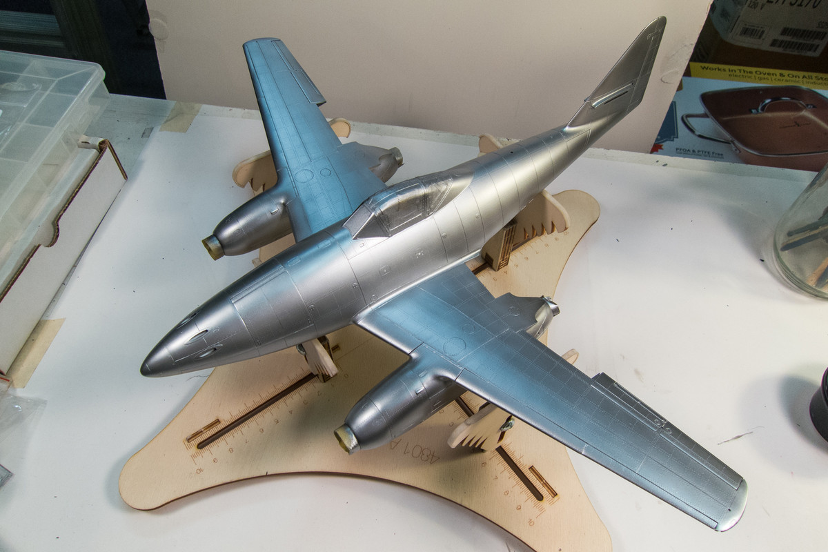

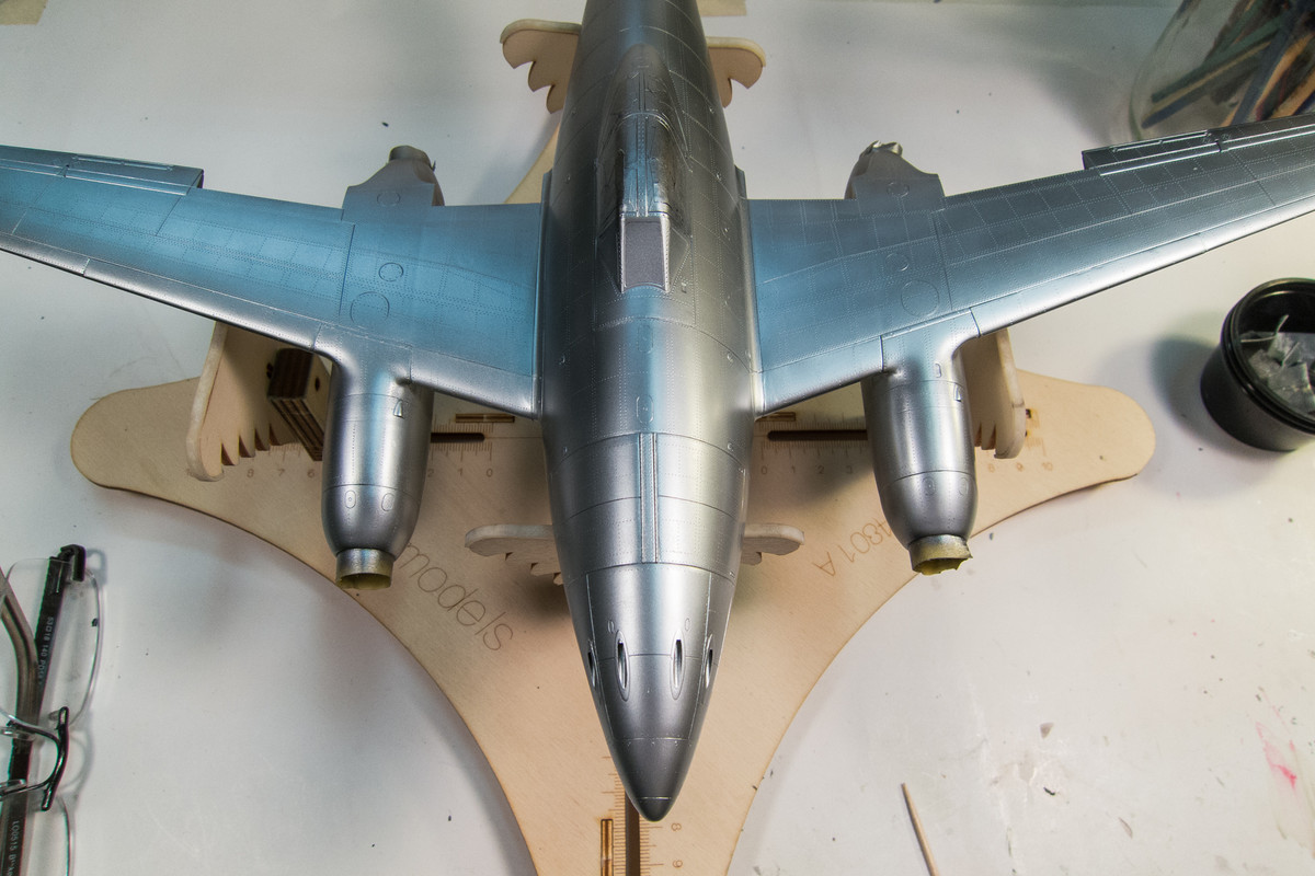

Thanks guys! This will no longer be a black-base build. I've done and sprayed the whole thing silver. Decanted Tamiya AS-12, thinned with Tamiya Lacquer thinner and some Mr Leveling thinner to help even out the coat.
The plan now is to establish the putty lines and then apply hairspray over the wing roots to facilitate chipping afterwards. Not sure if I'll add some mottling to give the camo some tonal variation... maybe some color other than black.

This is just off the charts in all ways, John! What incredible seam filling, rivet tooling, assembly and finishing excellence! I love the frontal shots, and the subtle shifting of tones around the curvilinear forms! Way to go! Also, don’t throw me in a lava pit, but—
And I know you will take this finish and layer on the layers and layers of filler, camo, unit markings, in order to make this complete, but right now, WOW!

That’s beautiful.
And like you, I’ve been considering the idea of a metal base and not black. I have a Zero on the way in the mail, a 1:48 which I wish to tackle after my current 1:48 Emil and Corsair are complete, before tackling my 1:32 Zoukei-Mura Raiden.
Of particular interest to me is how you decanted the rattlecan stuff and thinned it yourself for use on this model. I really, really enjoyed looking at this photos. The silver looks very nice. You made the correct call, and pulled it off. Very good.
