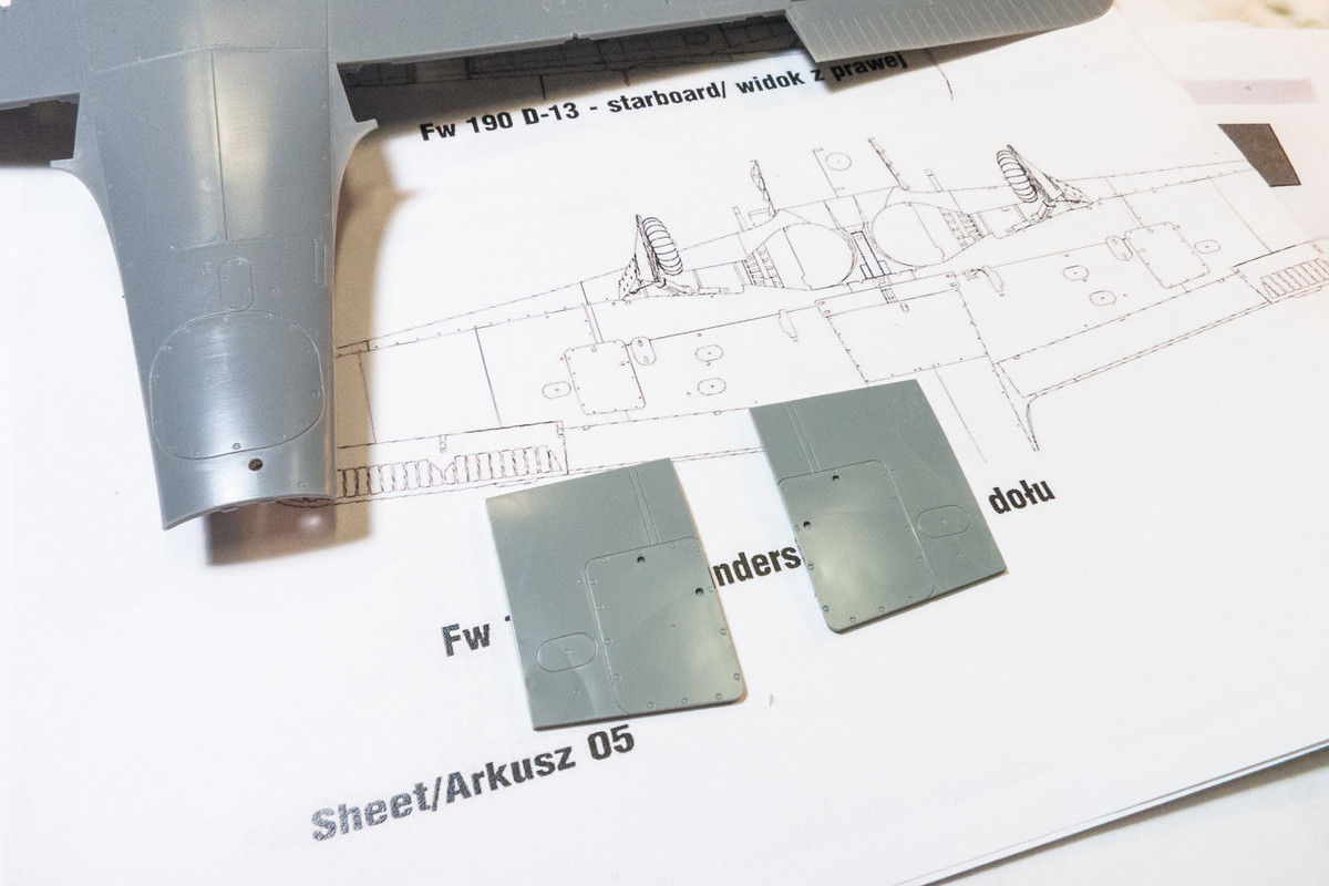

I would never have noticed unless it was specifically called out in the drawings of the D-13 that I was looking at...
Since we are looking at those drawings, here are the cross-sections that indicate that the bulge was only evident along the top edge and not the bottom as depicted in the GM resin conversion...

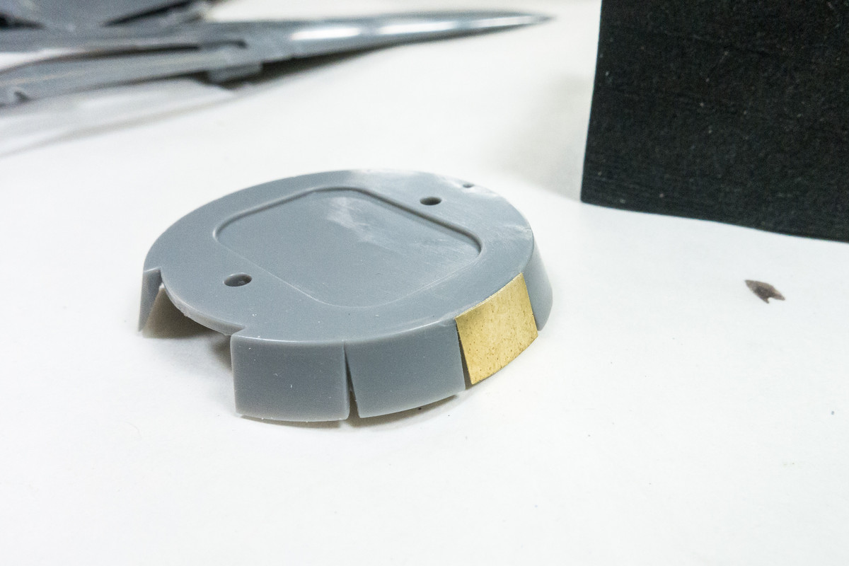

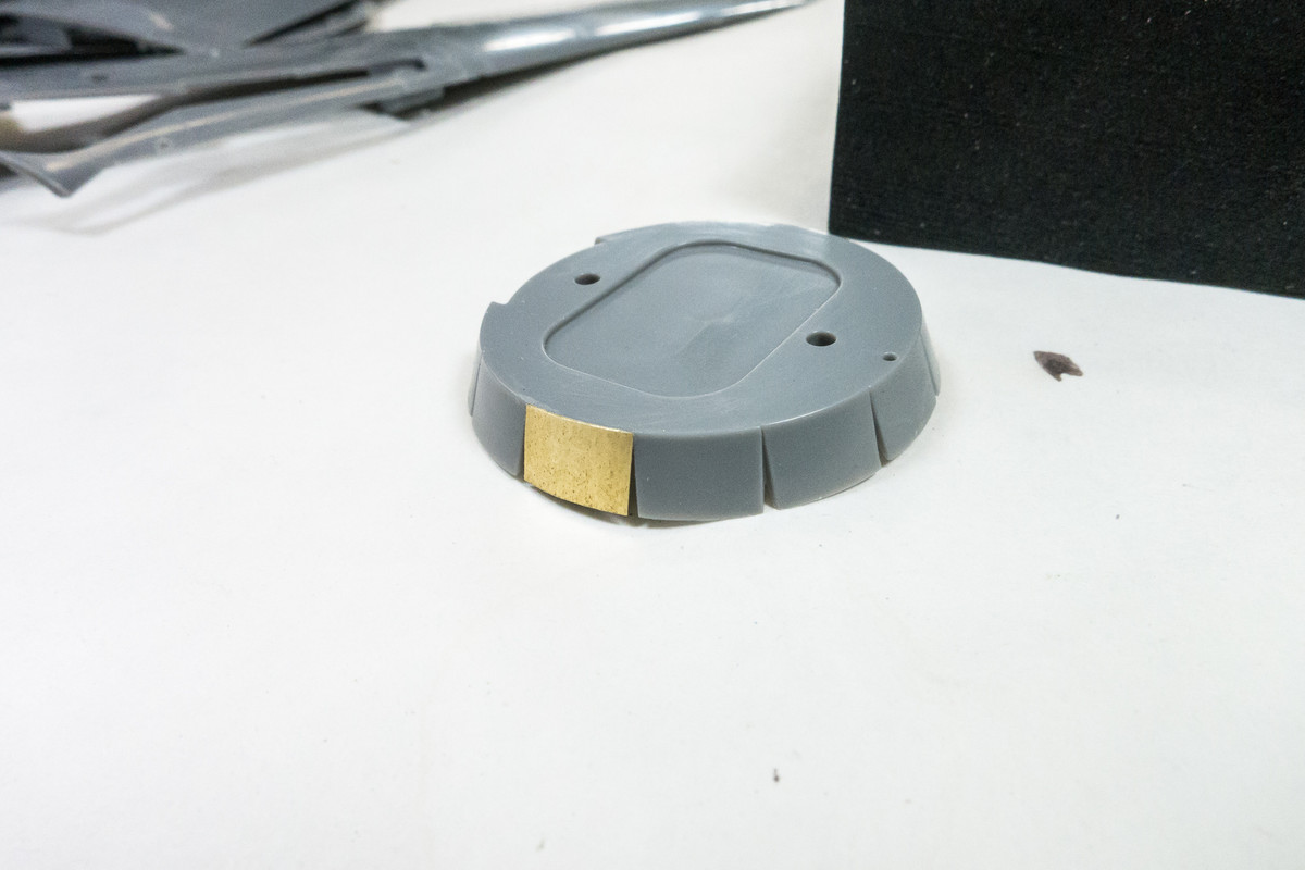

I thinned the edges of the cowling flaps. Again, the D-13 is slightly different than the D-9 in that ALL of the cowling flaps are extendable. On the D-9, there is a fixed cowling flap on the starboard side.
I cut the fixed flap off and replaced it with a piece of brass sheet.
I COULD replace ALL of the flaps with brass sheeting but I elected not to. As long as the trailing edges are thinned, I think the plastic flaps look fine.

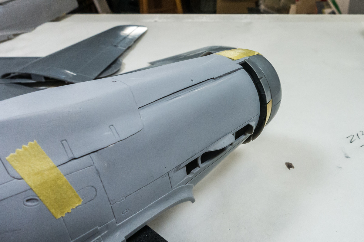

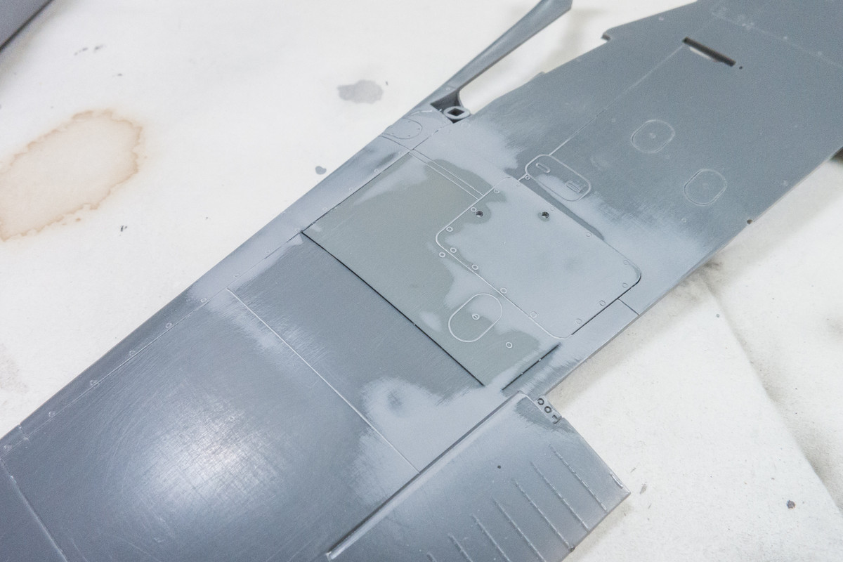

On my past D-9 builds, I erroneously assumed that the outline of the wing insert piece were along panel lines but this is incorrect.
So after I glued the insert pieces into place, I filled the non-panel line joints with black CA glue.
Re: 1/32 Hasegawa Fw 190D-13 Yellow 10
The wing insert panel has been dealt with. Looks a mess now but it should be work out nicely under a coat of paint.

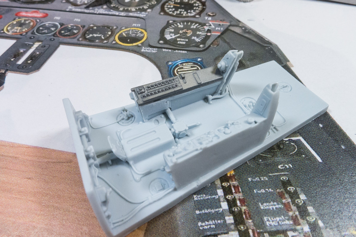

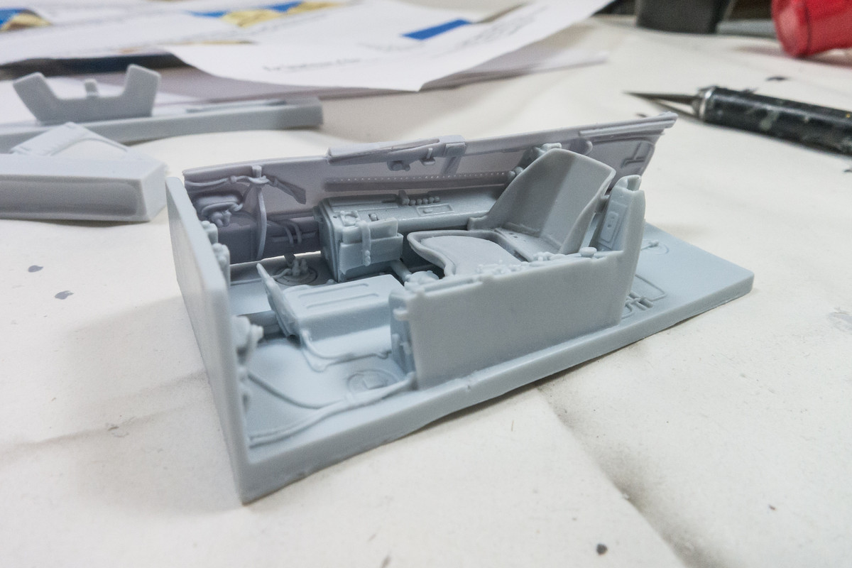

Thanks guys! The grafting of the side console shouldn't affect the overall fit of the cockpit since it will be encased by the sidewalls. After trimming the resin cockpit parts, I cobbled them together using tape. You can see the grafted console nested nicely in the cockpit.
Some surgery needs to be performed to accommodate the Eagle Editions cockpit. The easy part is sawing off the instrument panel hood and replacing it with the resin hood.
A fit check to make sure that all of the components, including the windscreen and canopy, go together without any issues.
Now comes the tedious part. The insides of the fuselage need to be thinned considerably. This work has begun but I'm nowhere near the recommended amount of thinning.
