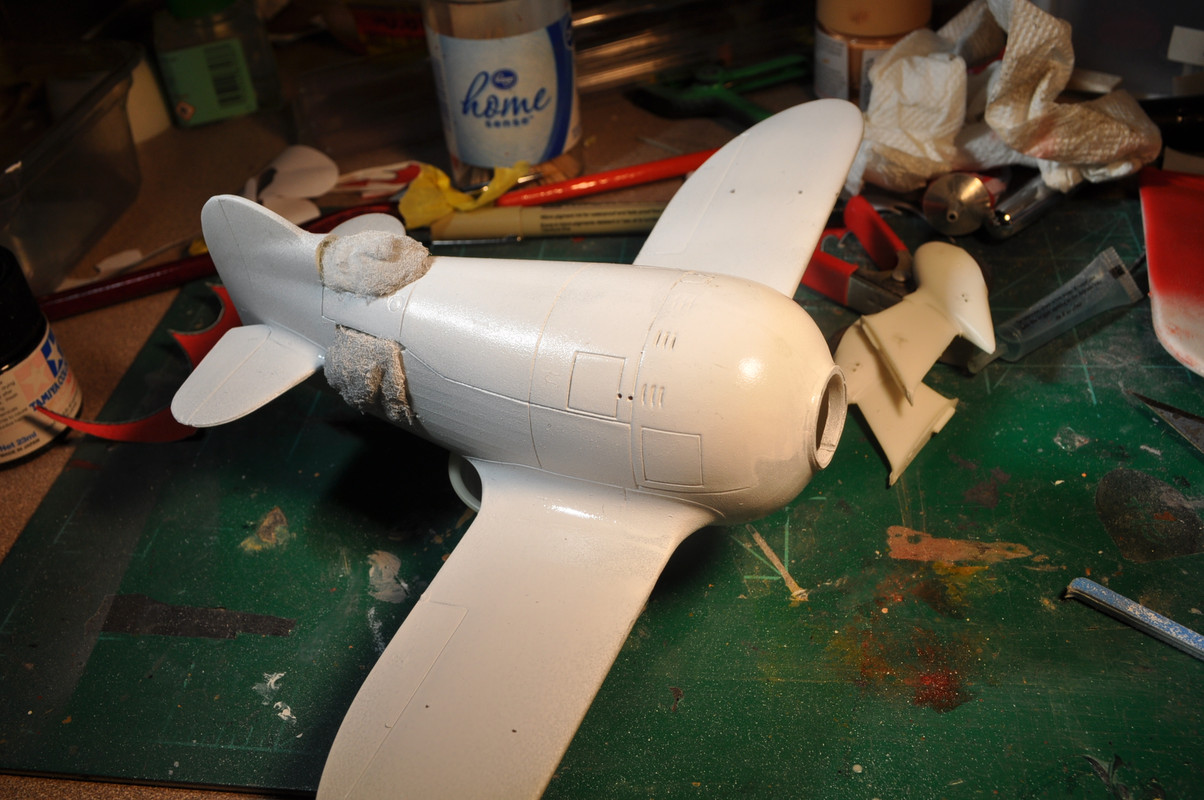

Got some white appliec. Tamiya X-2 Gloss white. is pretty nice stuff. There is some "orange peel", but I'm not sure I want to mess with trying to wet sand it out.
I've decided to make and cut my own masks. The red that my printer dishes out is just enough off to stand out more than I would like...so, here we go. Does anyone have any good ideas on how to mask the black pinstriping?

Well done Lyle! That coat of white is far better than I could do. For some reason my white coats never come out smooth and clean. Even if they do, they get dirty pretty quick afterwards, even when I gloss coat over it for protection.
As for the black line, one idea would be to re-size the one mask you make so that it is about 1/32" bigger, assuming you will be masking the white. After masking the white with the smaller mask, paint black along the edge of the mask. Then add the larger mask so that the black is covered and then shoot the red. Of course, test the masks first to be sure they will line up properly once you cut the real ones. Not sure how you would do the wheel pants though. Best of luck with that my friend.
Re: Gee Bee Part two...Williams Brothers
I think that idea has merit..I will give it a try. Wheel pants will likely be decals...far enough away from the Tamiya red, the difference should not stand out. I hope.
