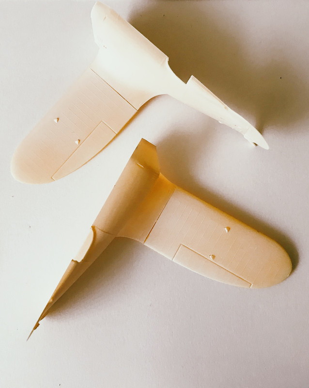

Looking great so far. You are so methodical in your approach. Me? “We don’t need no stinking instructions!” Now, where is the glue?
Thomas_M
Posts: 4244
Post by Thomas_M »
speedgraflex wrote:...
I was spot on with one and “close enough for now” with the other. The gap is from missing pressure fit; a little glue will hold ‘em both true!
I´d go and glue those from the inside: no glue traces or molten plastic on the outside joint.

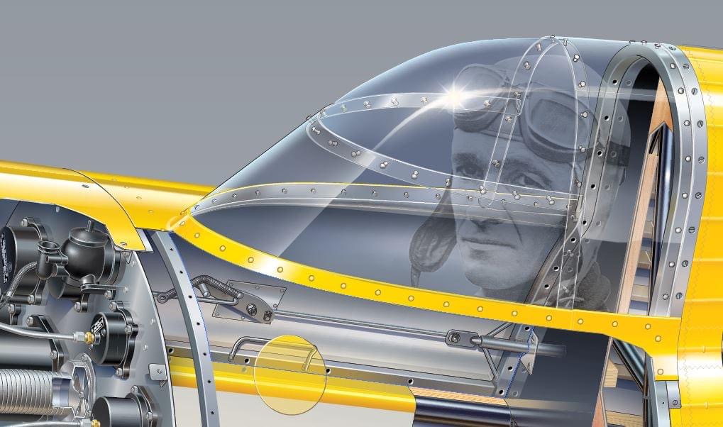

These are two enlargements of a beautiful cutaway illustration by Tom Johnson of the Gee Bee Z.
