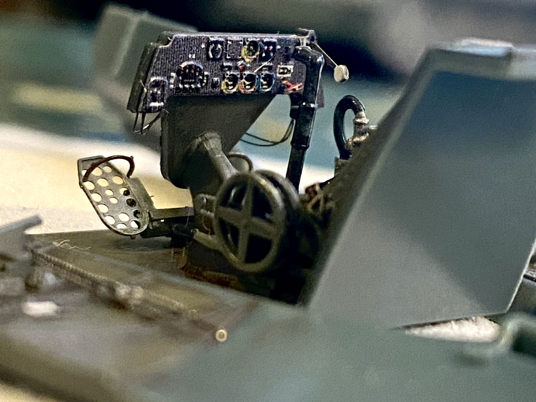

I took some time this morning to wire-up and assemble the lower IP. I also sprayed the redux cockpit with Flat Clear and it seems to have mellowed things out in there nicely.

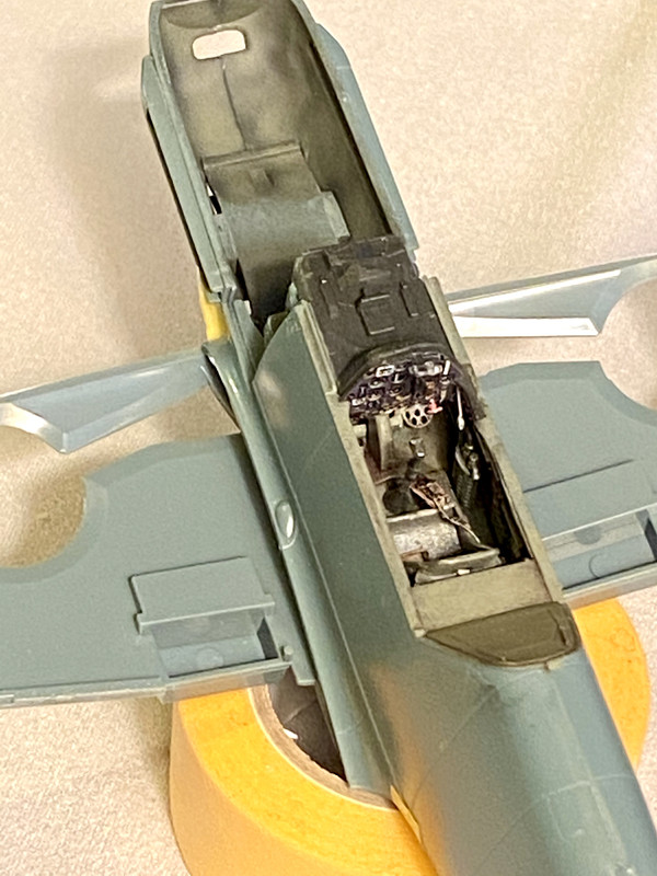

Stuart and Lyle, thank you guys again. I’m really happy to say that the stock cockpit fit in there beautifully. That more than makes up for the missing detail, in my opinion. A poor fit, to me, kind of detracts from all the the work I put into the resin pit.

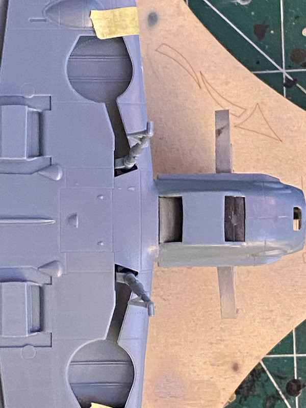

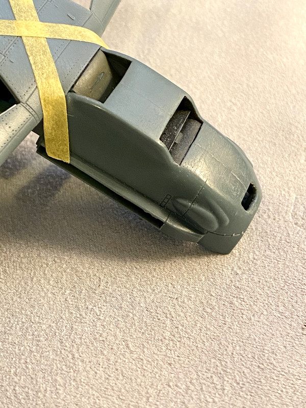

I went ahead and sealed it all up in the fuselage, and attached the lower wing half. I had to do some minor filling and sanding/buffing, but it wasn’t bad at all. Honestly, I’ve always had problems with the lower cowling and air intake on these Eduard Emils, but I took my time, test-fit *everything* multiple times, and even went so far as to change around the order in which I installed everything in order to get the most out of the fit. Totally worth it.

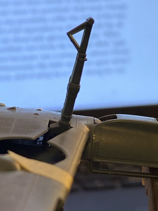

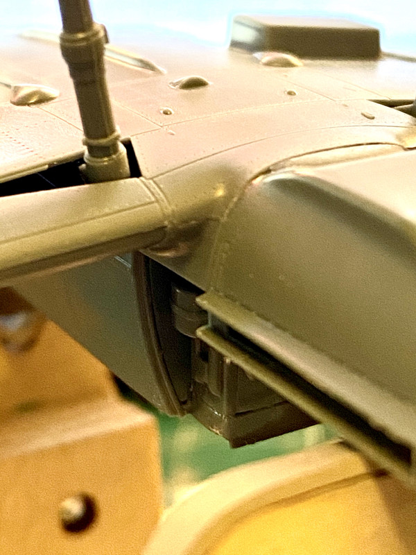

I also went off the reservation with the upper wing halves and the struts. Yes, I went ahead and attached those to the upper wing halves. Why? Good question...
See here, I’ve had terrible luck with these Emils and the landing gear, specifically the stance, when I install the legs at the end of the build. The reason for that is, with this kit in particular, the posts are small and the holes they go into are quite shallow. A modeler can install these legs at practically any angle he chooses. It’s crazy how much play and slop is in there when the legs are dry fit. So I took a calculated risk, ostensibly- I’m risking accidentally breaking them off later or ruining the paint somehow, for the sake of being able to install them and adjust them to my liking easily without risking ruining a model I’ve already almost completed.
I’m very happy with how they’ve turned out, shown in the photos with the upper halves dry-fit and taped in place.
Cockpit entombed:
Post fill and sanding up front:
Lower wing half attached:
Sexy joins:
Gear legs installed in top wing halves which are dry fit to lower wing half:
