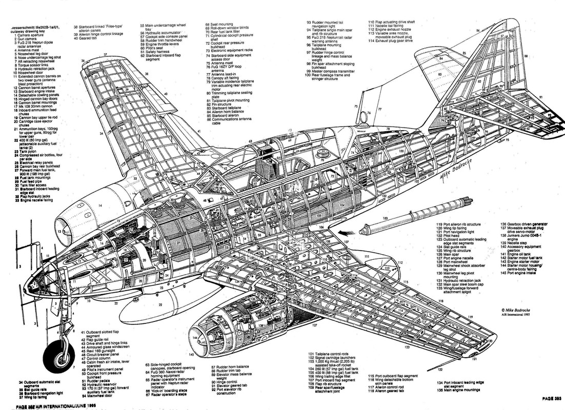

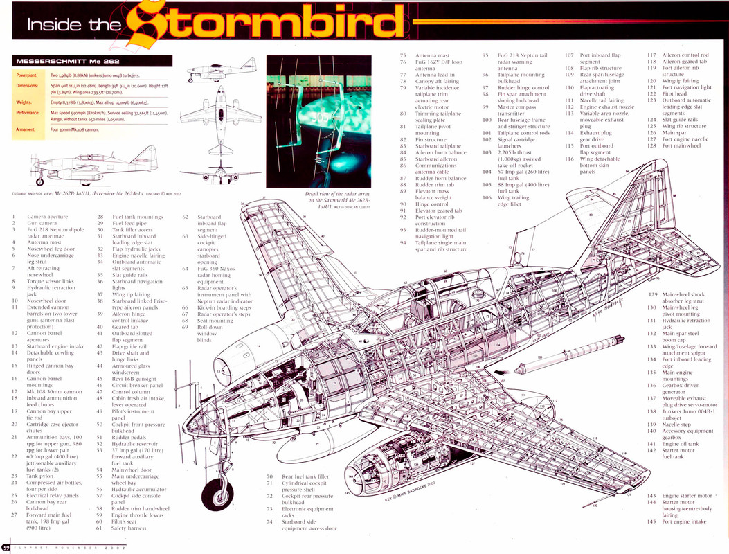

I think whoever designed the model should have used much tighter tolerances - maybe these will be useful. I love cutaway drawings!!
