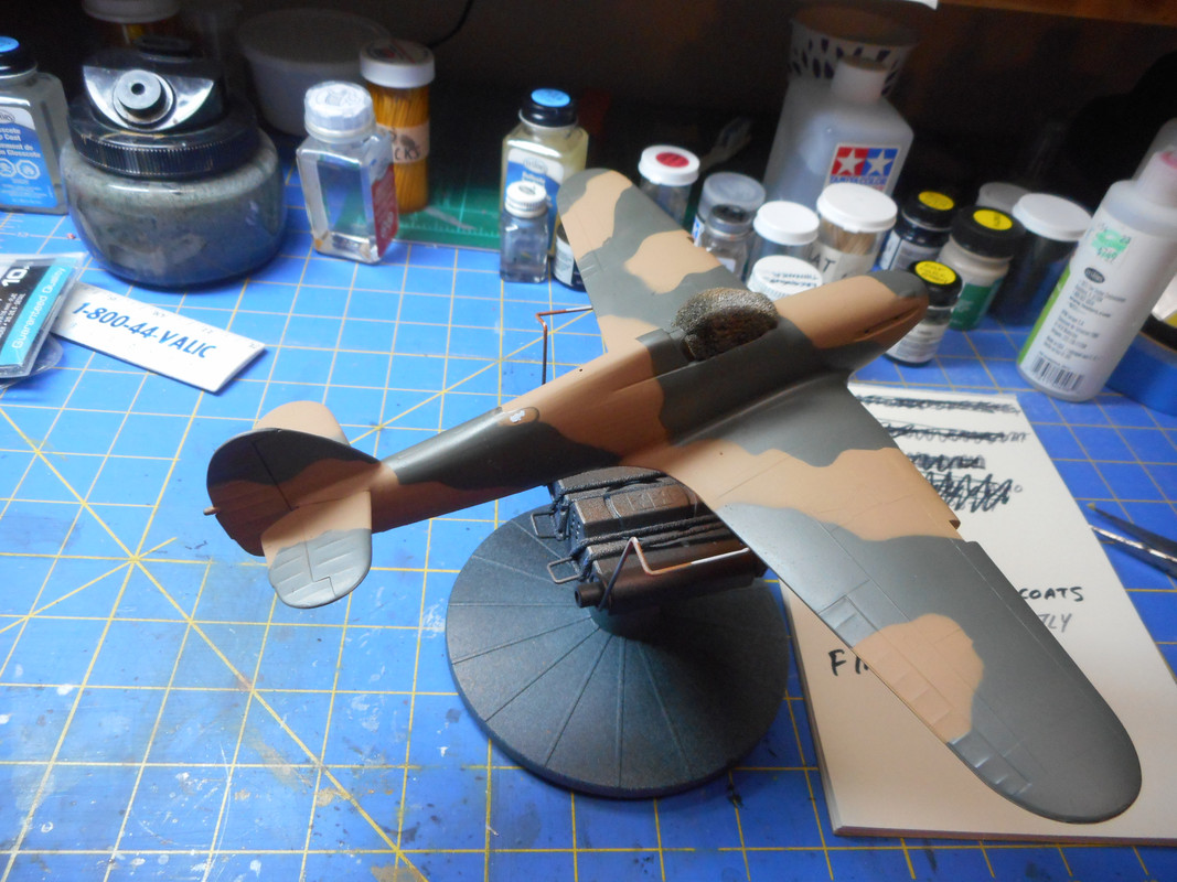

I finally done my first ever camo scheme! Underside is Model Master Sky Type "S" ANA610
This past Friday night, I first used Badger's Earth. Did not like it at all. Too light plus it didn't airbrush nice. Had so much trouble with it even when I tried thinning it enough to be airbrushable. When I first opened the bottle, it was almost like a pasty thick texture. Probably from being sitting for so long in my stash.. I figure maybe I can salvage it by adding Tamiya thinner to make it sprayable. No matter how hard I tried, it worked and sometimes it didn't work. Screw it. I let it dry and sprayed Model Master Dark Tan last night. Much better.
This afternoon, I spent a couple hours cutting paper template I found online. it was 1/32 scale but I somehow got it to match the scale of 1/48. In fact, it is THE exact camo scheme as shown in the instruction guide. I know some of you may tell me I should have used silly putty instead. The reason I went with cutting out paper templates and taping it to the wings and fuselage (with yellow Frog tape) is because I knew it would give me the feathered edges I wanted.

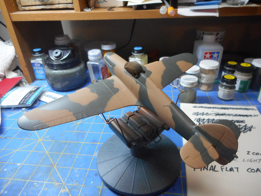

I later sprayed RAF Dark Green for the green camo area. Overall, I'm really happy with how it came out. There are a few minor spots that needs touching up. You can see those spots in the following photos...
Minor green paint bleed. Not a biggie.
Minor paint bleed and tan lifted. Don't know if I nicked it while removing the paper template or the tape pulled it. Easy fix...
Minor tan paint bleed. Easy fix...
And finally. more minor paint bleed on nose area and underside wing root. Easy fix...

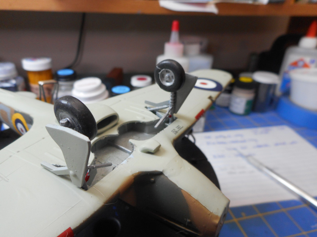

Last night, I got one side landing gear on. WTH?!? One extension part doesn’t reach the floor?!? Pics forthcoming because I had to let it dry overnight to set. :headbang:

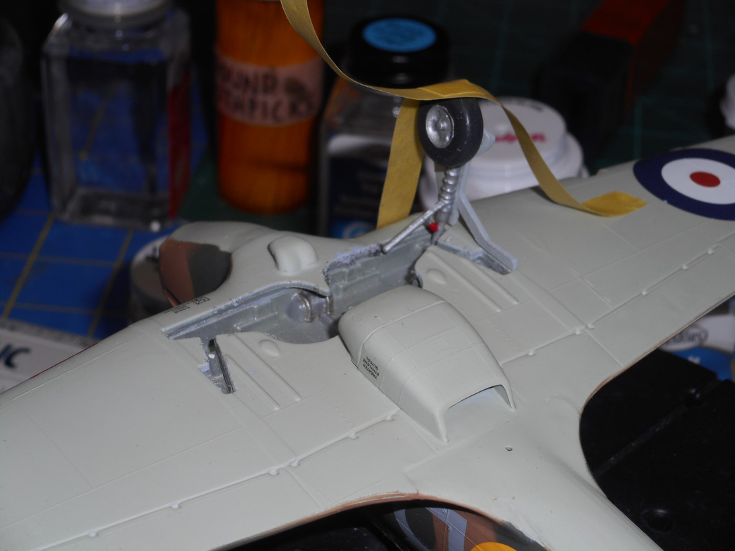

As promised... the pic of landing gear strut in question... :scream: :scream: :scream:
Other landing gear strut installed this morning with side struts installed.
Sorry for the blurry pic. :bag:

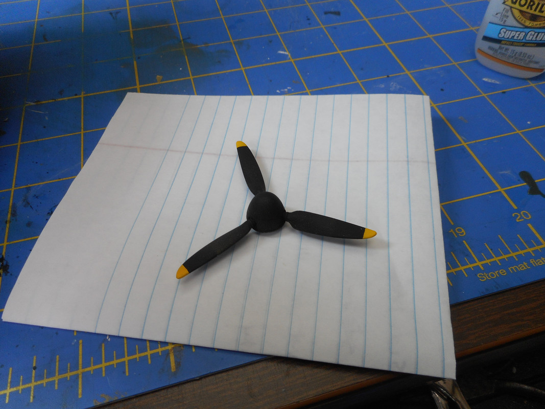

Propeller tips painted yellow over black. Not too bad actually. I'm surprised the yellow didn't give me a hard time covering over black. :lashed:

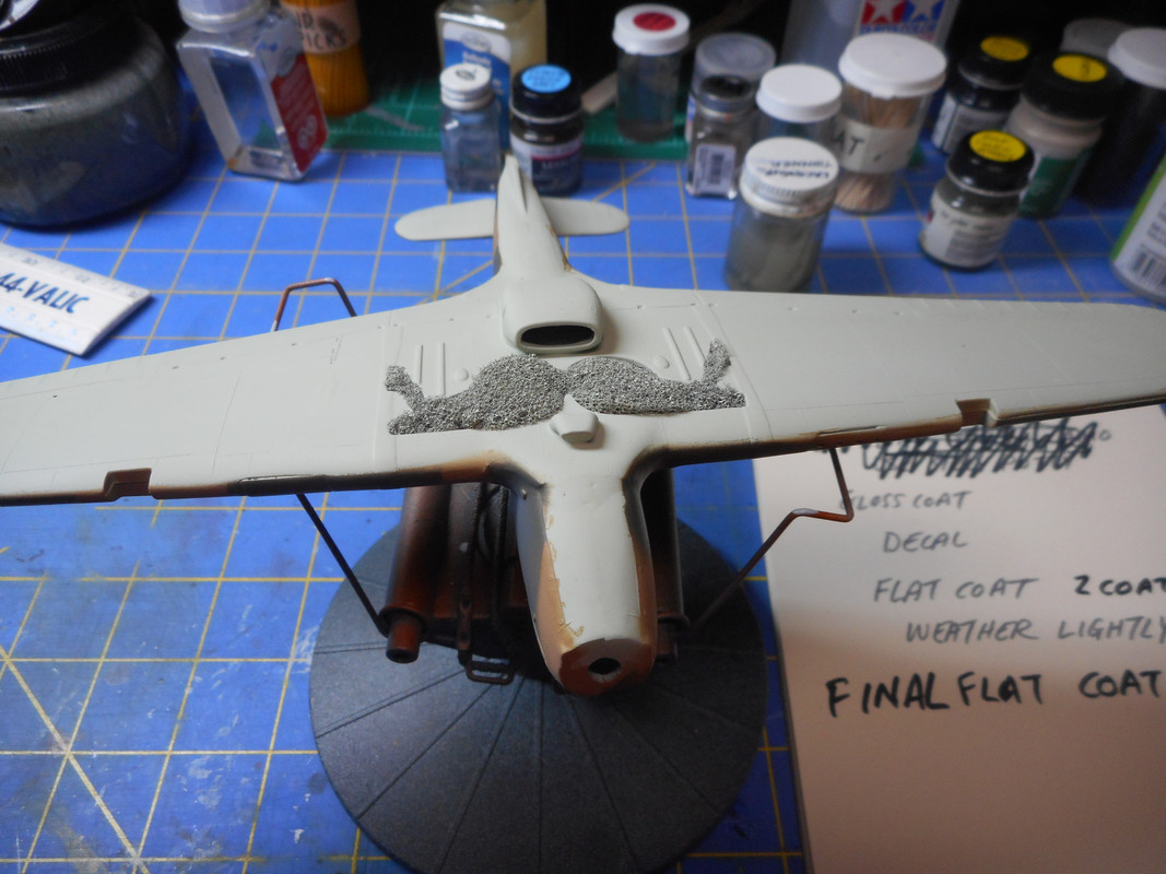

Since the kit detailing was pretty dismal, the landing lights in front of each wing side lacked landing lights. :bored:
What to do... what to do? What would MacGuyver do? So I improvised by making my own using Elmer's White Glue to create proper lights. I made several sizes since I don't know which would fit correctly.
They're currently drying now so in due time, I'll simply scrape them off the template with flat blade and test which ones look better. They will be glued on inside wing slot and use Molotow chrome pen for lens color before placing the clear cover on wings.

Add a small piece of styrene strip in the right size to make up the missing portion of the retraction arm.
Re: 1/48 Hawker Hurricane Mk. I
I used Gorilla Super glue to hold it in place. But... that's something I could do for a better hold. Yeah, CA gel did come to mind but didn't have any on hand.
