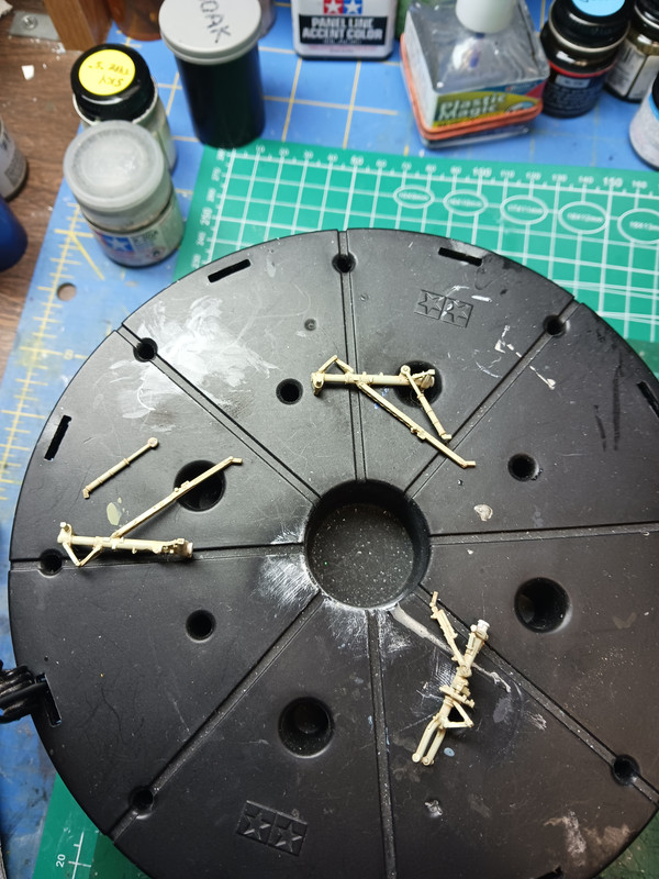

I got nasty this afternoon so a couple nights ago, I shot a coat of Future on the gear doors, wells and struts. Today, I proceeded weathering it with Tamiya Brown Paneliner. After I let dry for a few minutes, I went over it using Artist White Spirits to wash it down. Here's the results and I'm happy with how it came out.

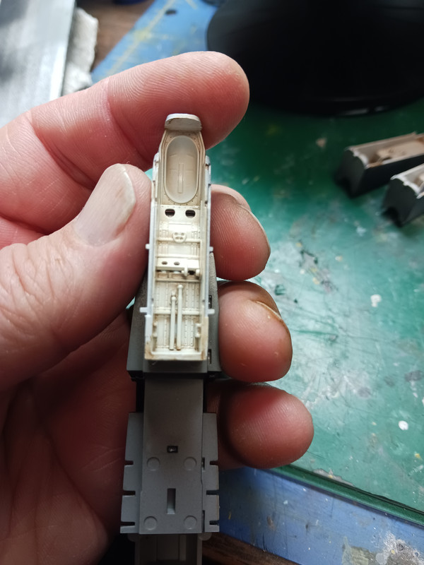

I had canopy fit issues. Kept test fitting and saw why. The bang seats were not sitting completely flushed to the cockpit floor. Out they came, sanded of the excess glue sitting between the seats bottom and not the notches. The notches were grinded out, bang seats glued back in, much better since the canopy is finally sitting pretty in its place.
The bird is about ready for paint of black as my basecoat. There will be a grey with bit of green squiggles on the panels to help out the camo scheme. It won’t be long before she’s ready for decals and legs installed.
