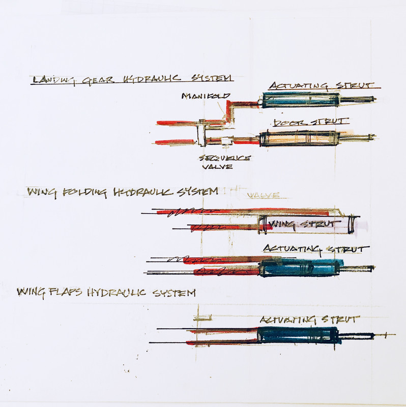

I made this awhile back based directly on the manual—I’m sure there are much better explanations available online, however I took this on from a fellow builder’s perspective as “What would I do to simplify this mess of garden hoses under here?” So I simplified based on three systems (there are four actually and I don’t know why but it was one valve and I eliminated it). Three systems, struts and actuators. The nomenclatures are correct to the early type.

Thanks for the looking in on this build! Especially for that neat drawing of the strut hydraulics, Bruce! Although I'm not going to replicate reality in that particular way, every bit of information helps!
