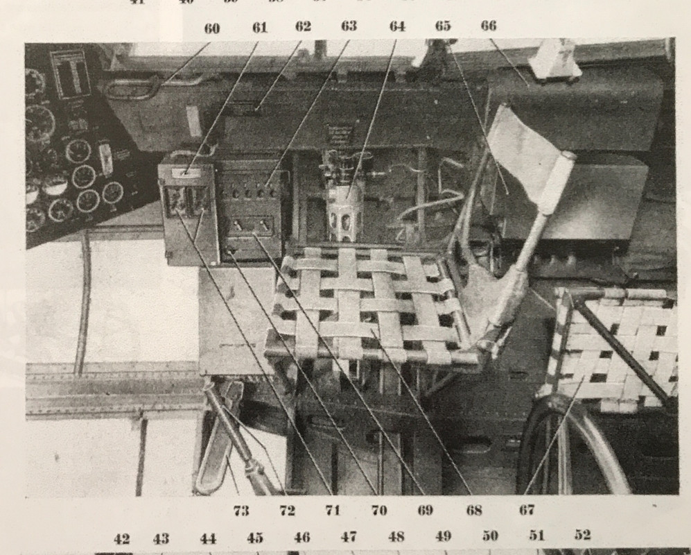

61 and 63 look to be some sort of electrical switch boxes. Possibly for the radio or bomb systems I would guess. The right seat should be for the bombardier when he is not manning the nose gun, bombsight, etc. down in the glazing. 64 looks to be the oxygen bottle for that station.

Thanks so much, Carlos!Stikpusher wrote:61 and 63 look to be some sort of electrical switch boxes. Possibly for the radio or bomb systems I would guess. The right seat should be for the bombardier when he is not manning the nose gun, bombsight, etc. down in the glazing. 64 looks to be the oxygen bottle for that station.

I agree! The observer/gunner chairs look flimsy, and I still have no idea where the observer/gunner rests his feet—except on that beam which is not very much of a foot rest. I am also curious how a crew of five fit within the space.

I would guess four was the normal size of the crew (de facto within the FAF).speedgraflex wrote:I am also curious how a crew of five fit within the space.
If five crew members, my guess would be that the 5th crewmember was the gunner for the bottom gun, and lying there..

Oh those are whatchamacallits and thingajigs. Only one way to find out is pull, turn, lift, yank, flip each one and see what it does.speedgraflex wrote:Thank you so much, Carlos! I feel a need to do a glue “Bake Off,” get some sample kits and glue with different types. I still do things the “ILM Way,” which worked well except when the CA starts cooking off the finish.
Next up: boxes for the starboard wall—observer’s position. I have no idea what these do.
