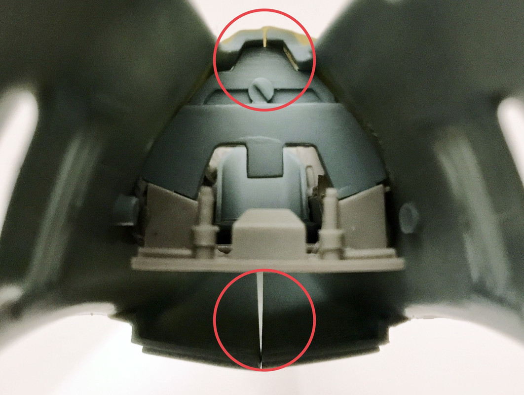

Indeed, Carlos. His work is magnificent! The Dam Busters scenes! Didja see ‘em? Outstanding! Here is the position of cockpit with the view from the engine looking back at the instruments and cockpit floor. The gaps top and bottom are circled. I am glad I removed the pour stub on the bottom.

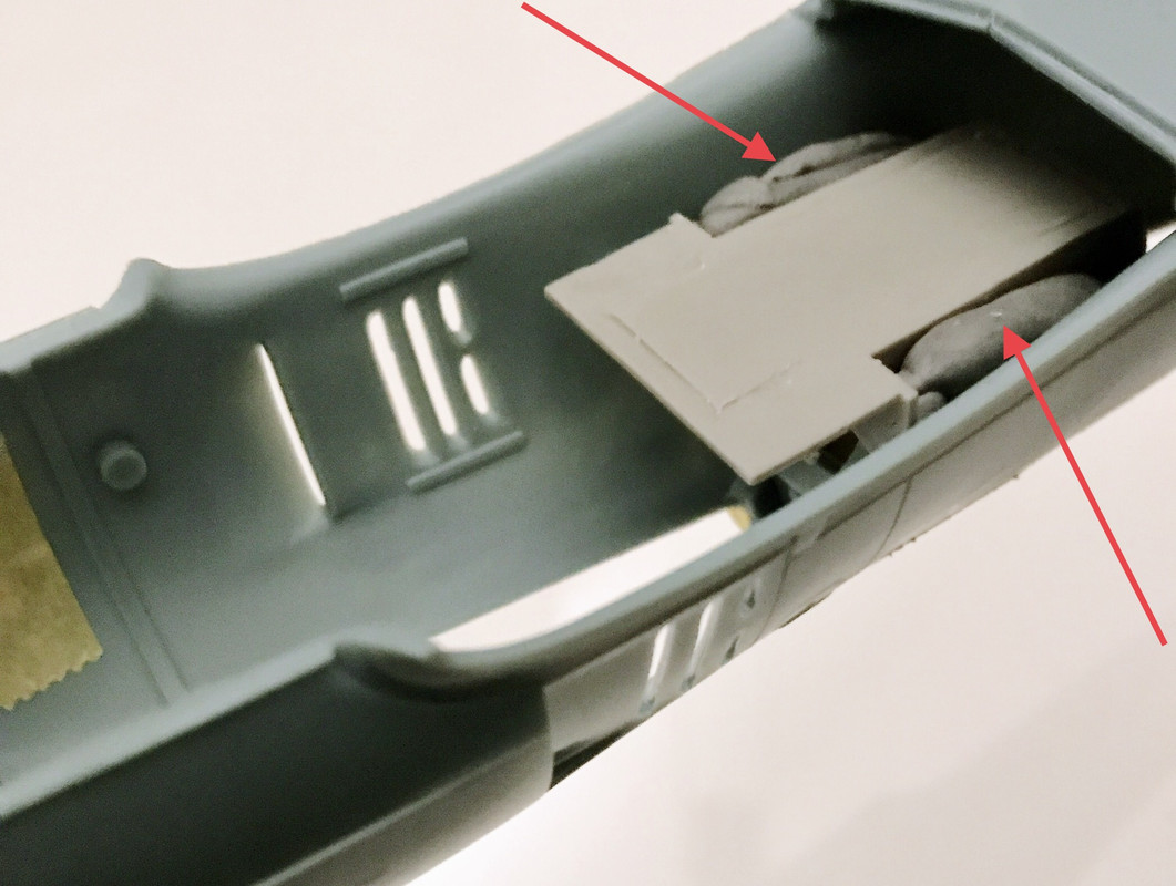

There might be room to add structural supports here on each side of the cockpit walls. I dunno! Any thoughts? What I am using to fill the gaps are rolled up “stogies” of kneaded eraser.

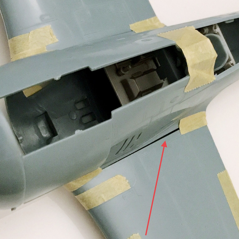

One of the wing seams is pushed out of alignment. I’ll redo this when I test fit the wheel well resin piece tomorrow!
I would wait and see how much room you are going to have with the wheel well and bottom wing in place. But spreading it a bit with a piece of sprue would probably get rid of them gaps.

Good advice, Clint. I know if I put a modest amount of wing “pinch pressure” the gaps will close, so there is still a missing link here - the wheel well.
