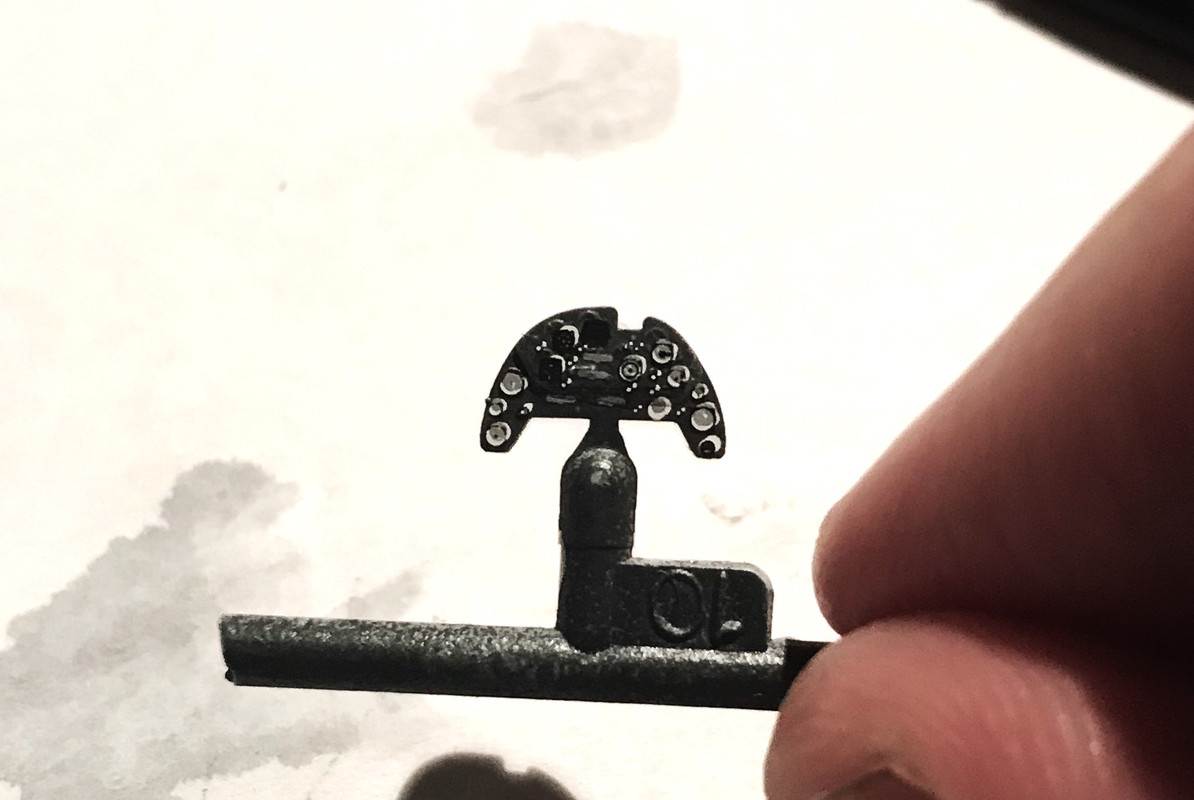

Kit decals... after much Micro Setting and Micro Soling. The design of these is impressionistic; and meant to look like the modeler painted the highlights and the lowlights or the lights and the darks in a loose way. This feels a bit dated to me, but the whole darn point of doing this group build is to simply build and finish. So! Onward. Actually I made the propeller hub much better but this will need to be primed in white first. No photos yet. It's too late for that. All the best.

Looks like the kit decal is off register. But in this scale it will be hard to tell once the cockpit is closed up. Keep pushing forward Bruce!

Yes, build and finish. Stay focused on the mission. The IP decal looks good enough. I bet that thing is about the size of a small fingernail or less. Once it’s mounted and closed up in the fuselage, any imperfections will be hard to spot.

So you are going to light the fuse and try to finish the build before the dynamite blows? I guess that's one way of forcing completion so I'm interested to see how this goes. The cockpit looks fine. Depending the clarity of the clear parts, you may not even be able to make out the instrument panel, let alone discern any details. Have you determined your subject? Is it the "265" aircraft? I can reference the JaPo 109K book for details.

Cockpit build and paint. Yes. On schedule for completion when the Revi gunsight and seat belts are added. I checked fit and everything will seal up inside as intended by Heller.
