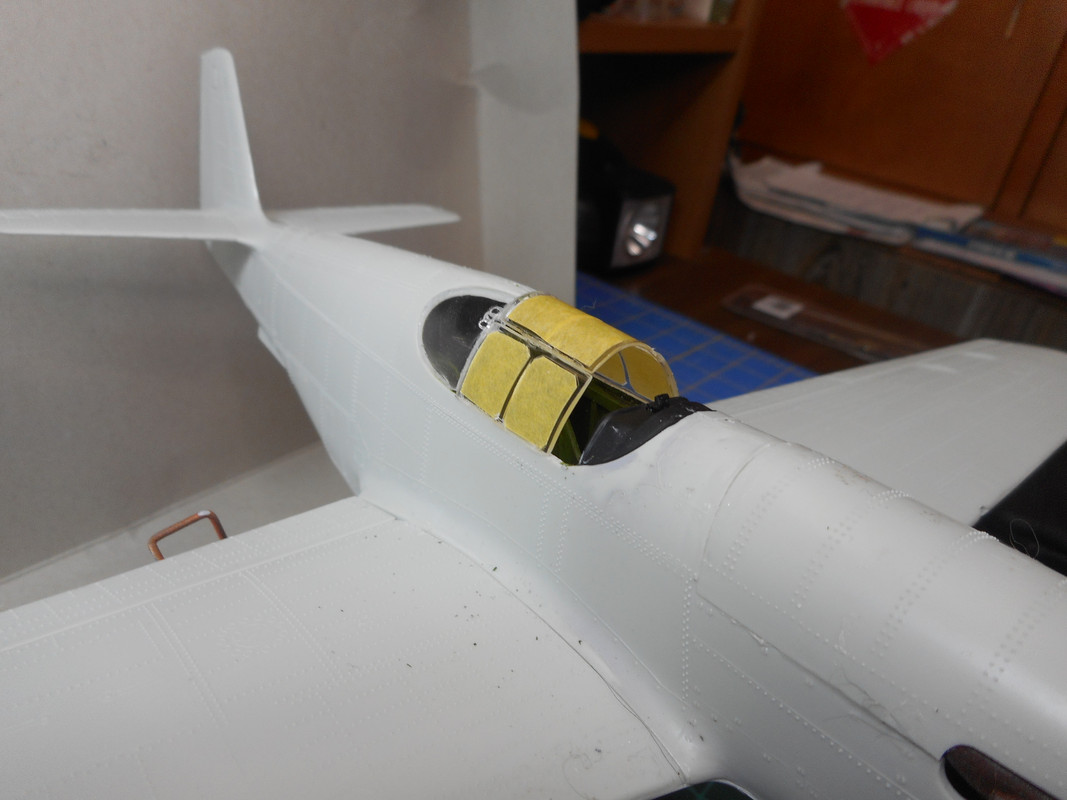

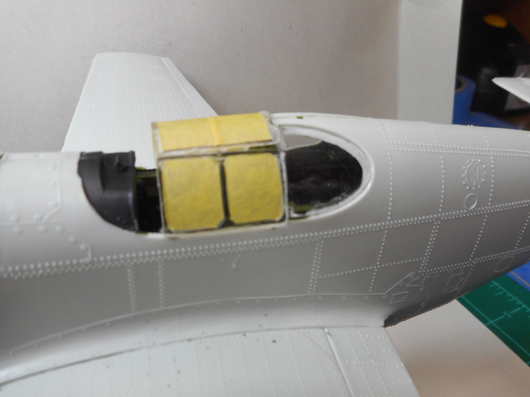

Wanted to close it up. If I wanted to pose the canopy open, it’ll still have fit issues. Nothing was straight no matter what angle I hold it to get a decent fit.Stikpusher wrote:Are you planning to pose the canopy open or closed?

Well the original canopy is a bit tricky in real life, much like the P-38. Since you’re gonna model it closed you can break it down into stages. First glue the rear scallops into place by themselves. Glue the side panes to the windscreen for proper positioning of alignment and angle. Once those are dried firmly in place, add the top panel.BlackSheep214 wrote:Wanted to close it up. If I wanted to pose the canopy open, it’ll still have fit issues. Nothing was straight no matter what angle I hold it to get a decent fit.Stikpusher wrote:Are you planning to pose the canopy open or closed?

I haven't used glue yet. I was test fitting canopy parts. The rear scallops fit just fine when I taped them temporarily. When I went to see how they're going to fit, thats when i noticed the gaps between the scallop side and the side canopy part.
I dare not use Gorilla super glue because it will frost them. I tried Tenax but it dried too fast to place the piece in to set. I do have Plastic Magic 10 second liquid cement (Deluxe Materials), and I have canopy glue.
I'm trying to refrain from using Testors tube glue.

I might suggest something like clear 5 minute epoxy. That will give a super strong hold, won’t fog, dries clear, and gives a few minutes of wiggle time to insure alignment before the part sets.

A new day, fresh eyes, and relaxed mind I was able to soldier on with the canopy. Scalloped windshields, sides and top glued on and left to dry for 24 hours before proceeding with the front windshield. So far, so good...
I opt to use Testors tube glue instead.

Looks like you’ve got a handle on this.

That is awesome! I do hope this doesn't frost later....
