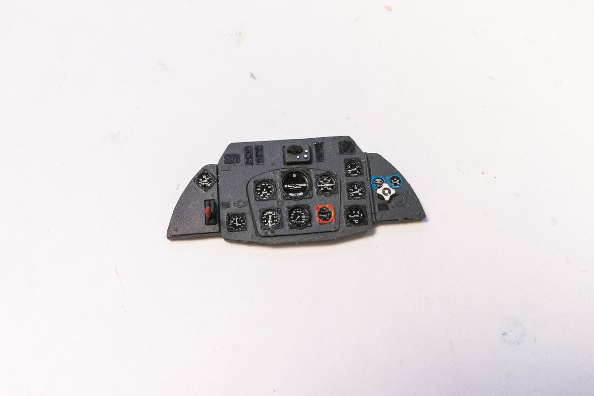

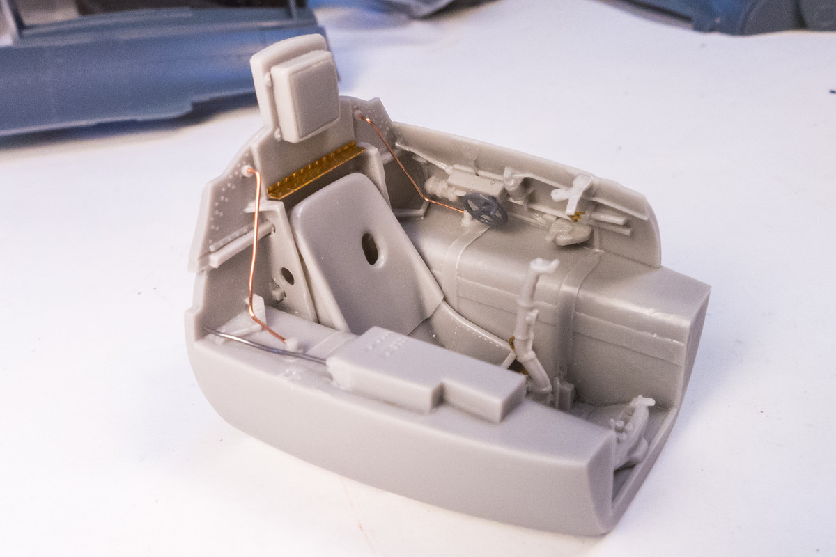

Continuing with work in the cockpit... the instrument panel has been permanently assembled and a few photoetch details have been added. The yellow gauge has been changed to red, as pointed out by Roger of the VintageEagle.com website. Before I call the instrument panel done, I will perform some light weathering on it, mostly dry-brushing with a lighter color.

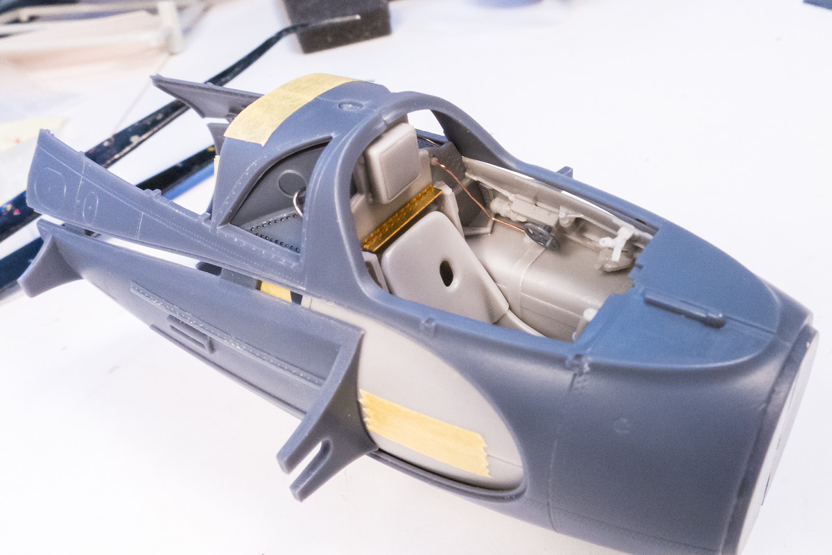

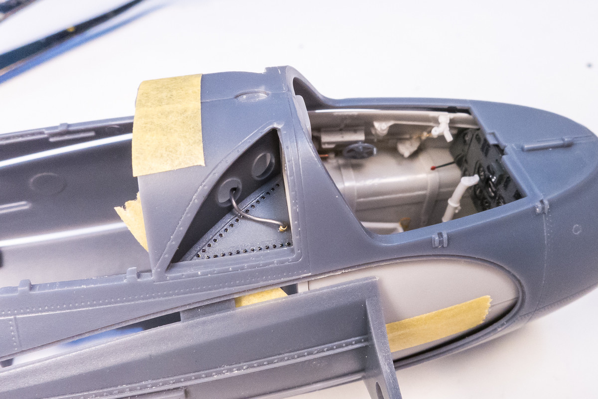

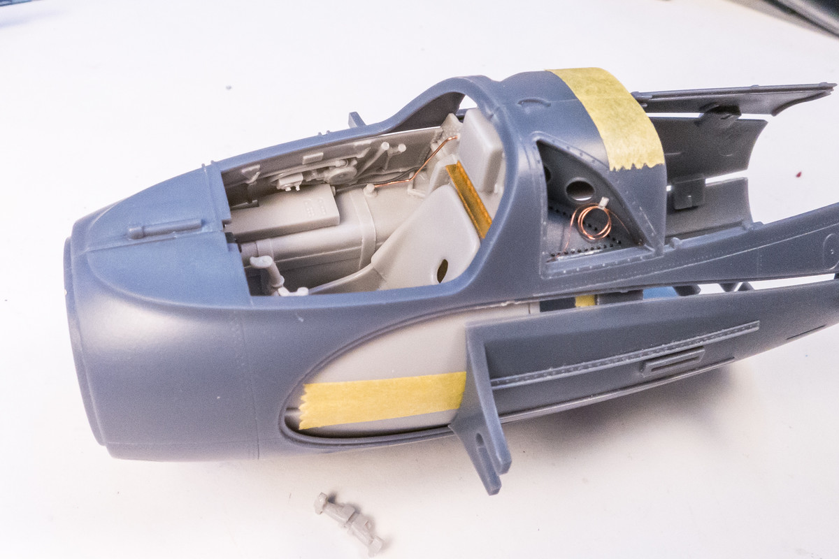

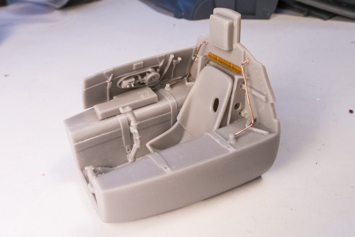

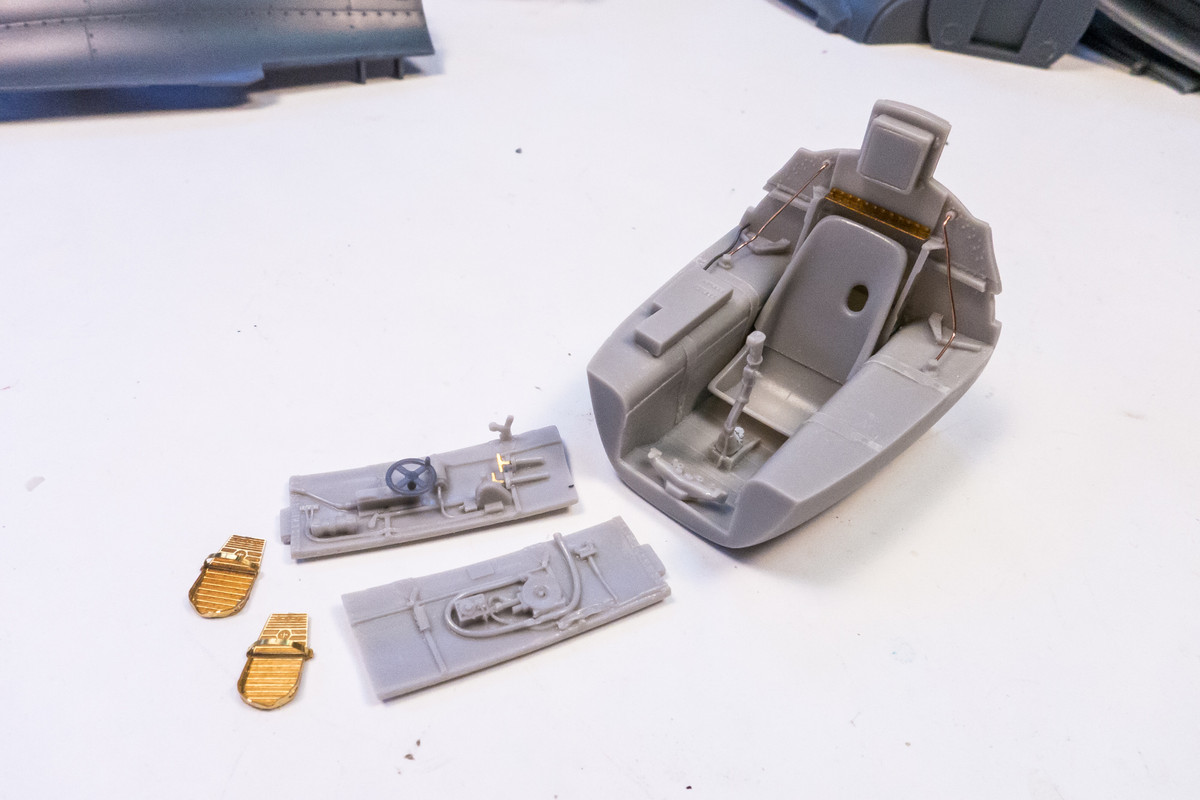

Most of the cockpit sub-areas have been assembled and ready for paint. I shaved the sides of the cockpit tub down to make it fit within the fuselage halves, which was pretty simple work. In addition to the small resin and photoetch parts, I've added some additional wiring.

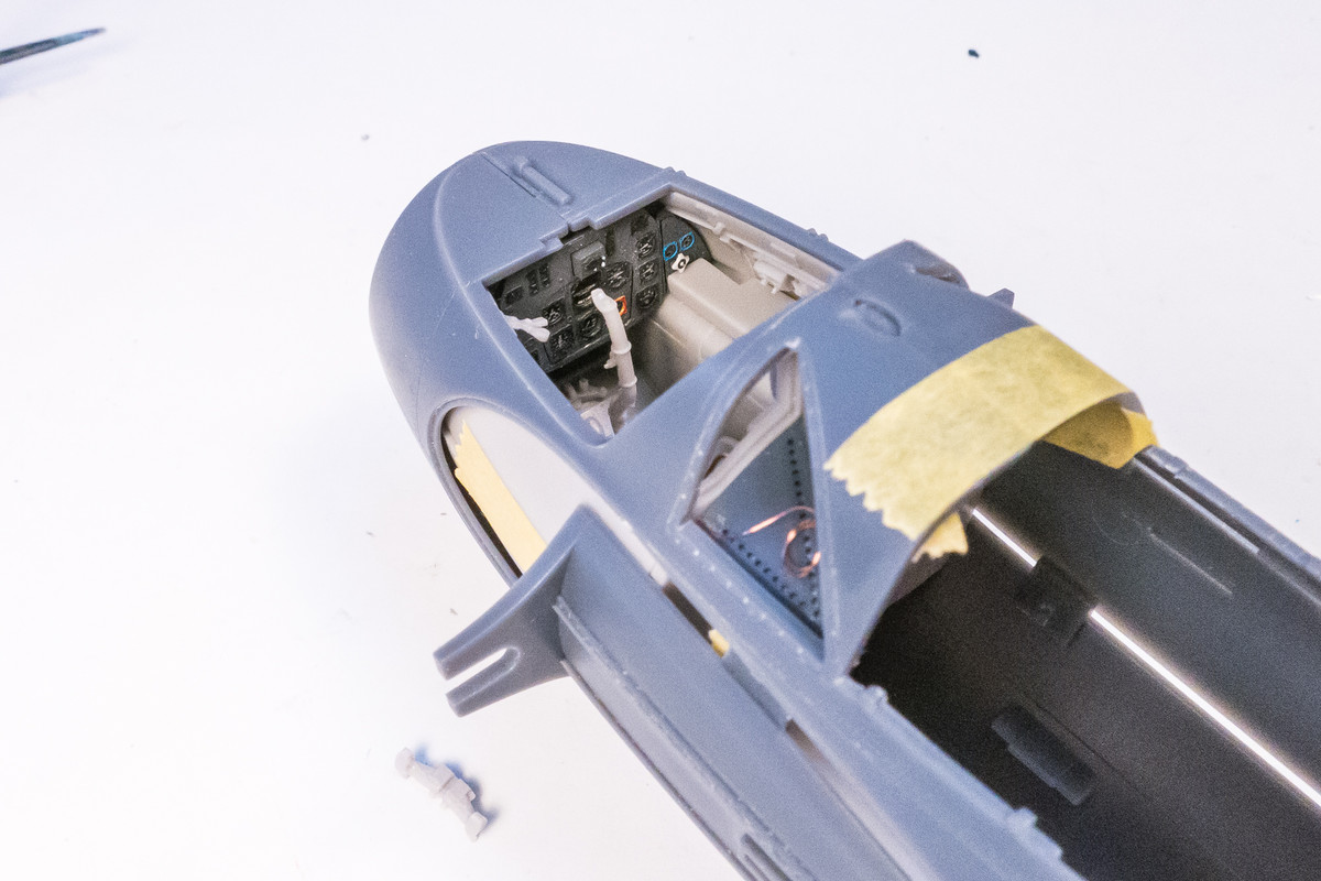

Here's a quick check of the resin cockpit fitted into the fuselage, including the already painted instrument panel. I've added Archer's rivets and some wiring to the decking behind the rear quarter windows.
Painting of the cockpits will be coming soon but I still have to do the seatbelts. I think I'm going to try and fashion my own harnesses using the buckle hardware from the Aires cockpit set and foil.

Ok i have to ask.
How did you get the details so crisp on your IP?
I tried painting the red bit, i tried my finest brush with thinned down miniature paints, gave up, tried a tooth pick, still couldnt get it right.
Whats the secret?

I even use a 20/0 detail brush and have problems with that. What's your secret, John?

Hmmm... outside of just doing it, I haven't really thought about technique. I think preparing the paint is important. I use Tamiya acrylics and they are not the best when it comes to brush painting. Also, there is a lot of variability within the Tamiya paint line as well... some colors just brush better than others. Acrylics dry fast and this can lead to the paint lumping up as it is brushed on. Using the paint bottle lid as a palette, I always mix in a drop or two of 91% iso alcohol as a thinner/retardant to the paint I'm brushing.
Proper magnification is also essential to good detail painting. Almost all of my modeling work is done under magnification. In addition to the reading glasses that I have to wear because of farsightedness, I always have these visor-style magnifiers on...
Having a good paint brush is important too. I use both cheapo sable brushes as well as Windsor Newton Series 7. I usually grab the cheapo one first. There are times when the cheapo brush will dry out as I move from paint lid to painting surface. In those cases, I will switch to a WN Series 7 (#00 or #000)... they have a very fine tip AND can hold a large quantity of paint within their bristles.
I would describe the actual act of painting these small flat details as "pushing" or guiding the paint to the edges. Wiring runs are trickier since you have to run the paint of the brush along the length of wire. But with the small flat details that are found on an instrument panel, I try to take advantage of any physical edge and use the paint brush tip to push the paint to the edges. Tamiya Red is one of those colors that is poor in coverage so you have to do this several times to build an opaque coat.
Finally... even my best effort will result in at least a few errant strokes. Any spots of paint that spill over the physical edges are carefully touched up afterwards. Utilizing good digital photography is an excellent way to improve your technique. The weathering process, especially the dark pastel wash, is another great way of cleaning up shaky detail painting transitions.
