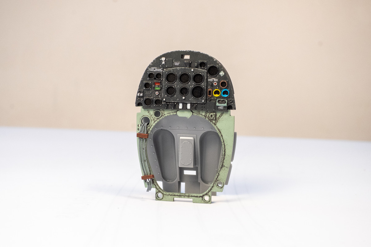

Also included is this new 3D-printed instrument panel. I was most curious about this so I decided to take a closer look.
As you may recall, I have two previous version of the panel already. One is the kit panel, slightly modified with the addition of Airscale instrument bezels to give more 3D relief to the panel. The other is the Quinta panel, which is incredibly detailed but I don't like the "pillowed" look around the edges of the parts.
The LFD panel, which is comprised of three big parts and a couple of small levers, looks very promising and may be superior to the previous two if I can paint it adequately.
Here is the panel mounted onto the front cockpit bulkhead. Mathieu thoughtfully included the wiring loom on the left side.
But I chose to work up a scratch-built alternative using bits of styrene and copper wire.

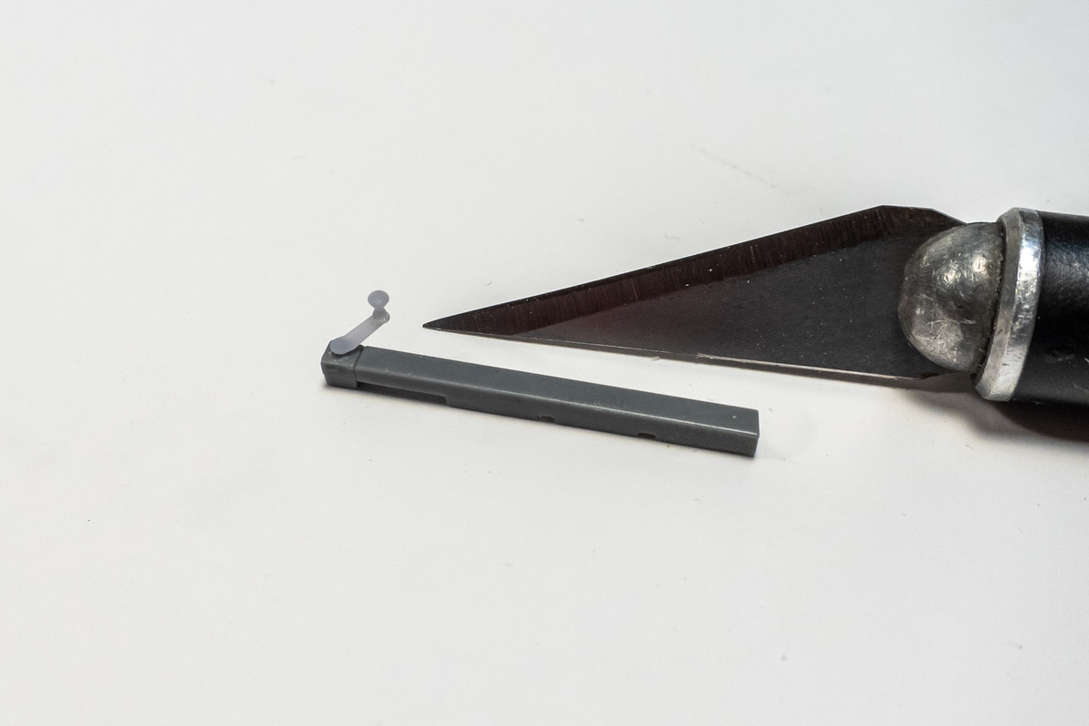

The bubble top XIVe has a canopy crank on the starboard sidewall that needs to be utilized, which forgot to include in the last mock-up of the starboard interior. LFD has a crank replacement in its cockpit set so the kit crank is trimmed off and replaced with the new one.

jkim wrote: Sat May 25, 2024 9:17 pm
Astonishing details or then that Xacto blade is in scale 5:1 !
Great that the build continues John !

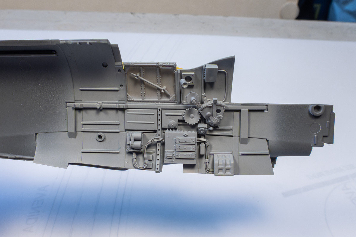

Thanks Kari! Yes, the details from the Laminar Flow Design sets are impressive and some parts are pushing the edge of what is practical, I think. It's almost necessary to have two full copies of the Cockpit Set because of the unavoidable loss and breakage of small parts. Luckily for me, Mathieu DID include a second set with mine, labelled as a free sample copy. I've dipped into that reserve liberally.
Plodding forward with the cockpit details, trying to juggle how the LFD, Barracuda and Tamiya parts fit together. The starboard sidewall is an example of that hodgepodge. I've used the Barracuda sidewall, gyro gunsight dimmer and junction box (yellow resin) and the LFD landing gear quadrant, cylinder priming pump, canopy crank handle and waffle foot plates. The kit parts for the emergency landing gear lever and Morse Code key are still used. And I've added wiring via lead wire.
Similar work on the port side of the cockpit except I've elected to use copper for the wiring for some random reason. The LFD throttle quadrant, electric control box and waffle foot guards are mixed with the kit trim wheel, radio, carb intake lever and relocated voltage regulator.

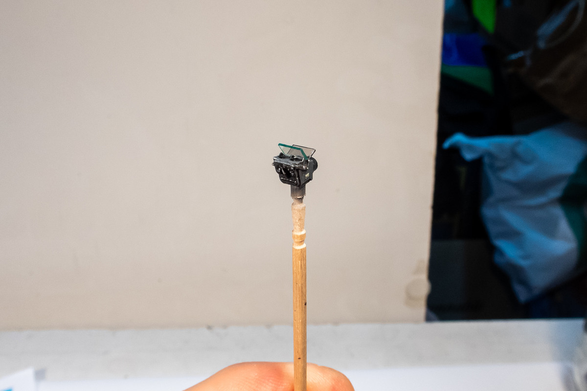

I wasn't happy with the previous version of the gunsight so I took my spare Type II Gyro Gunsight from the Tempest V and painted it up. I've elected not to mount a sun shade on it.

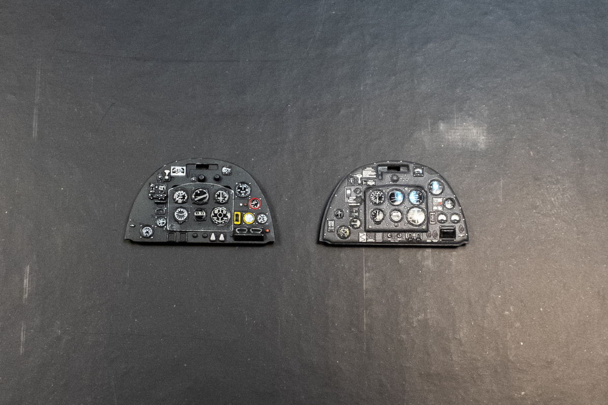

Well done aftermarket parts made of brass and resin look so impressive under a coat of primer that I feel hesitant about moving on to the actual painting. But I've forced myself to get on with it and have started to paint the cockpit parts. I'm taking this very slow and deliberately, trying to give each component a decent paint job. First up is the Barracuda 3D-printed control stick...
The real time-killer has been the instrument panel. I've kept the front and backing part separate for now because I think applying the instrument dial decals to the backing will be easier without the front fascia in the way. The top is the 3D-printed panel from Laminar Flow Designs. In the middle is the kit instrument panel and the bottom is the Quinta Studios version.
Here's the painted LFD IP face mounted on the backing but without the instrument dials. The small data stenciling is from one of the Barracuda Spitfire cockpit upgrade sets. Hopefully, I have enough IP dial decals to populate this panel as I'm waiting for a re-supply of Airscale products from Peter Castle.
