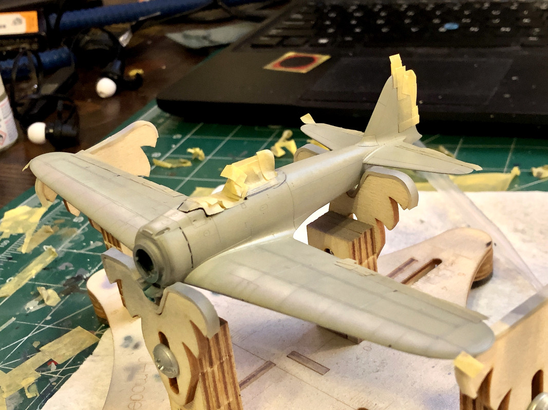

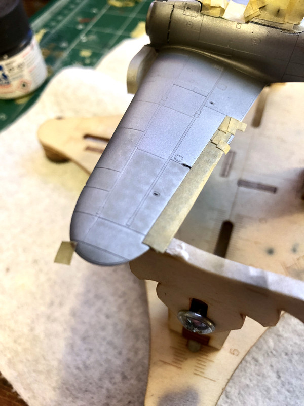

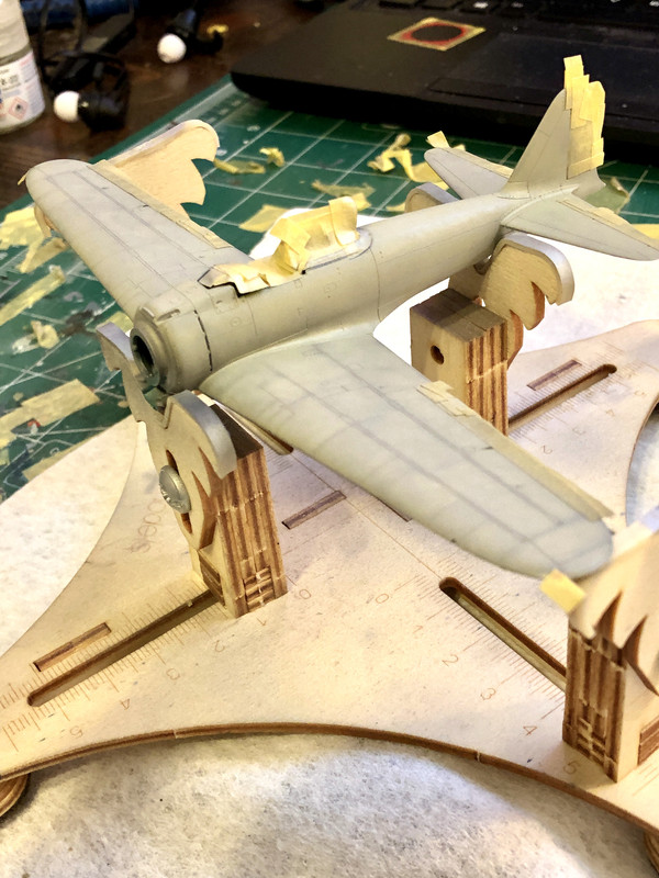

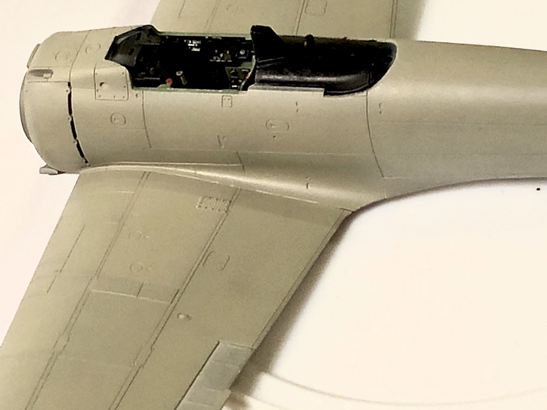

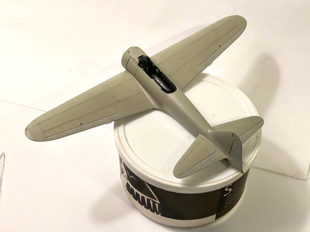

1. I sprayed the little Zero with a lovely coat of AS-12, and polished it smooth with my microfiber pads. After that I painted the control surfaces, let them dry, and then masked them. According to the research I’ve been doing, the metal parts on the control surfaces weren’t painted gray, they were Ameiro as well, so I masked accordingly.

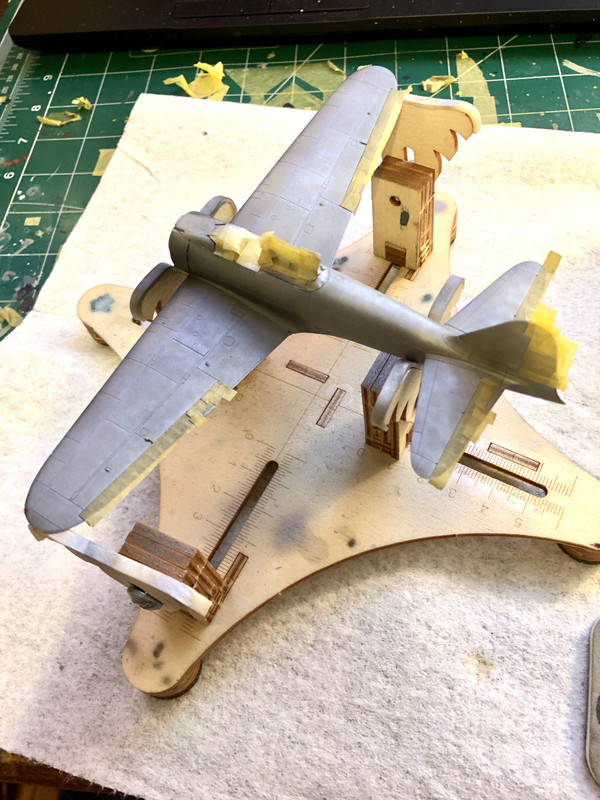

2. I over-sprayed the airframe with a heavily thinned mix of NATO Black and German Gray. Just a filter coat, which allowed for the AS-12 to get darker depending on the angle of illumination. Just accentuating it’s natural tendency to be dark here and there and bright silver in other places. Once it had dried, I polished it smooth. Here’s the results from that:

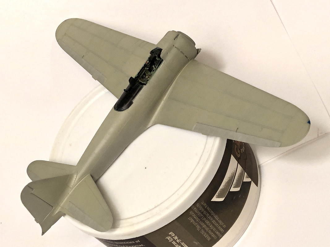

3. Next came the mottling. This is unadulterated Kustom Ameiro, thinned just shy of paint running all over the place. I mottled the paint on, section by section:

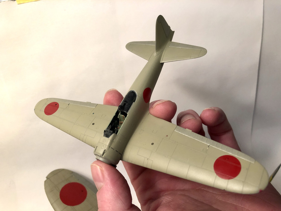

4. Once I had the whole thing mottled with the base color, I began mottling in a lightened shade of the base color- 3:1 Kustom Ameiro to XF-76:
5. Next, I lightened the Kustom Ameiro 2:1 with XF-76. I did this for that ephemeral “scale effect”:

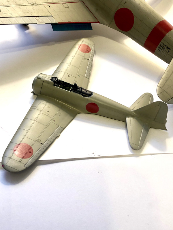

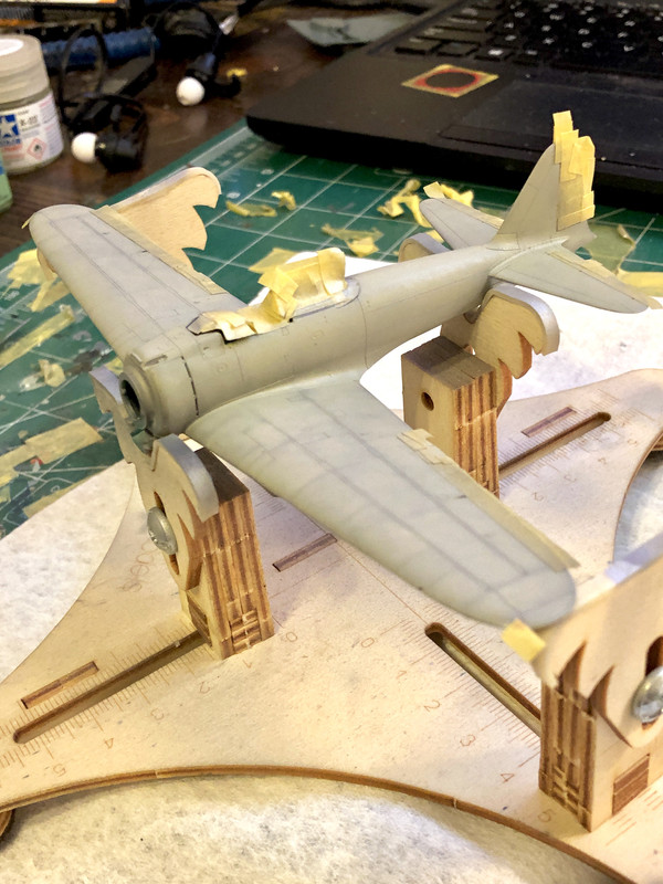

6. Once I’d laid all that down, I started on the blending coats with thinned, unadulterated Kustom Ameiro. I ended up doing 5 in all. Here are the progressive results:
Here are some shots after drying and setting up:
Some tonal variation and modulation did indeed pull through despite the absence of a plain black base:
And the subtlety is right where I like it for this particular aircraft:
And, under harsh illumination at a distance, the color looks smooth, shiny, homogeneous, and has that nice caramel color I want:
And the color/hue shifts as well, just as it ought to:
I am inclined to be happy with these results for this particular aircraft. I like how that Ameiro looks over silver. It pops. Now, whether or not what depth remains gets lots under a glass coat? I have no idea. I still have to do the bottom and paint the insignias. But I am happy with it, and feel good about the results!
