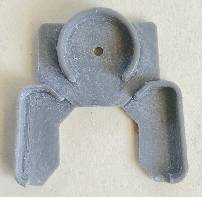

So more little progress today...

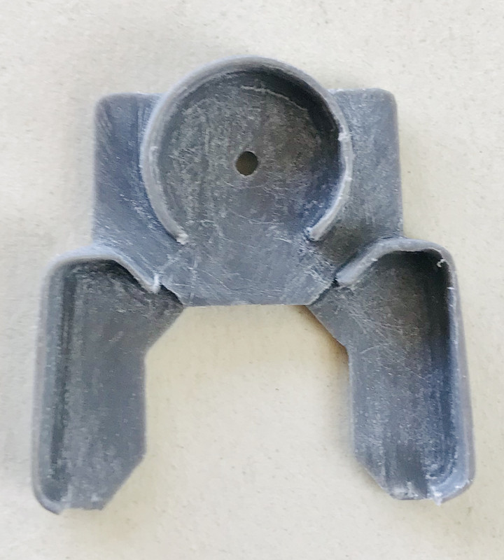

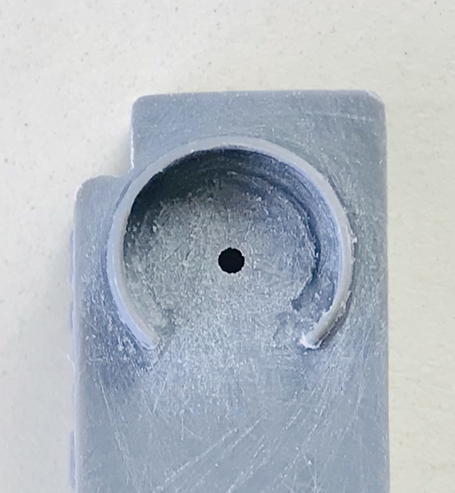

First up, I thinned out the splinter shields for the forward 40mm tub and 20mm gun galleries
Then I glued that deck in place

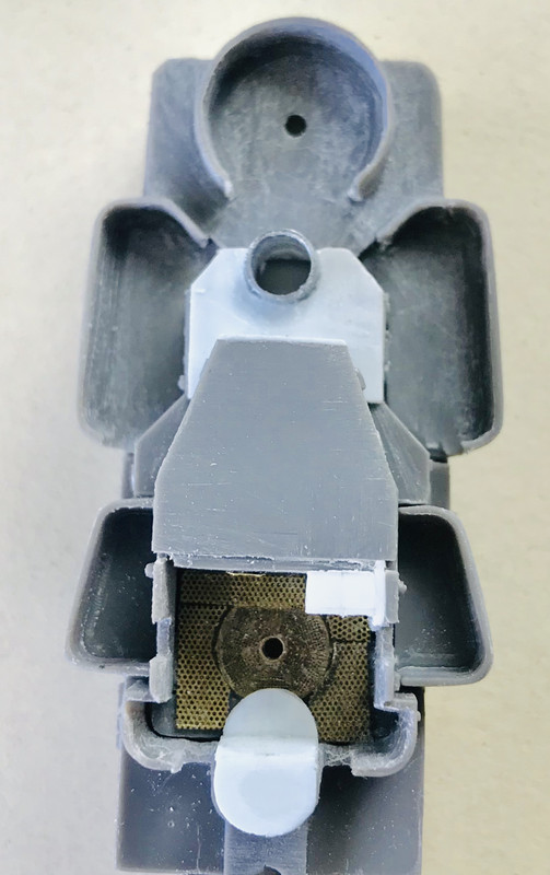

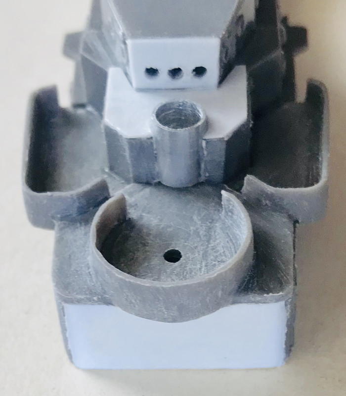

And I added some sheet styrene to the lower front of the superstructure to deal with seams in that area
next I added the signal wings for the flying bridge
and then I thinned down the splinter shields for the aft 40mm tub and the midship lower 20mm tubs
so here is how it all looks now

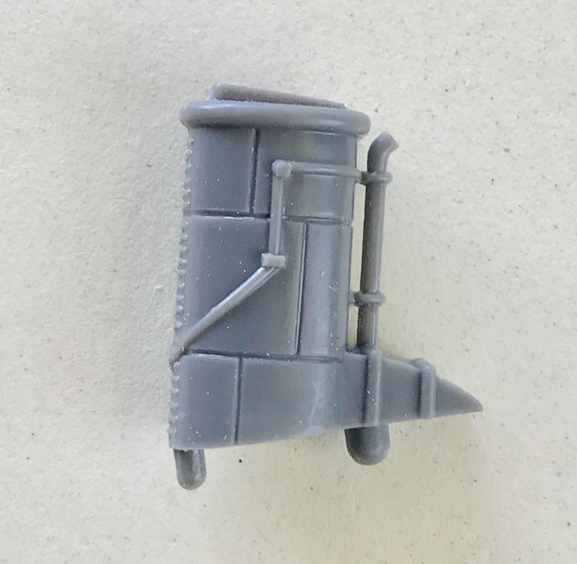

and lastly I built up the stack...
this is gonna need lots of changes from what I’ve seen in photos and drawings
