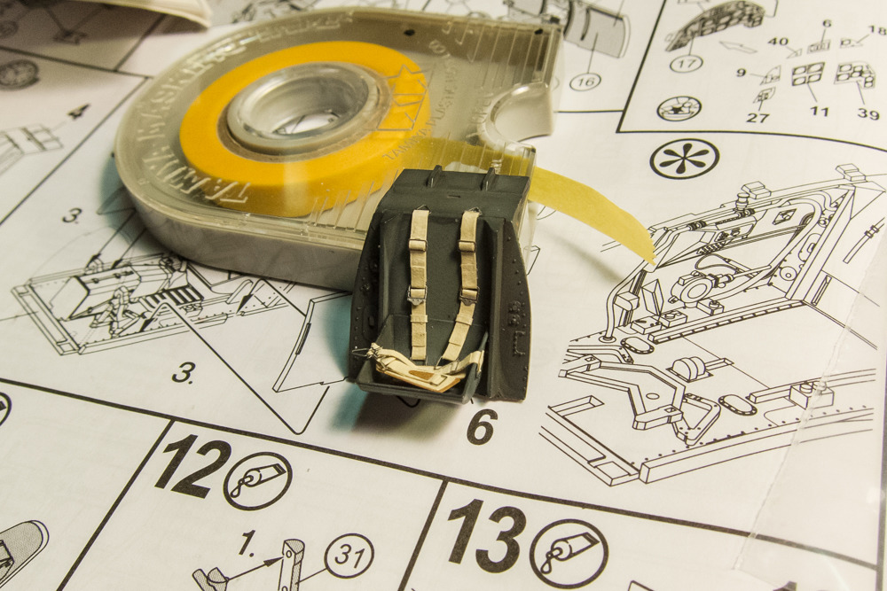

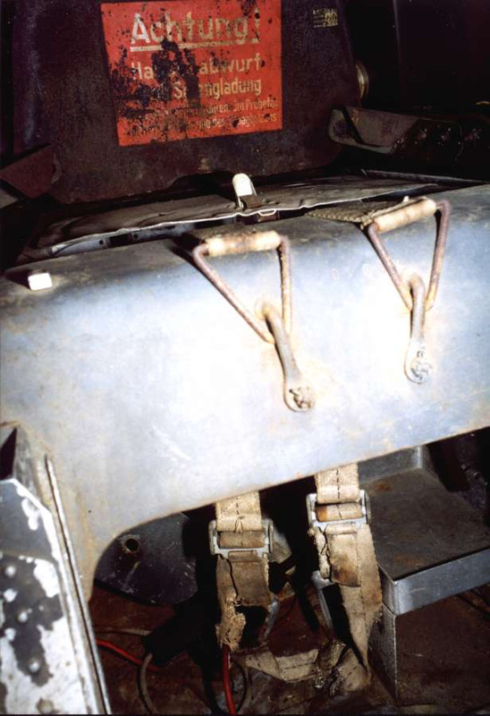

Happy New Year and congratulations on 26 years of marriage, John. Also: congratulations on your progress to date. I have a question, if you don’t mind. How are the upper shoulder belts attached? Does leaving out the rear seat back rails affect their position? Based on these photos, the base arrangement looks like hook and loop style fasteners, only fabricated from steel, and then countersunk within the rear cockpit bullhead. Tidy, but quite cramped! Perhaps my understanding is incorrect, though. I’m not sure! Will you be attaching those somehow? Maybe I am missing something here. I need to find the book that ZM makes. I have it packed away someplace.
Re: 1/32 Zoukei-Mura Ta152H-1 White 7
Happy New Year and thanks for the reference photos, Bruce! The attachment lugs for the shoulder harnesses ended up below the top edge of the seat back. In the photos shown so far, you can see that the shoulder belts are just hanging there, unattached. Since then I've pushed the shoulder harness attachment tabs behind the seat, pointing downward, kinda like they are shown in the reference photos. Not enough space to place the half-loop connectors so I think I'll just leave them as is.

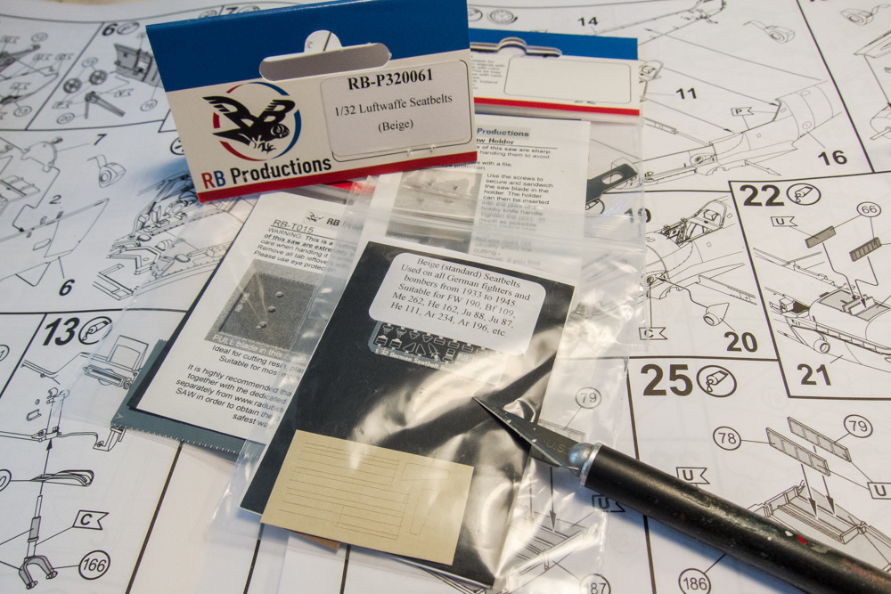

My apologies - I was just worried unnecessarily for some reason; also feeling guilt to not be here to directly see your progress. Personally I would have sided for a closed panel but I have no doubt that you are the ultimate arbiter and found Radu’s argument credible. Hey, have you ever tried his paper seatbelts? I always wanted to try them.
No apologies required! Life has a way of intruding upon our hobbies and I know what it is like to be disconnected from the modeling community for long periods of time. I didn't feel strongly either way about the missing panel so I went with the most persuasive argument, which was Radu's. In the long run, it's all going to get bundled away underneath a closed canopy so I'm not going to sweat certain interior details.
I tried RB Productions seat belts once. Very similar to HGW's except there are no imprinted textile details on the fabric itself like HGW features.
