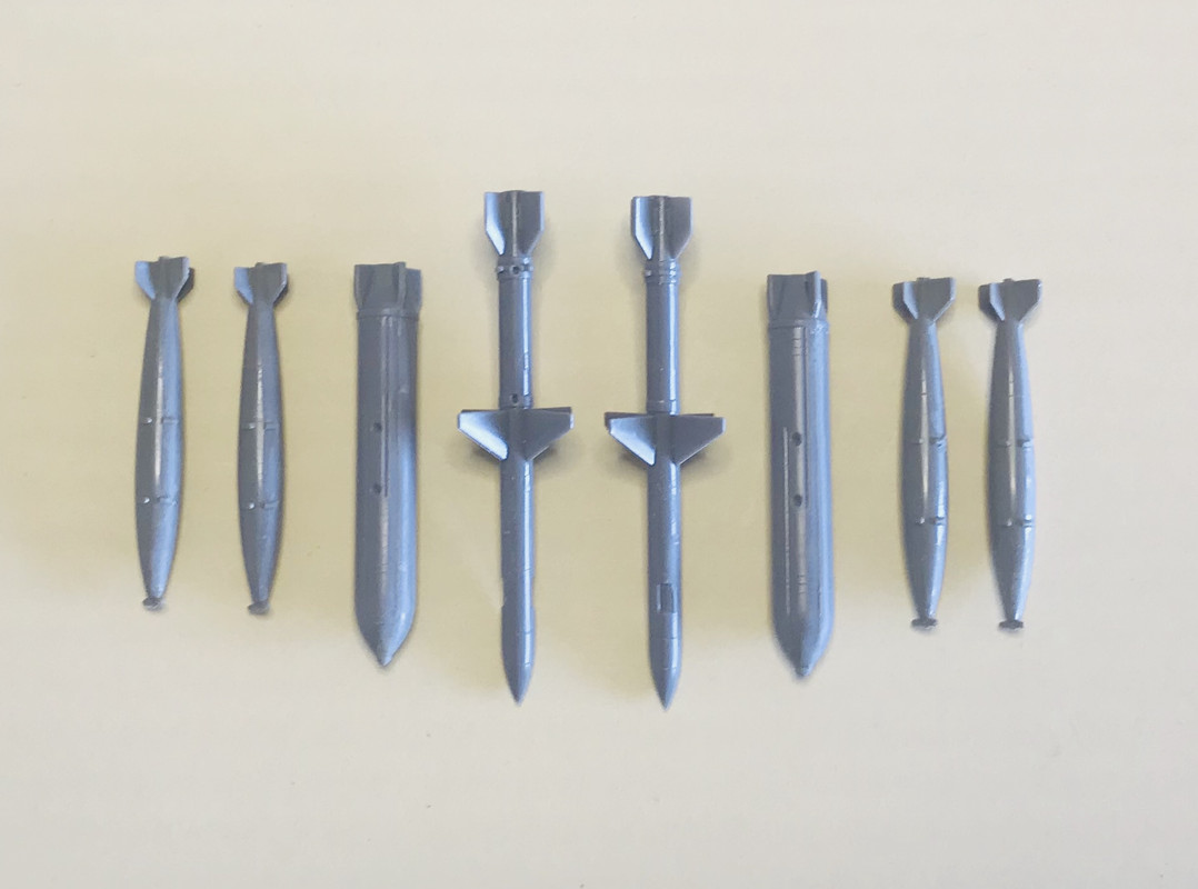

Yesterday, I did seam clean up on the wing to fuselage join, rescribe of lost panel lines, and began seam clean up on the ordnance. I’m gonna go with a mixed load of “slant four” Mk.82 500 lb LDGP bombs from the kit, plus a pair of Mk.20 Rockeye CBUs and AGM-45 Shrikes from a couple 1/48 Hasegawa US Aircraft Weapons sets
all based off of this photo, so I know that the load out is real.
However I will not mount the Sidewinders, as I have yet to come across photos of VA-93 A-7s carrying them at that time

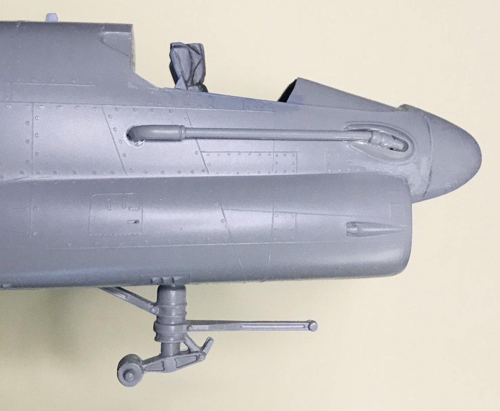

First up, I added the landing gear struts. Since the under surfaces, wheel wells, and gear struts are all the same color, gloss white, why not? Mold seam line clean up took a good while with needle files... I also added the refueling probe

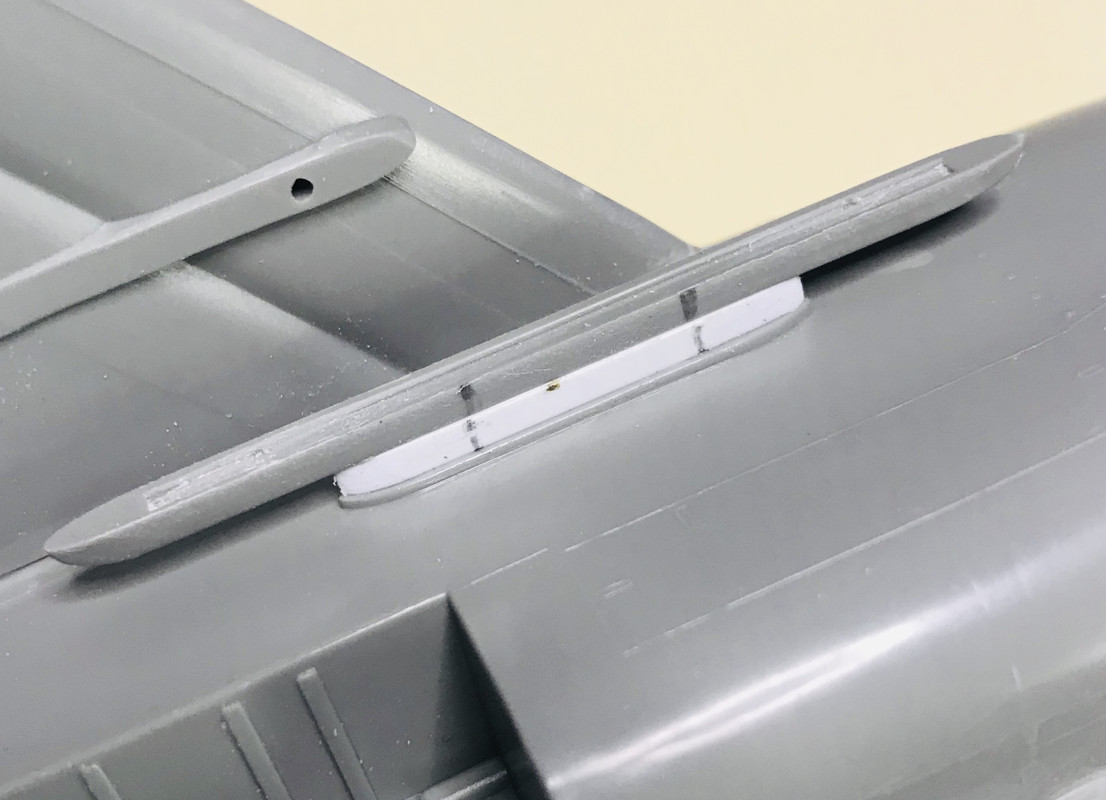

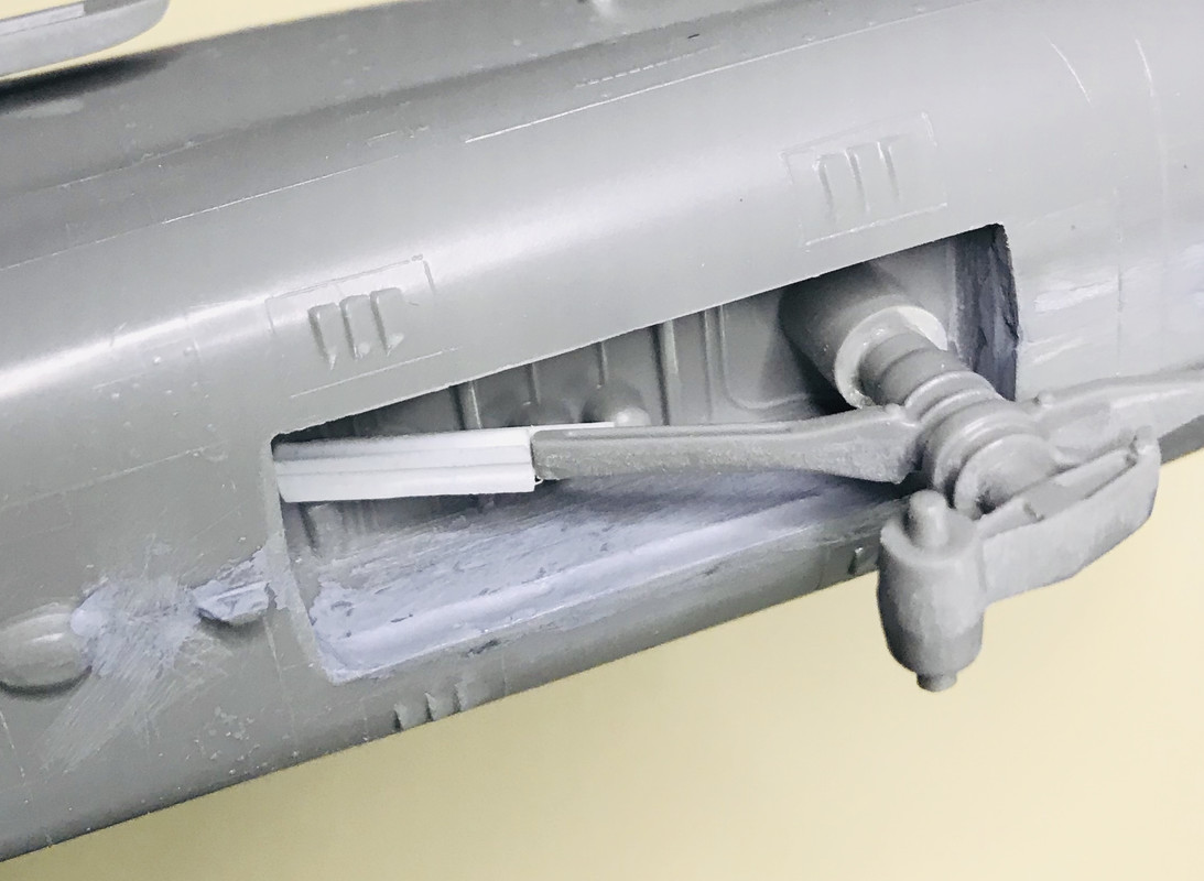

now I have the Detail & Scale book on the Corsair II and it points out two shortcomings of the kit: 1, the nose gear support strut ends before reaching the wheel well wall; 2, the Sidewinder rails are too close to the fuselage and need a spacer. I know that I said I was not going to do any superdetailing or whatnot. But these shortcomings bothered me, so I fashioned up the required corrections from some Evergreen Strip Styrene.
missile rail spacer
Nose Support strut extension
different angle of both
That’s all for today...
