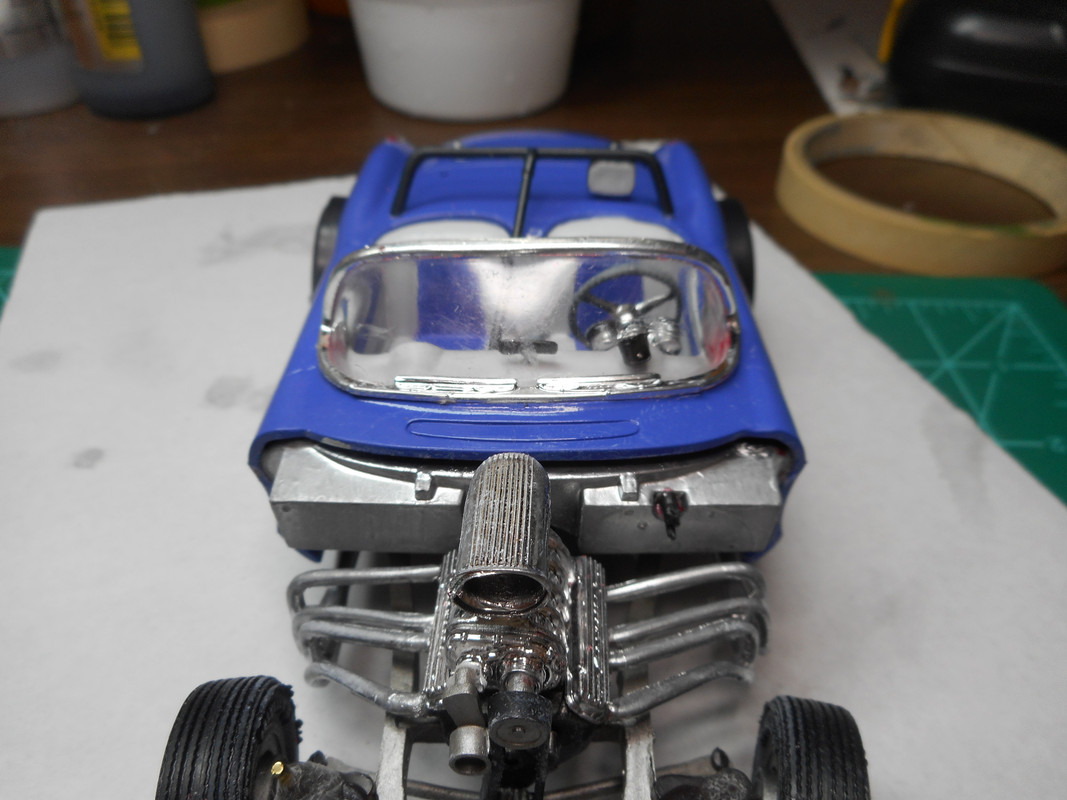

Maybe a little future on the windshield? Nice save on the wheels. Watching you build this... I'm pushing my kit to the back of the stash

After finally being able to look at these pictures I see what's happened. If you are still able to remove the windshield and work with it, a good polishing with Novus 2 should bring it back out. After that, wash in soap & water and then dip the glass in Future. You should be able to use whatever glue you want after that Tom. Hang in there bud.

I took your suggestion and guess what? It worked like a charm! Thank you!!keavdog wrote:Maybe a little future on the windshield?
