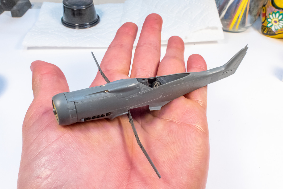

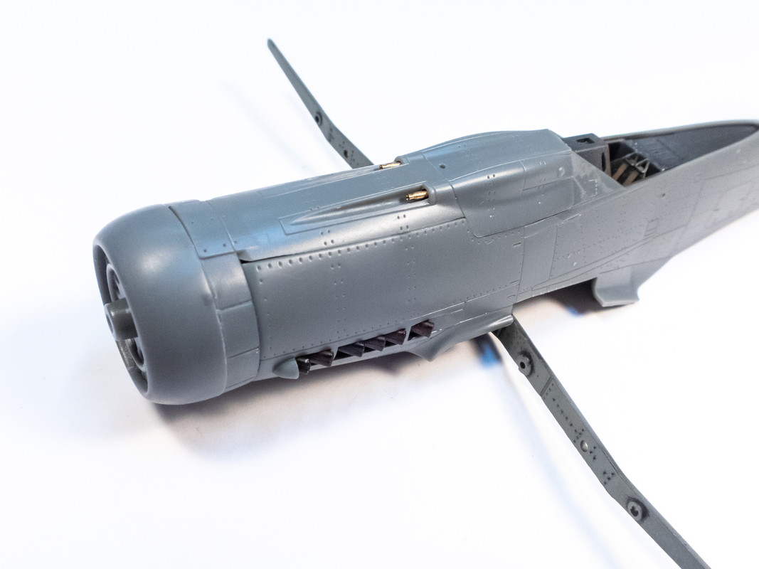

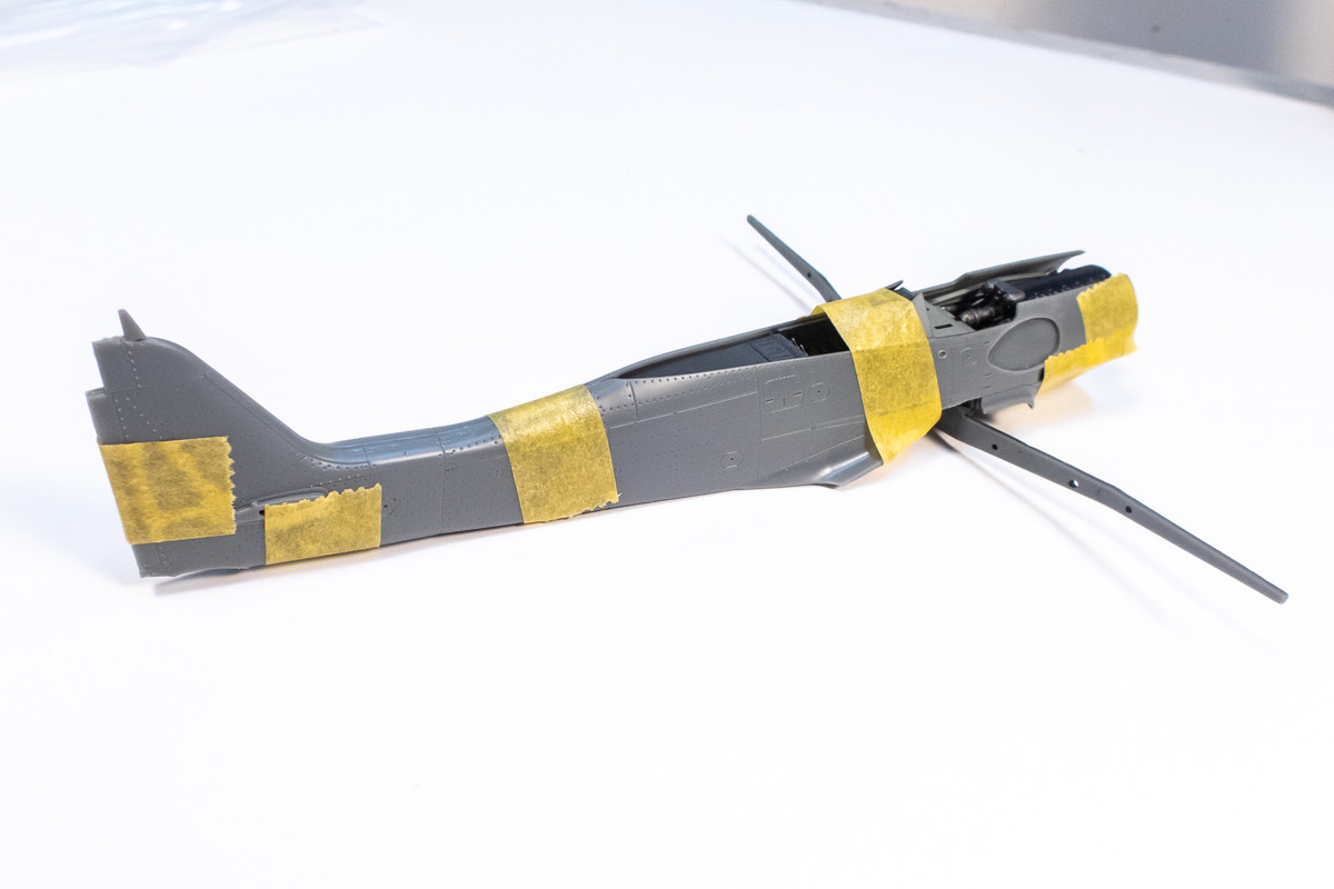

Moving steadily forward on this small build. Although it is quite complex for a 1/72 scale model, it IS smaller and that in itself speeds up many things. I've glued the engine/cockpit tub assembly into the fuselage halves and glued the fuselage together. Fit is ok but not perfect. The main issue I'm having is the angle between the engine and cockpit isn't quite right. In hindsight, I should have inserted the engine/cockpit assembly into the fuselage while glue was still drying to get those angles right but too late now.
Other than that angle issue (which I consider modeler error and not really the kit's fault), the fit is very good.

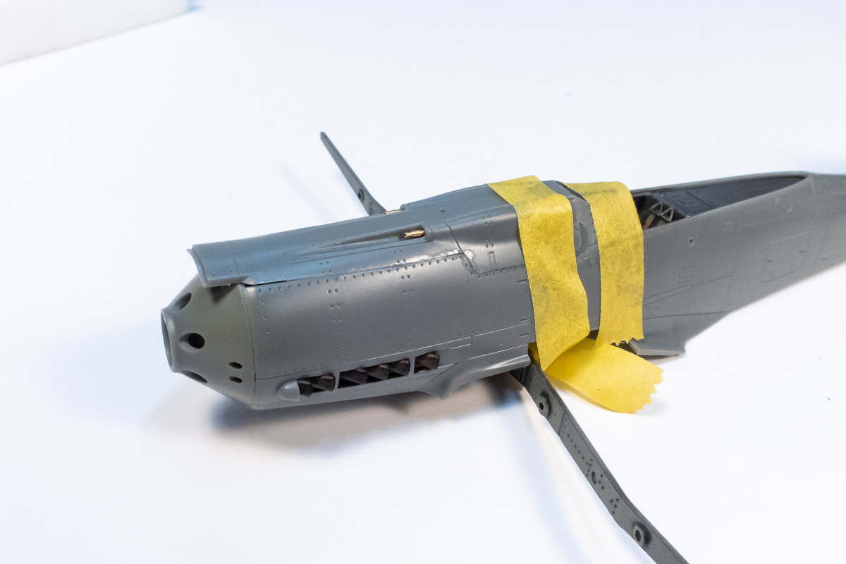

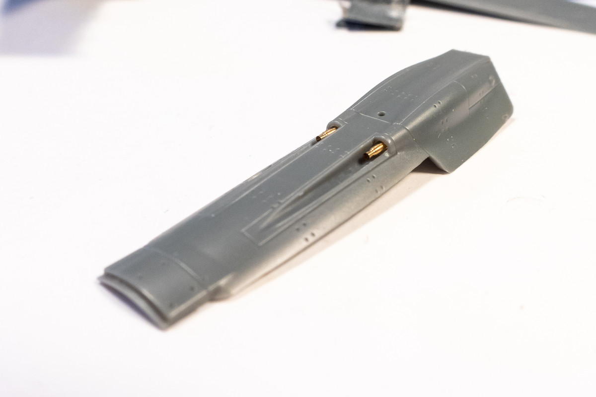

Using White Milliput, I've secured the cannons into the gun cowling. I've made sure that the guns are suspended off of the gun troughs so that I can slide a piece of paper or tape underneath to aid in painting after the camo has been applied.

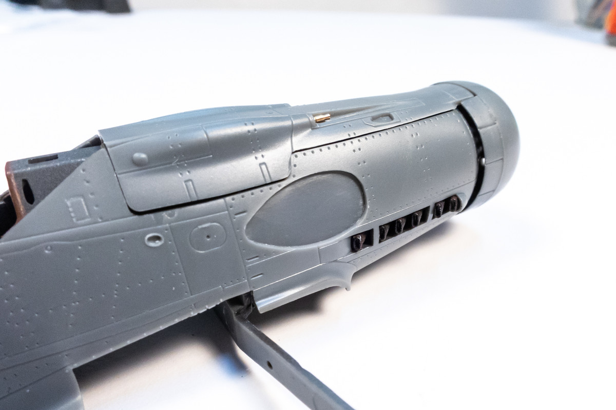

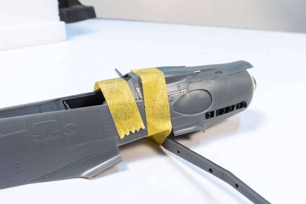

Check-fitting the gun cowling and radiator cowling. Don't see any issues so far.
Thinning the cowling flaps was a good idea since the edges will be visible, even in the closed position.

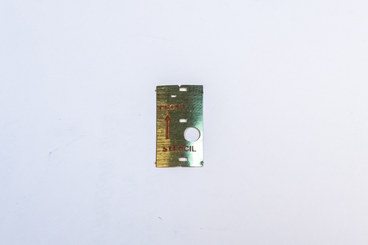

IBG thoughtfully provides a scribing template for the cowling fasteners and round hatch on the bottom of the fuselage under the engine.

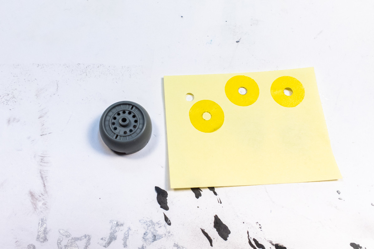

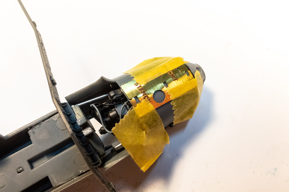

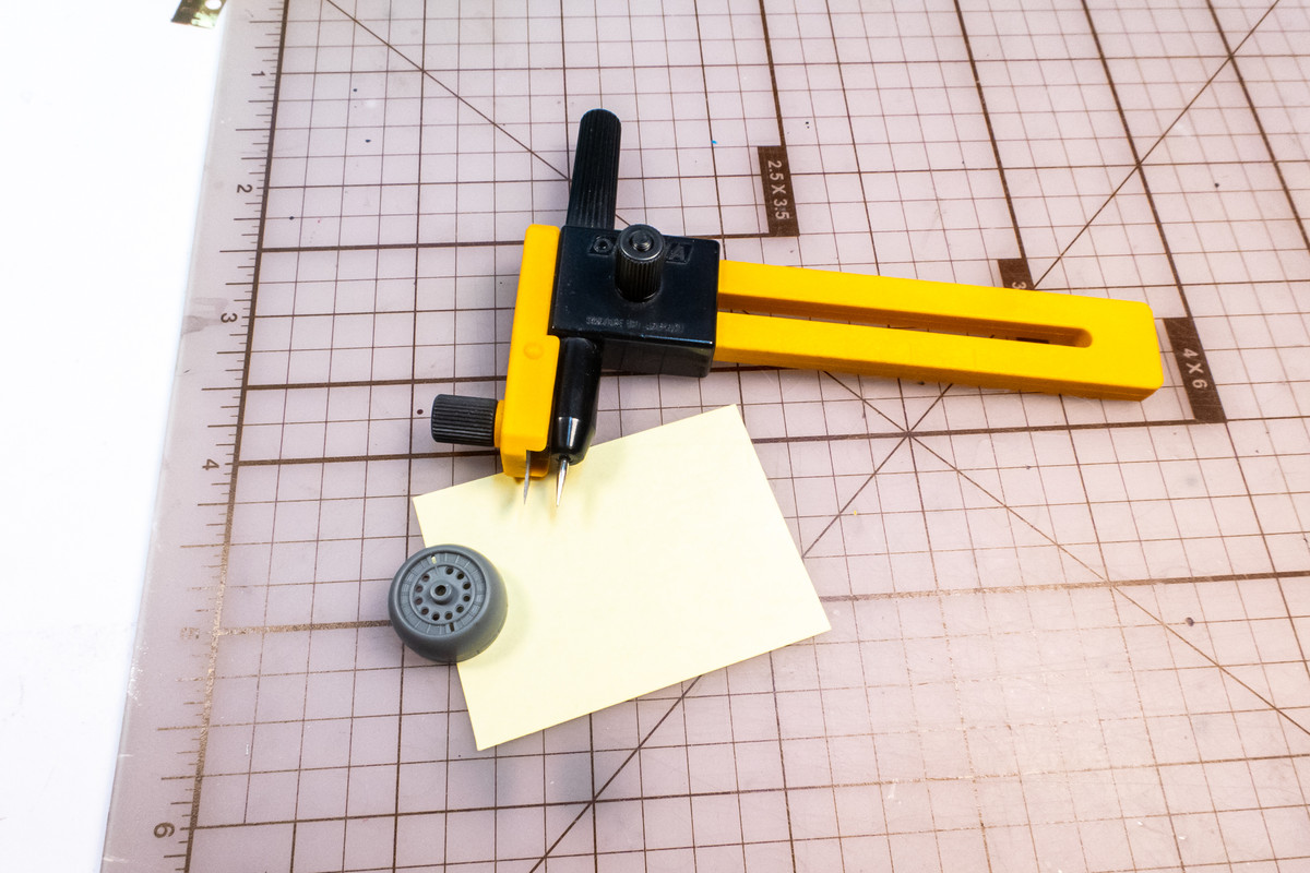

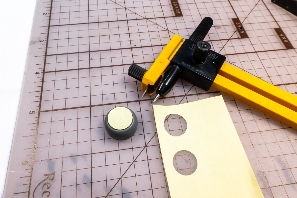

Update not finished yet! I busted out the old school compass cutter to fashion a mask for the radiator cowling face, which I want to paint now. A Post-It is used to dial in the size of the mask and the final is cut on a piece of yellow kabuki tape.
The radiator face has been painted and weathered. Obviously the mask goes on top of this but I forgot to take a pic.

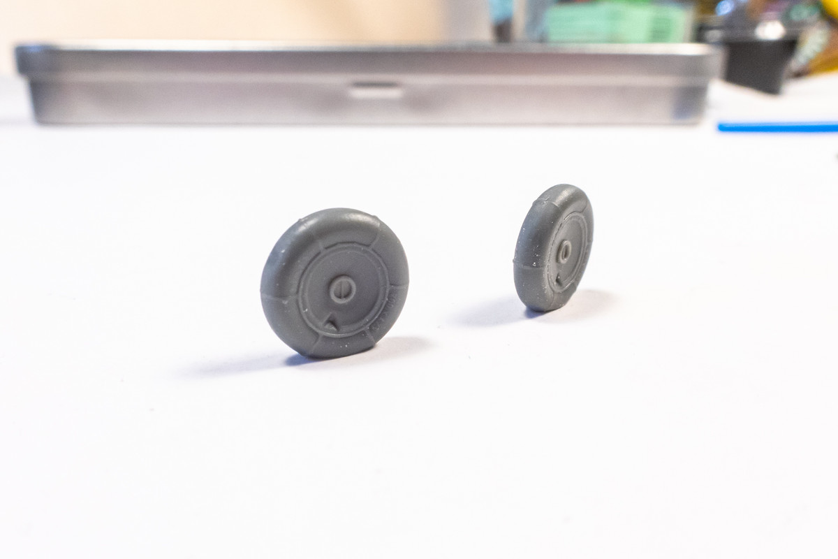

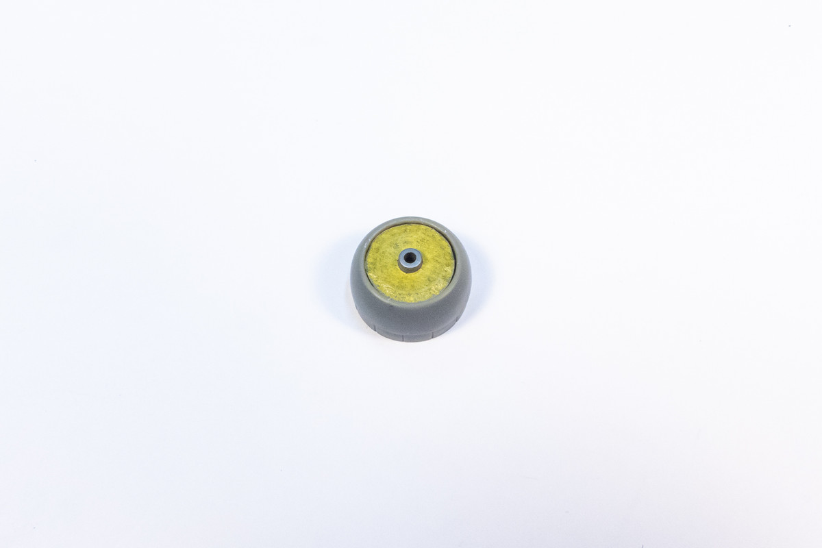

Flat spots have been sanded onto the tires to simulate weight.

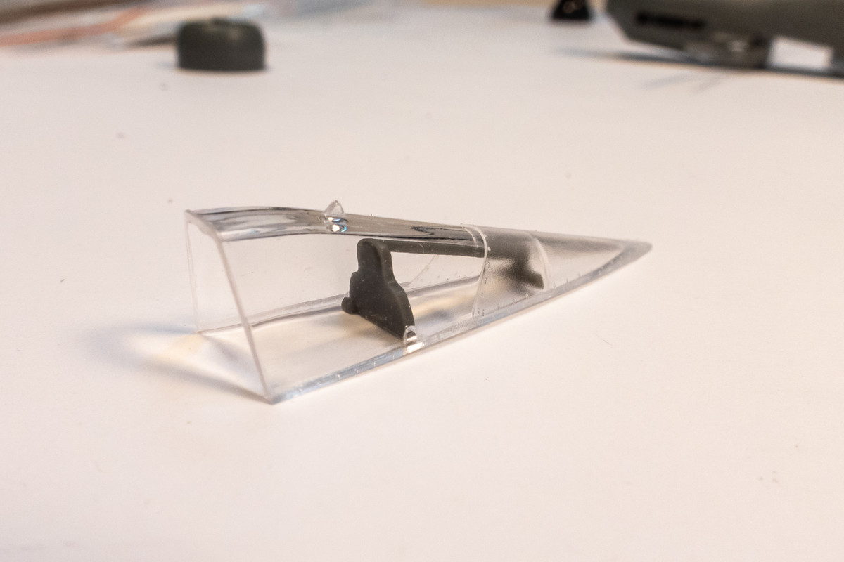

The headrest is a two-part affair and I set them within the canopy as the glue dries so that it is correctly oriented.

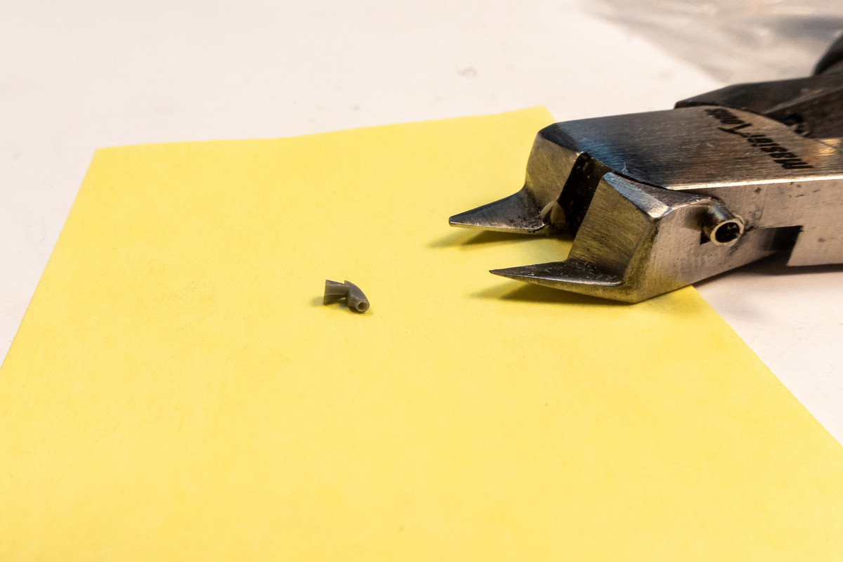

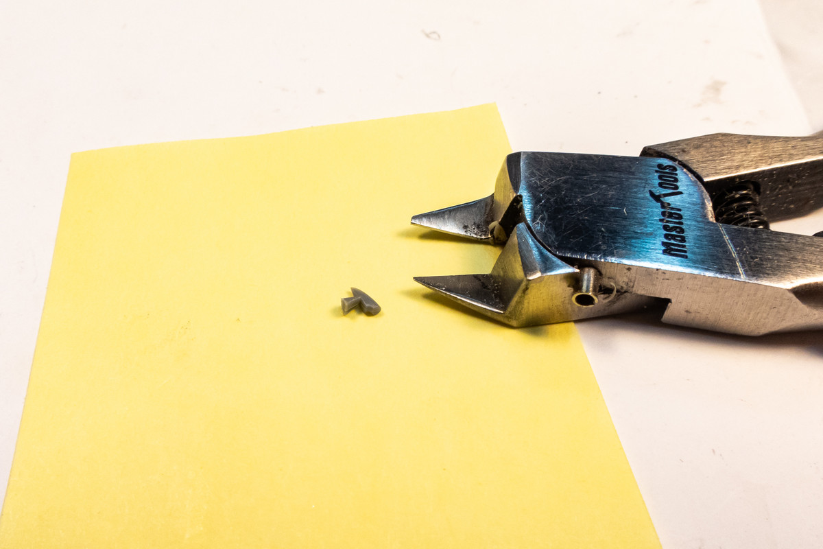

One of the smallest plastic parts is the small scoop that goes on the gun cowling. It is so small that I purposefully left part of the sprue gate attached so I had more to hold onto when hollowing out the end with an x-acto blade. The snippers are just there for size reference... they had nothing to do with this step!

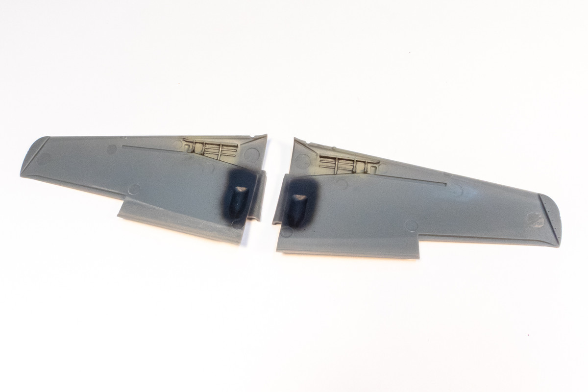

The interior of the wing tops has molded details for the wheel wells. This spreads out the wheel wells apart among separate assemblies, which makes painting the wheel wells a bit of a pain.

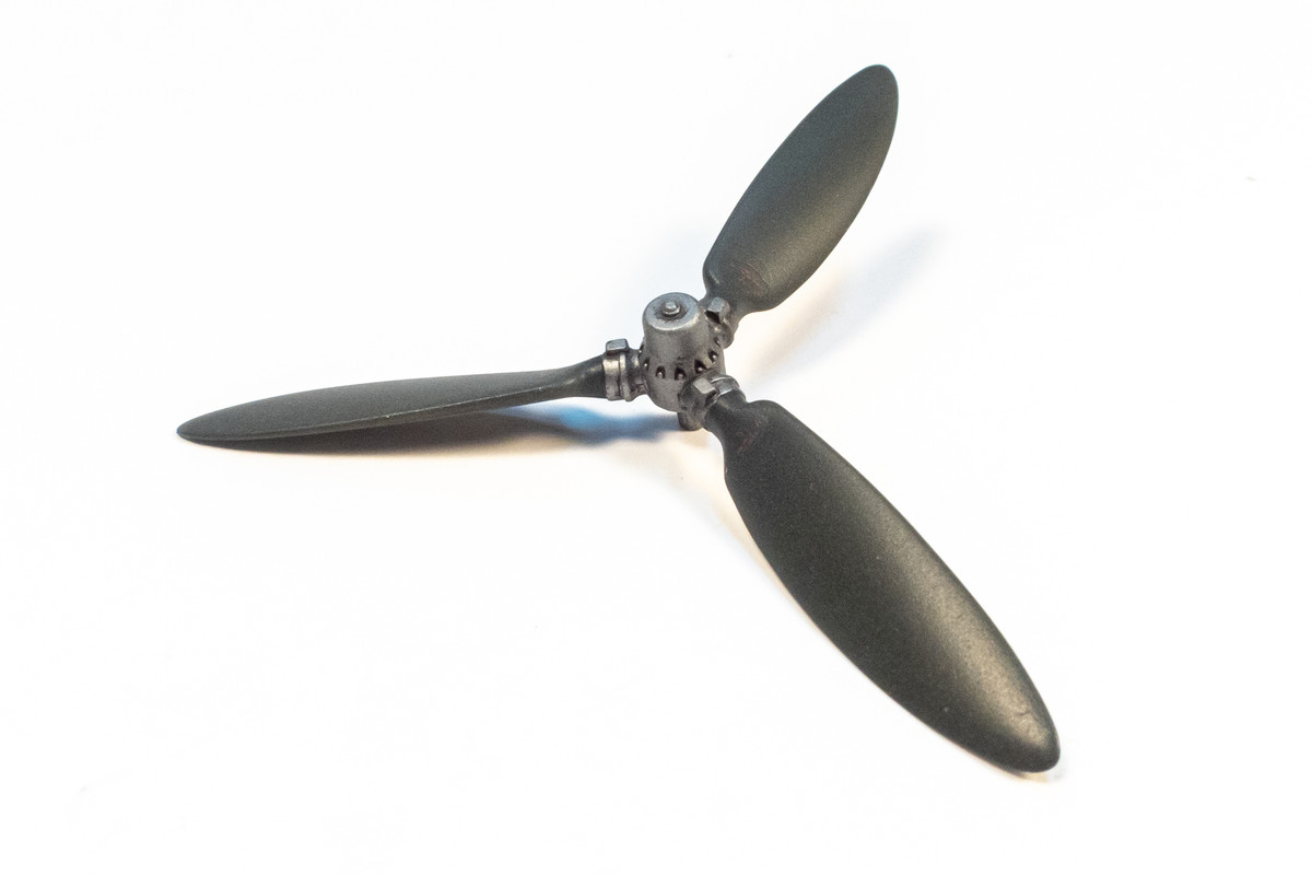

Finally, the VS-111 prop. It is quite a nice representation including the balance weights on the hub. Although most of the hub will be covered by the spinner, I wanted to paint and weather it because it had such good detail on it.

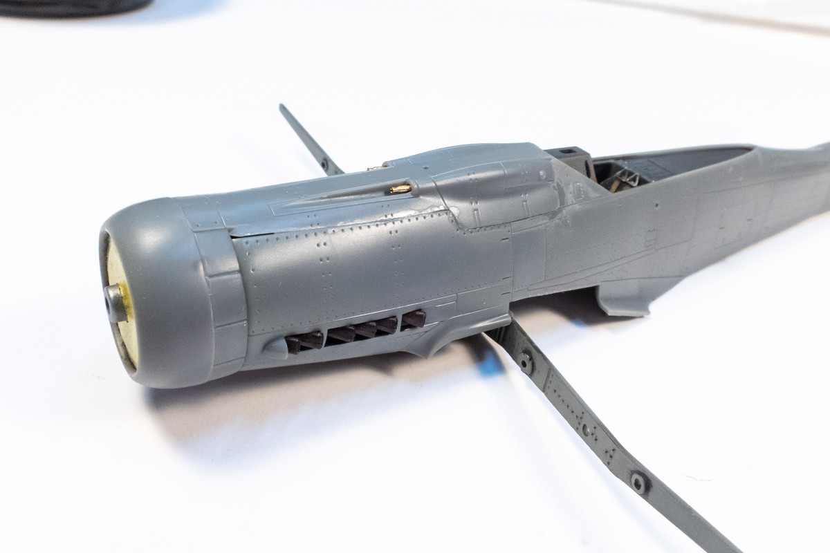

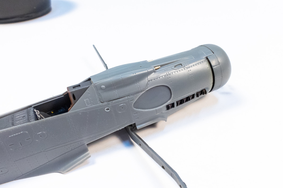

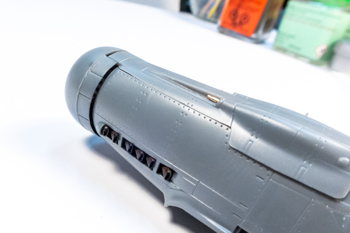

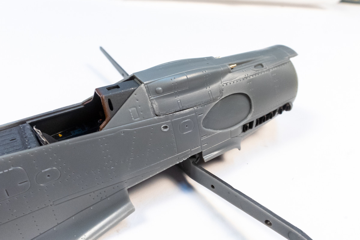

I watched the Super Bowl at home with the wife so not as much modeling work today. I managed to glue the gun cowling into place. Again, the fit is good but not perfect and I have a strong feeling that this is all stemming from the slight misalignment that I introduced between the engine and cockpit assemblies and probably could be avoided by other modelers.
Yes, there are some small gaps that I need to fill but I'm totally ok with that as I have seemed to avoid any steps or overhangs, which are much harder to correct than just gaps.
I've not yet glued the radiator cowling into place yet. I like to address the seams one major component at a time and I'll fix up the gaps around the gun cowling before that. The face of the radiator cowling has been painted and I've now applied the mask that I made a few steps prior.
The fit of the radiator cowling doesn't look to pose any problems.
I decided to apply some salt weathering to the prop blades. This is done by wetting the surface and sprinkling small salt crystals in a random pattern. The water fuses the salt crystals to the surface as it dries, forming a random splatter-type mask pattern. A very watery contrasting shade (usually grey or tan) is lightly airbrushed over the salt crystals. Wipe everything away with water and you should be left with a mottled stain pattern that kind of looks like hard water stains. The initial effect was a little too obvious so I toned it down with a watery mix of the original prop color (RLM 70 Black Green, Mr Hobby Aqueous).

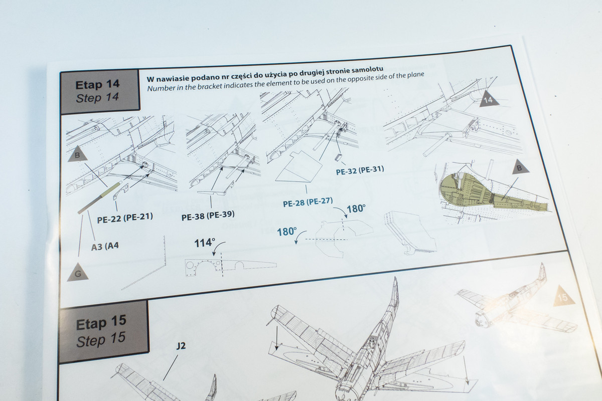

Construction now proceeds in a somewhat unconventional manner. After the lower wing part is glued into place, you need to fold some PE parts and glue them into the wheel well area BEFORE gluing the wing tops on. I've seen another build of the IBG D-15 kit and that modeler had some issues closing up the wings due to interference from the PE parts. I personally don't like this approach because of the potential fit issues and complicating the painting process but we shall see...
