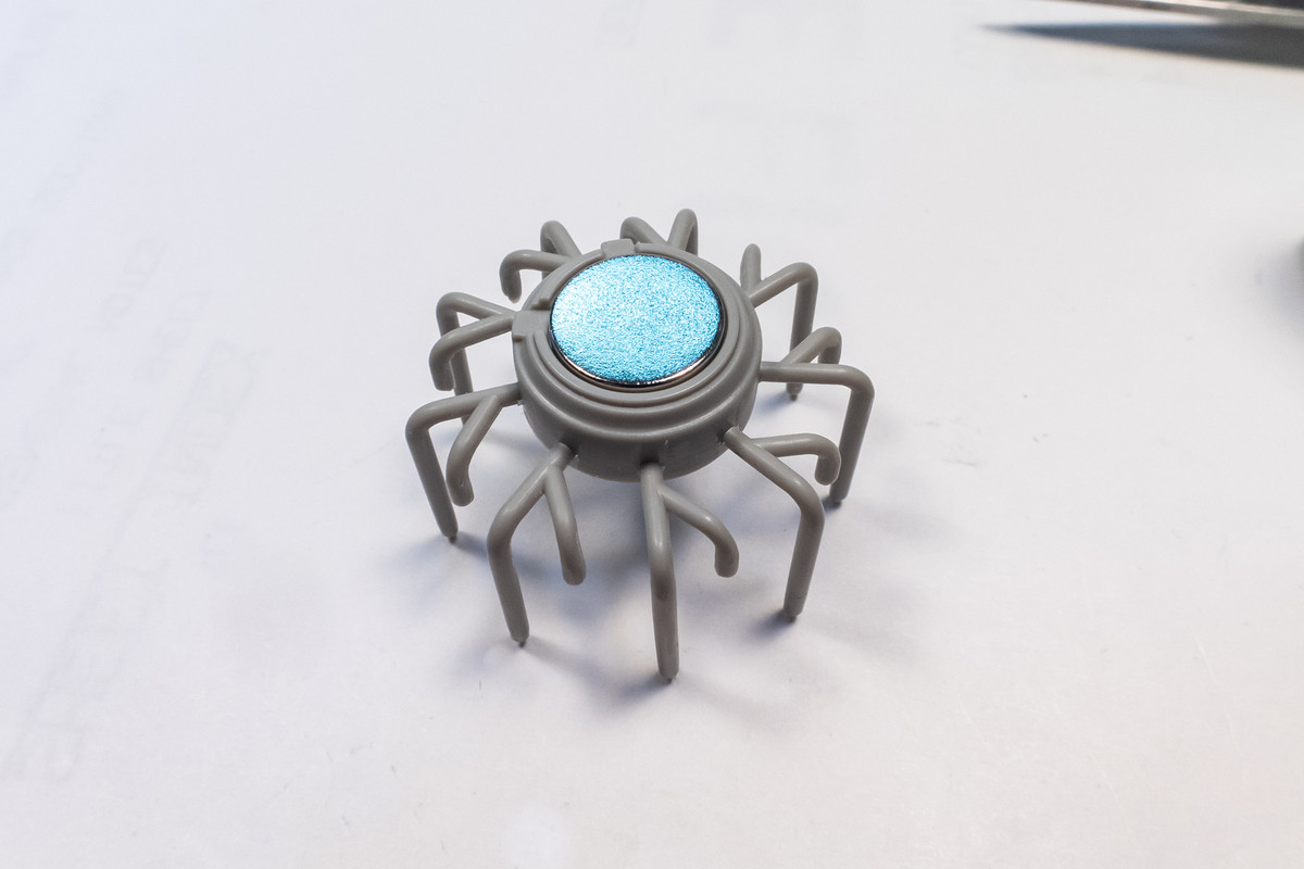

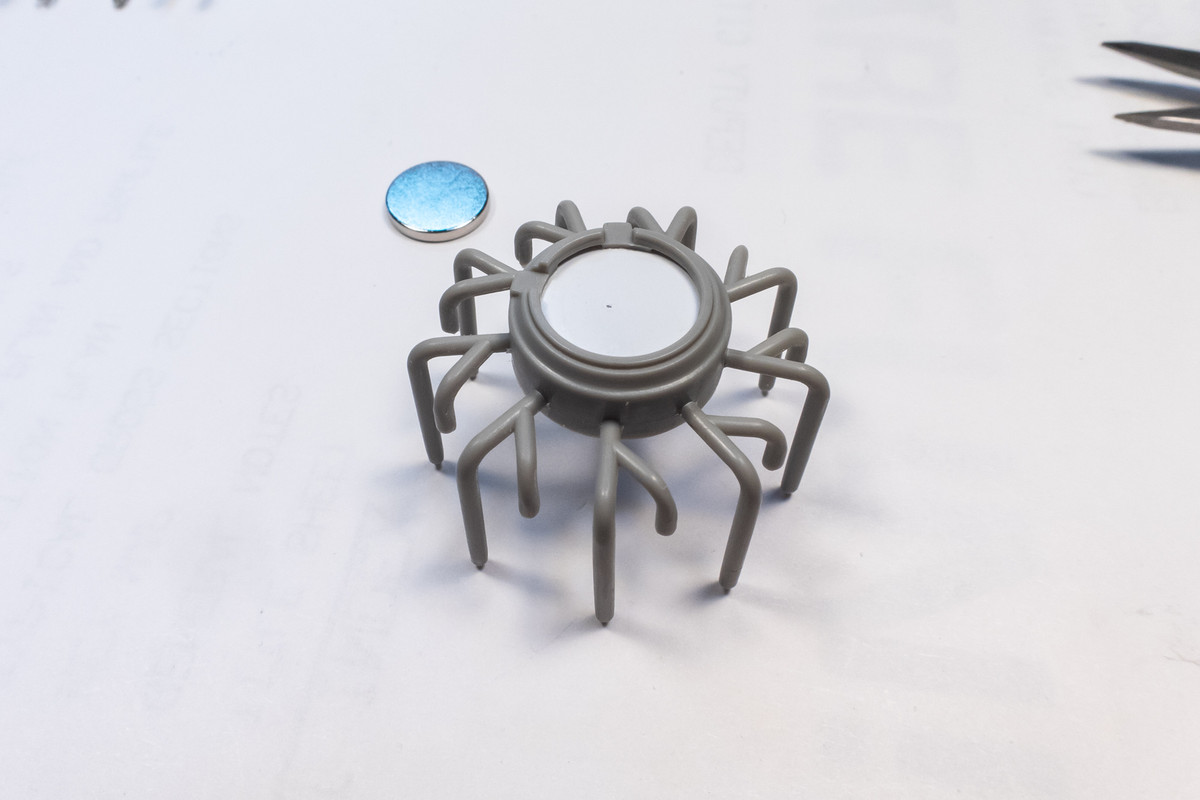

Going back to the magnet idea, I just received a set of 7/16" neodymium magnets in the mail today so I was able to start to test this idea of using magnets to provide a more secure attachment between the engine/cowling and fuselage/firewall. The rearmost engine component closest to the firewall is the intake pipe ring. The circular base of the intake pipe ring is about level with the opening in the firewall so I thought that this would be a natural connection point.
The magnet is almost the same size as the circular opening at the base of the intake ring. But knowing the strength of these magnets, I wanted a more secure glue base. So I cut a small piece of sheet plastic and glued it into the opening from the other side.
The magnet was attached using CA glue.

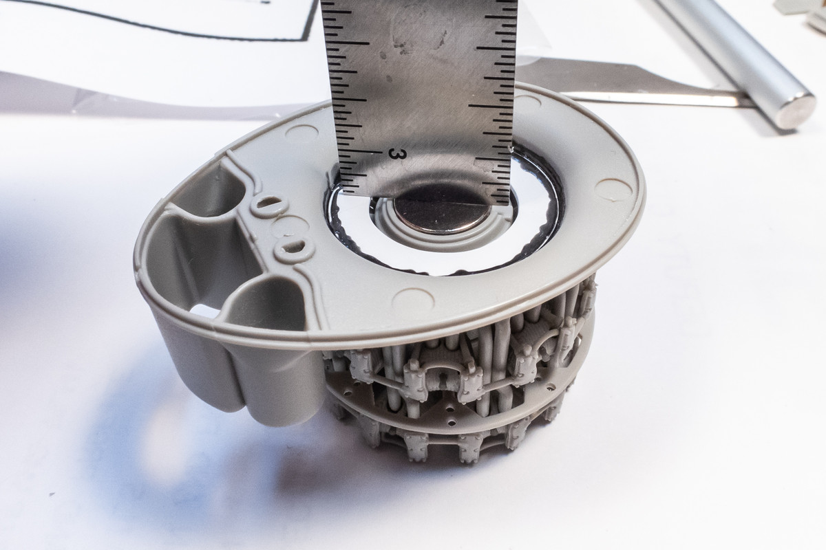

I cut a ring of thicker sheet plastic to serve as a spacer/mount for the other magnet to placed on the firewall opening.
The ring was glued into place using CA glue. Thin CA first and then a ring of black CA to reinforce the bond. The magnet in the engine seems to level with the spacer.

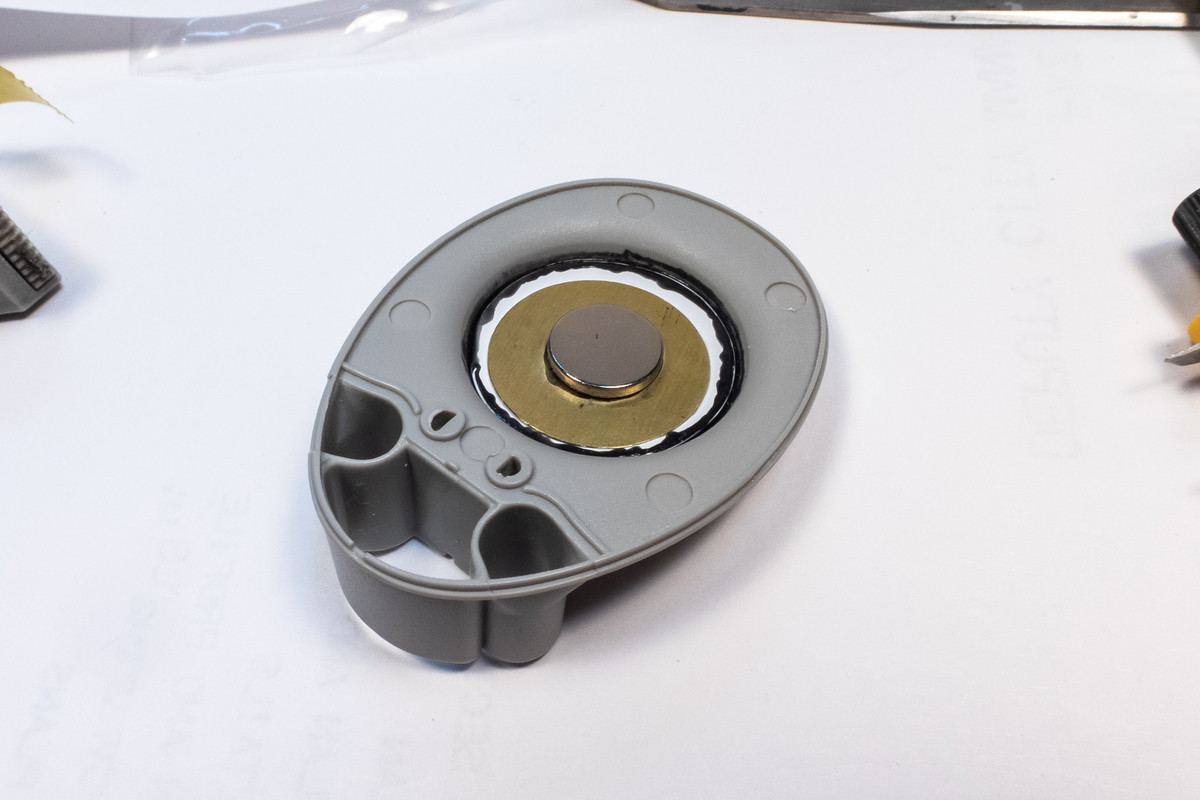

A disc of brass sheeting was used to cover the opening.
The second magnet is glued into place with CA glue. I actually mounted the engine assembly with the first magnet onto the firewall and used the magnets' irresistible urge to align themselves to locate the second magnet.

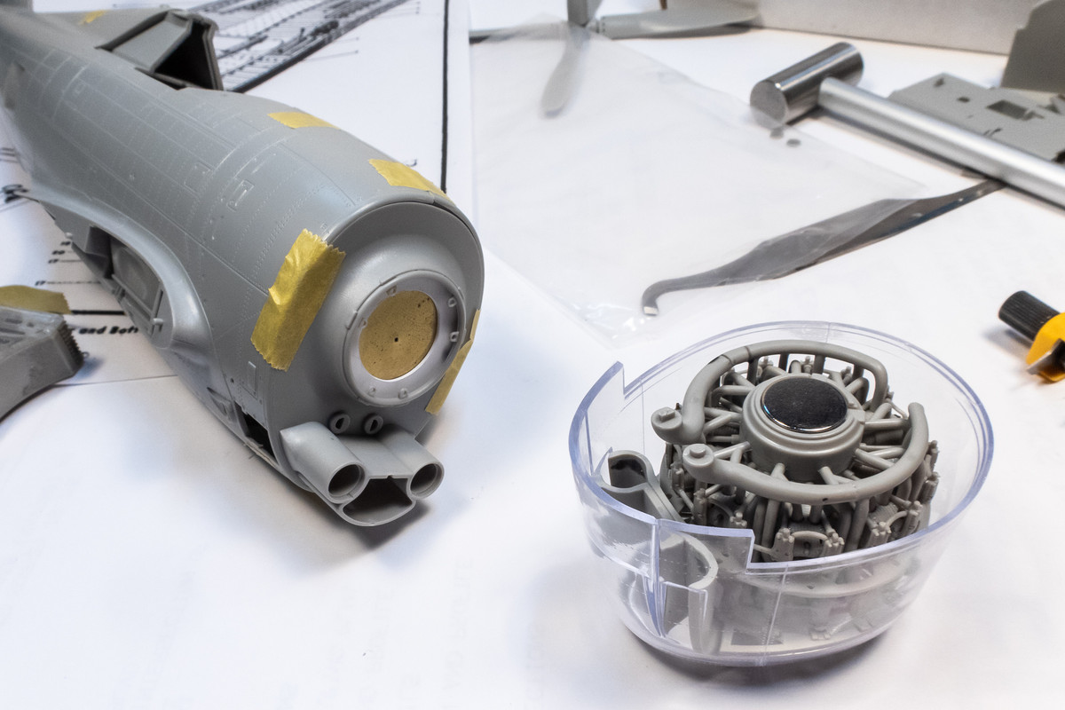

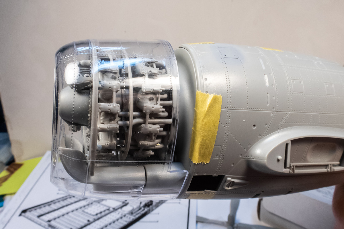

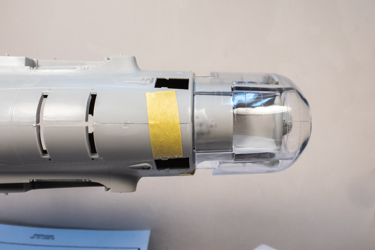

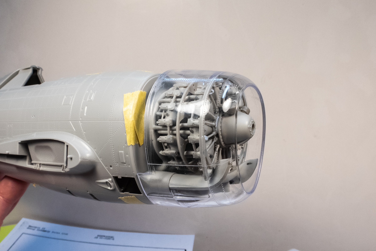

The big test now is to see if this idea will work. The engine components have been dry-fit into the cowling and I've taped the firewall onto the fuselage. The magnetic force is so strong that it pulled the engine out of the cowling and snapped into place.
I had to place the firewall onto the engine FIRST and then attach the firewall to the fuselage for this dry fit.
Preliminary tests look really good but we'll have to wait until the glue hits the plastic to see if this is a success or not. If it goes as well as I hope, I'm thinking of keeping the engine cowling removable.

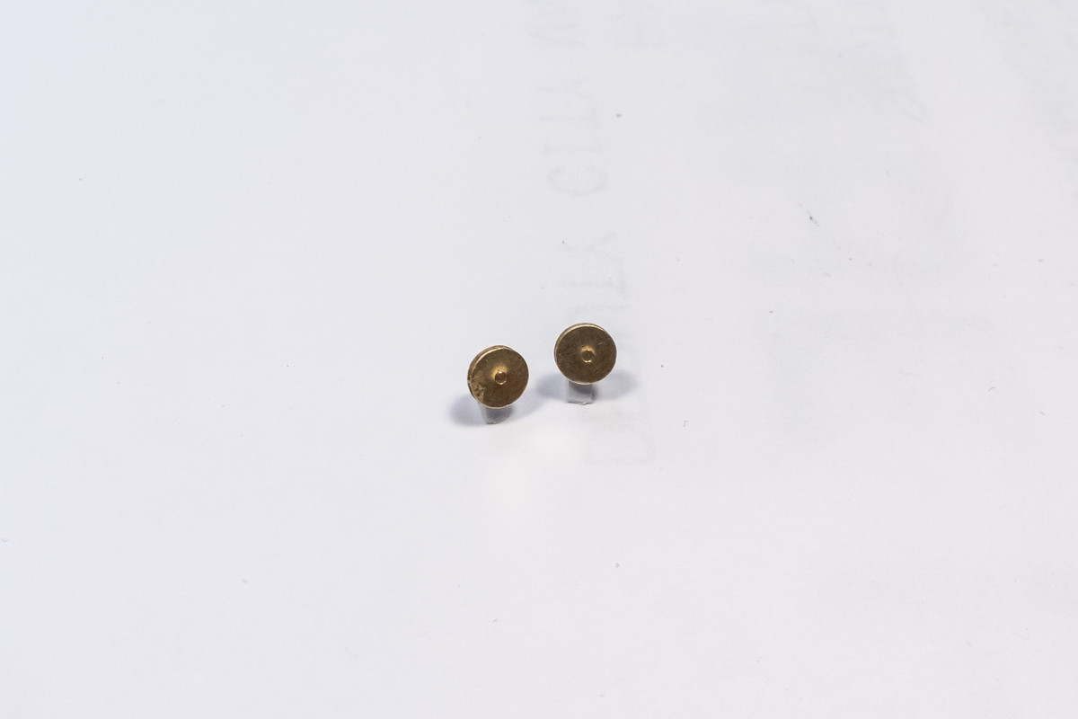

These are small pulleys for the rudder cables that lead from the rudder pedals to the rear of the cockpit. They were fashioned from punched circles of sheet brass and plastic. My initial idea is to use elastic thread to maintain taut and straight lines but I'll have to work on that thought later.

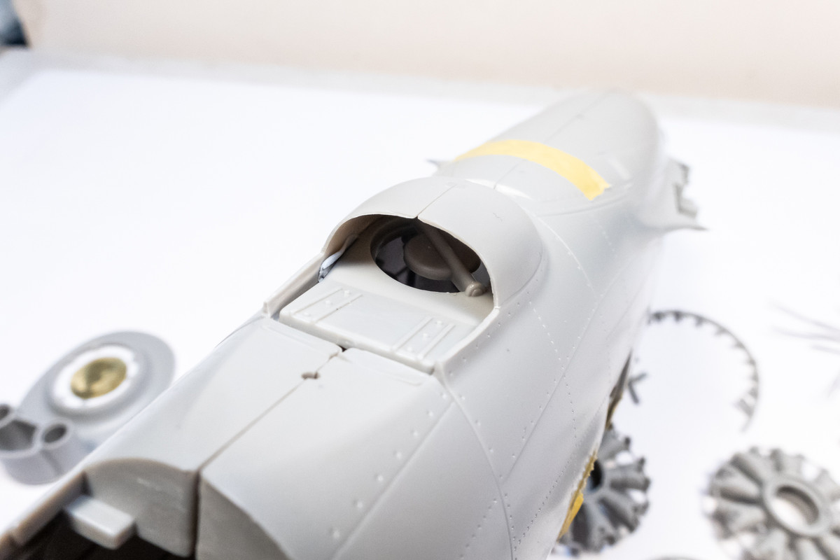

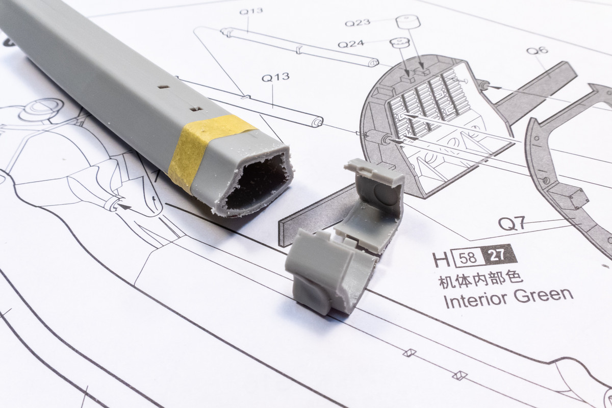

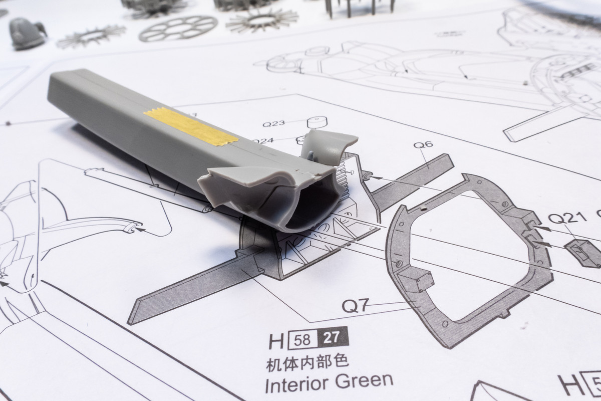

Earlier, I worked out the view from the mid-fuselage intercooler openings. But there are a couple more small openings that need to be addressed. One is the area in front of the exhaust waste gates seen in the photo above. Mostly covered by the oil cooler vents but the ducting is included in the kit as part of the extensive ducting network, which I am planning on leaving out.
So I sawed off the needed bits, which will block any potential view into the fuselage from this area.
The supercharger outlet on the bottom fuselage seems tucked away enough to not worry about the view here.

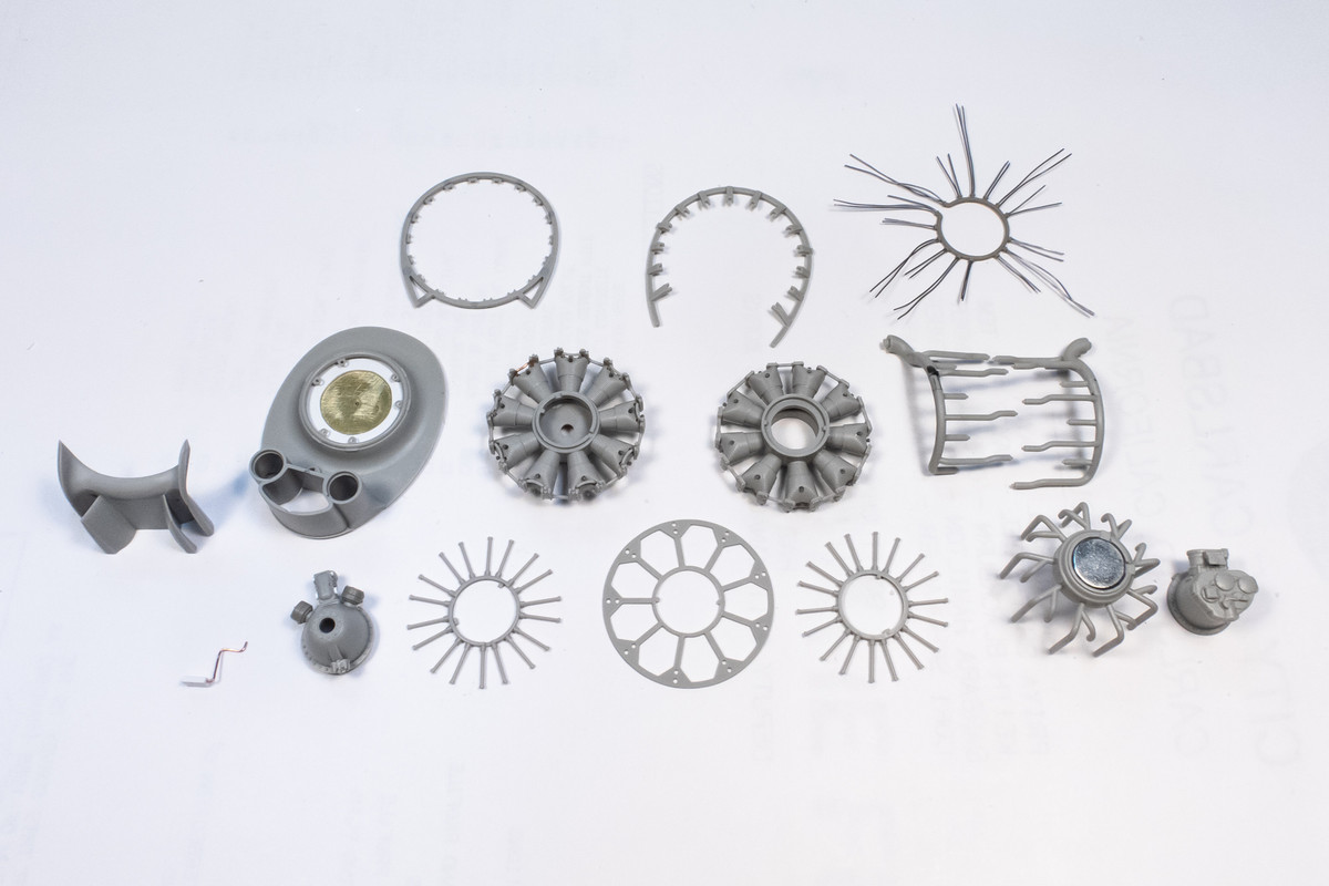

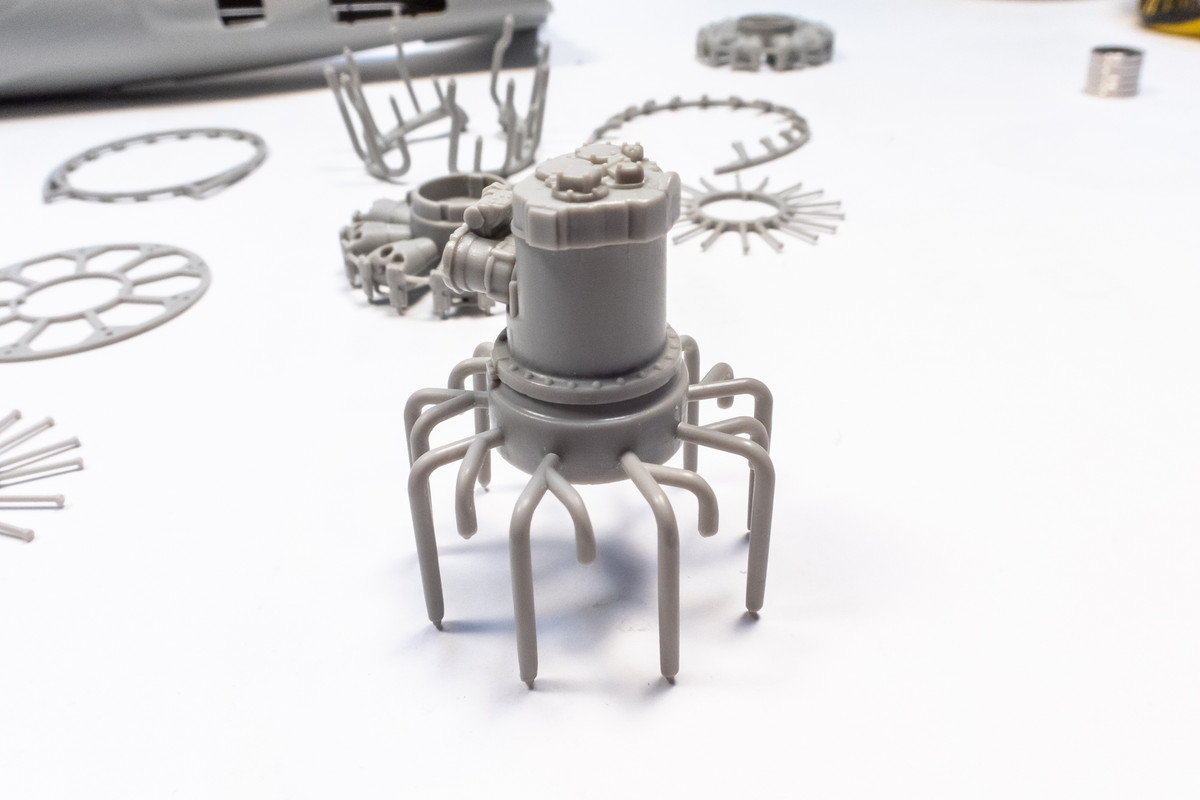

Moving on to the engine... Since there is a magnet installed onto the intake pipe ring, I put one into the rear engine assembly as well. If all goes as planned, the engine will be removable and I thought it'd be worthwhile to have the rear engine available to snap on when the engine is detached.

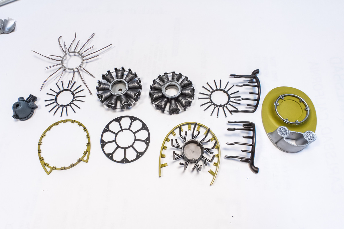

The engine components have been have been assemble and ready for paint.

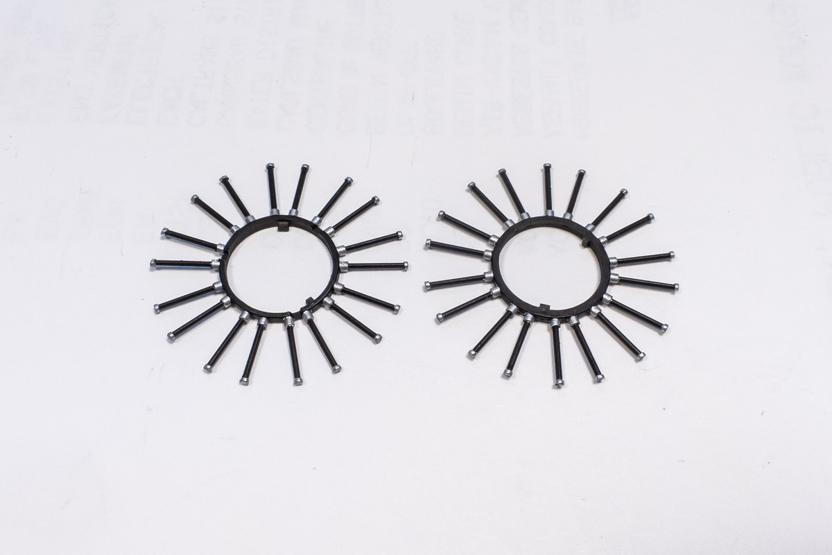

Silver for the engine cylinders, mounting frames and firewall... dark grey for the gear reduction housing and rear engine assembly... black for the pushrods, input and exhaust ducts and duraluminum (a metal shade with a hint of yellow) for the ignition ring harness.

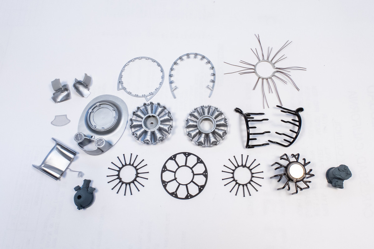

After the base paints have been applied, I detailed by hand-painting the various components.
Because the recessed lines of the cylinders were not very defined and had difficulty holding a pastel wash, I left the pastel wash essentially unwiped after application.
Here are the engine components after the detail painting. The input and exhaust ducts were painted Alclad Steel over the base black. The exhaust ducts were highlighted with Alclad Manifold Exhaust. The ignition wiring was painted a light brown color. I changed my mind about the color of the mounting frames and firewall and painted them zinc yellow chromate instead.

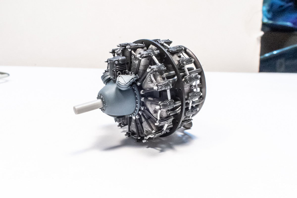

Assembly of the engine could now begin by gluing together the front and rear engine cylinder banks, sandwiching the black baffle plate between. The pushrods were glued onto the ends next. The input pipes are keyed so they only go on one way. The exhaust ducts are not keyed so it is easy to install them in the wrong orientation. So the gear reduction housing was put into place temporarily to help guide the correct placement of the exhaust pipes. The exit ends of the exhausts need to line up at the bottom of the engine.

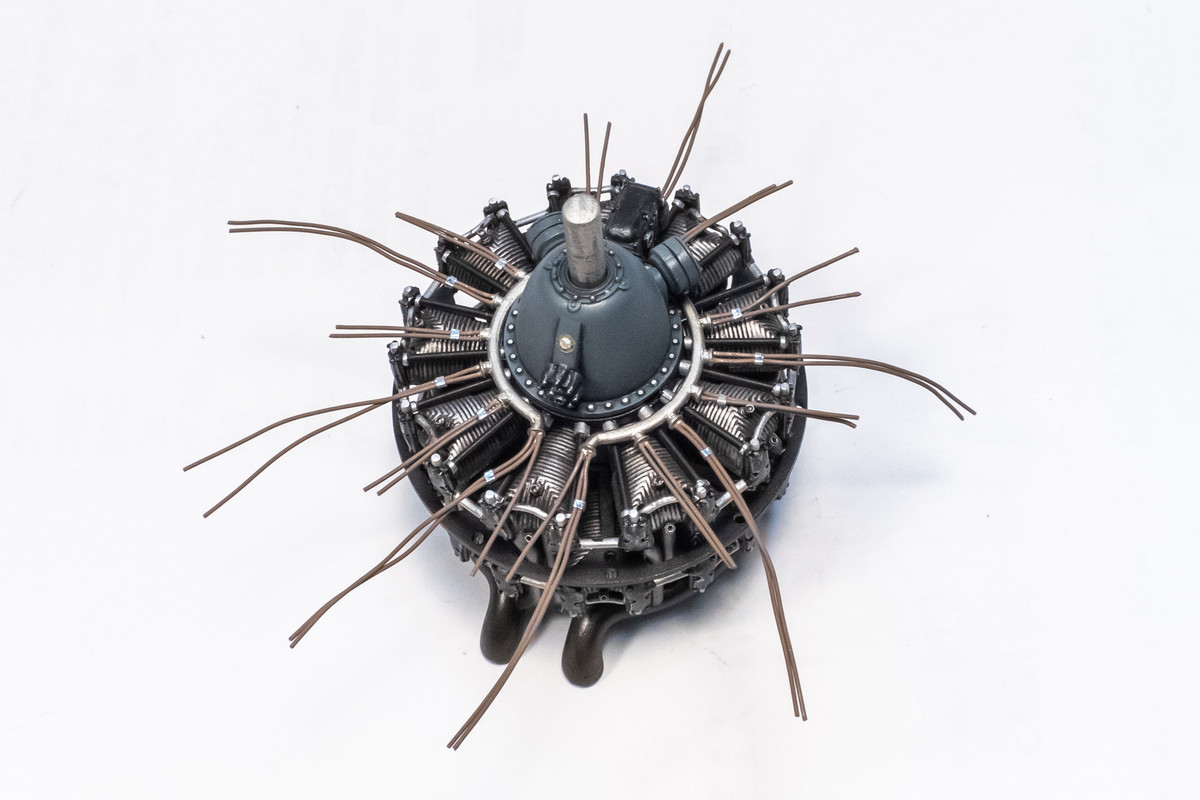

The last step and most time-consuming task of the build so far was mounting the wired ignition ring to the gear reduction housing and then terminating the ignition wires to their respective cylinders. More than a couple of wires became detached during this process but eventually I got it done. Note the little Pratt & Whitney logo... luckily I had a few left over from the F4U build!
Here is a preliminary look at the engine after the wiring work was completed.

John, that engine looks fabulous with some paint on it! :shoutout:

Wow! The engine looks real!
