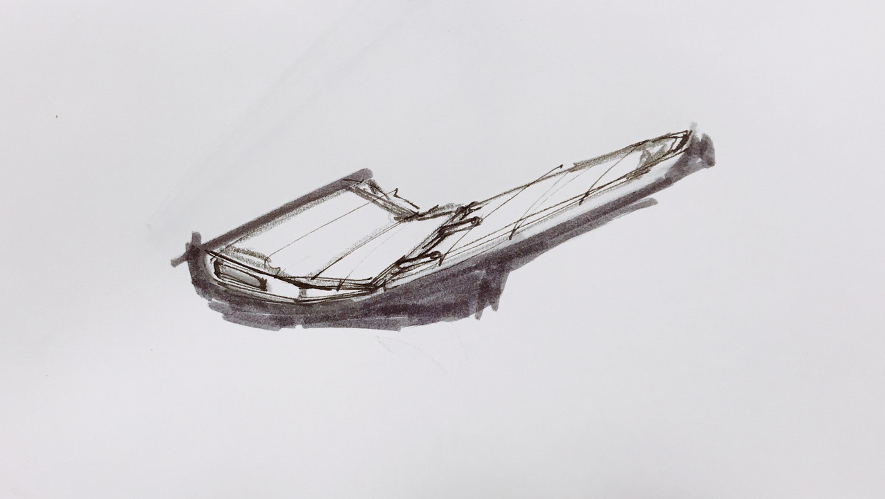

1. Kent’s right: you need to build a spar that will lock the pieces together. Do not worry you can do this.
2. I would use fairly rigid plastic. Cut off sections of sprue from the kit, as it is my position that kit to kit plastic bonds are slightly Black Magic attracted to each other in ways that carded plastic is not... you’re technicalky dealing with the same type of plastic.
3. Make spar one fit into the wing.
4. Make spars two and three fit into the fuselage wing join.
5. Test test test test fit. Build a support jig like a cast made of cardboard to hold the position as the glue sets.
6. Glue with a fairly fast epoxy. The kind that gives a few moments to align perfectly before setting.

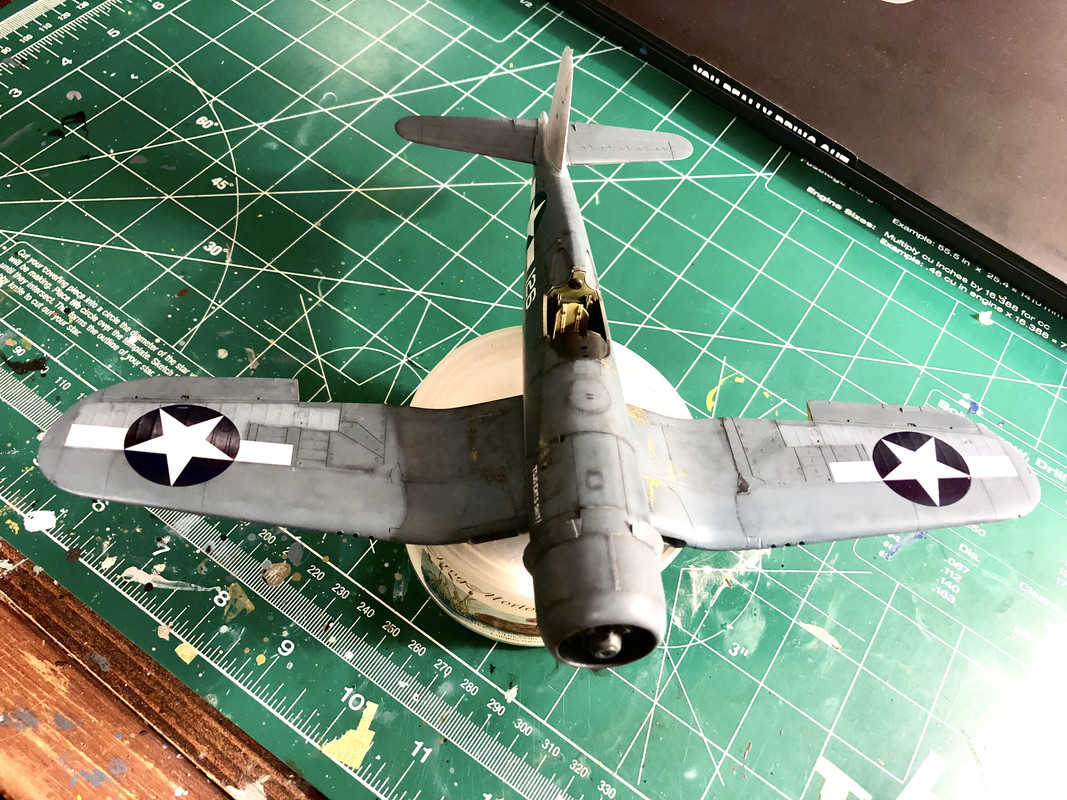

Back in the game! I tried a combination of Kent and Bruce’s suggestions and sonfar, so good!
Any damage to the paint caused by the epoxies and glues I can correct. At present the dihedral is correct and at this time that’s the #1 concern. I am happy to re-paint as needs be. And if this doesn’t work in the long haul, I have secondary and tertiary (building a whole new wing -thankful for spare parts from two other failed Corsair builds) options available.
