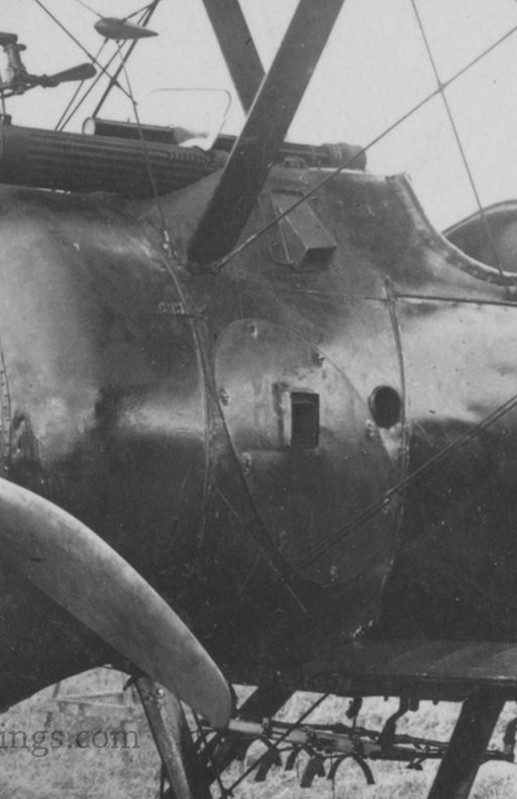

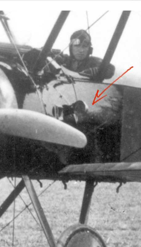

Sopwith Camels serving in the Italian theater had a field service mod carried out to fit 'funnels' to the carburetor air intake tubes, to increase airflow to the engine as they operated at higher altitudes than on the Western Front.
Barker's B6313 had both fitted.
