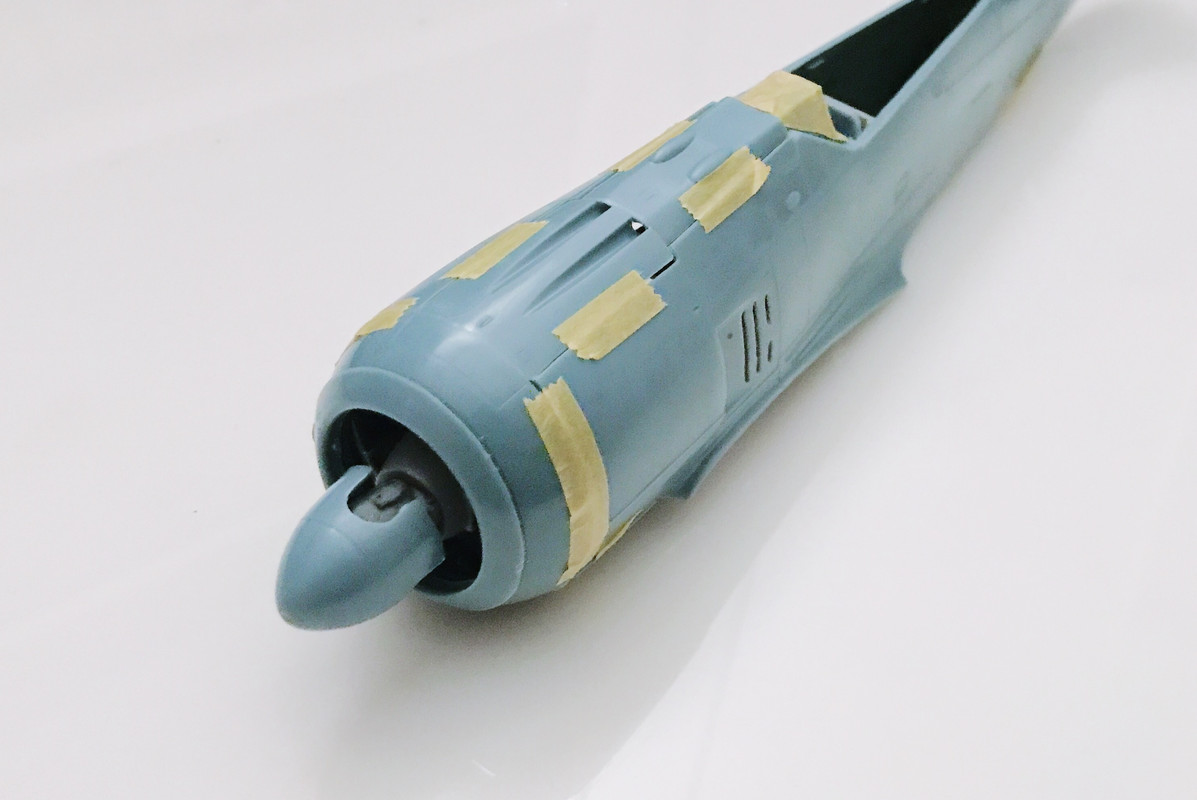

Fitting begins - cowling sections -
Not happy with the fit of the outer ring -

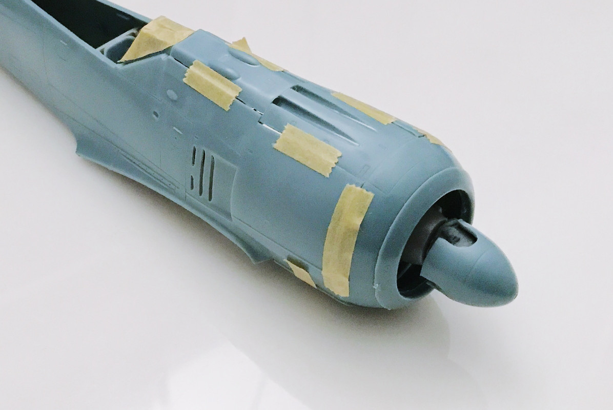

Funny with that ring... I have/had exactly the same problem with my Revells Fw-190, it just did not sit nicely..

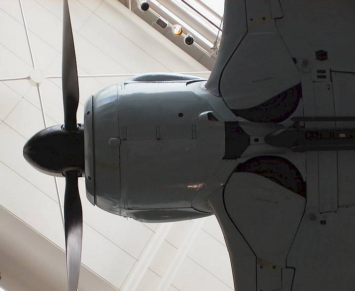

I guess this armour ring should fit as shown. Don't fill and sand it!

I'm pretty sure that armor ring doesn't sit flush but a bit proud of the cowling.

But perhaps reduce the sharpness of the trailing edge of the armored cowling ring a bit, as per Kari’s photo. Primer and paint should take care of the rest.

Regarding the armored section piece of cowling, “Wow!” Again, Thank you Kari, Thomas and Clint for your comments as well as advice. I was going to show you what was affecting the fit—there are well now there were because I eliminated them, two injector pins at the 3 o’clock and 9 o’clock positions inside that ring—both pushing the ring away from cowling, so I had to carefully, very, very carefully, dig these out. I would have, should have, photographed these pins, but it was just after midnight when I started grinding these away with Dad’s smallest K&S file.
Grinding helped, but I was hampered because the edge thins out and I did not want to lose the edge. So mindful of that, I flipped the piece over on my desk and trued the edge up as much as I could. I was also thinking that what needs to “sell” that armor ring would be a tight fit, bit not a smooth fit, if that makes sense.
