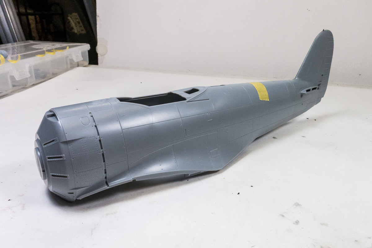

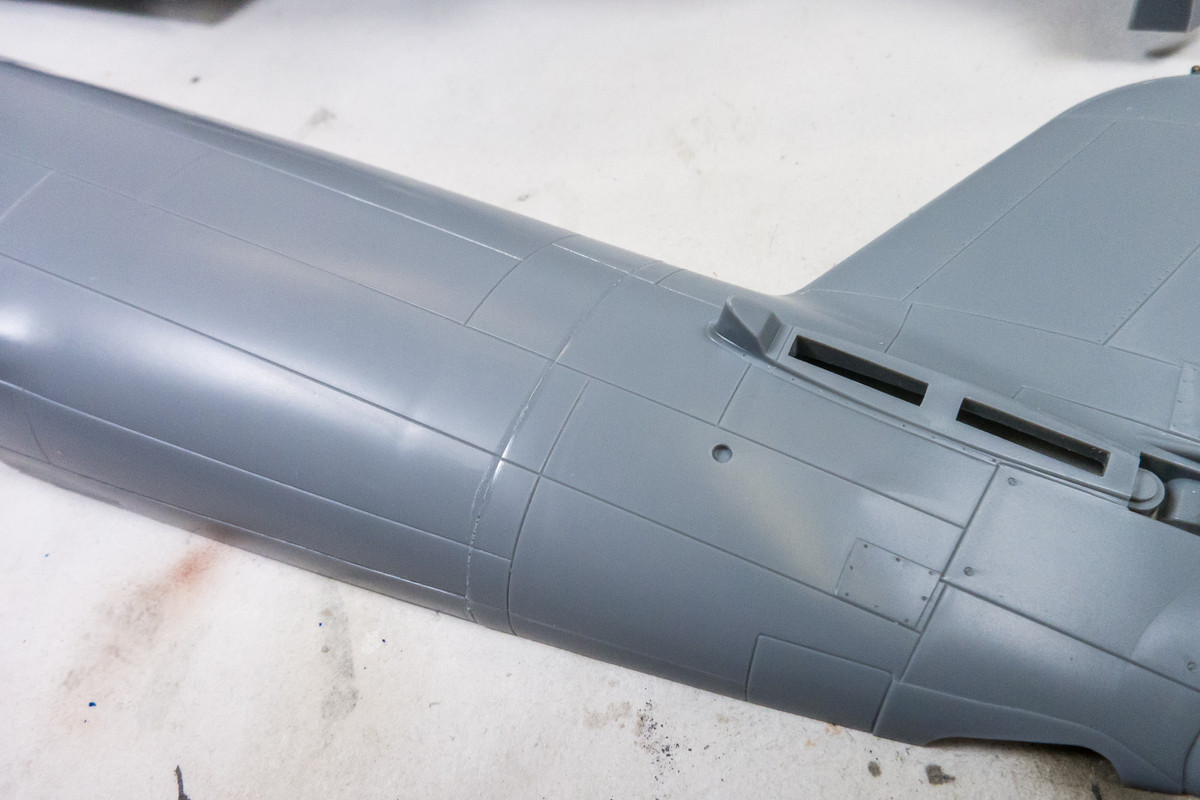

I've decided to glue the tail to the fuselage first to get a good join. It's much easier to take of this joint as well as possible now and deal with any top and bottom seam issues after the fuselage halves go together.
I'm trying to ensure a level joint all around and avoid any steps if possible.
Just a dry fit to make sure all four pieces go together nicely. After this dries, I'll fill in the joint like I did the wing inserts.

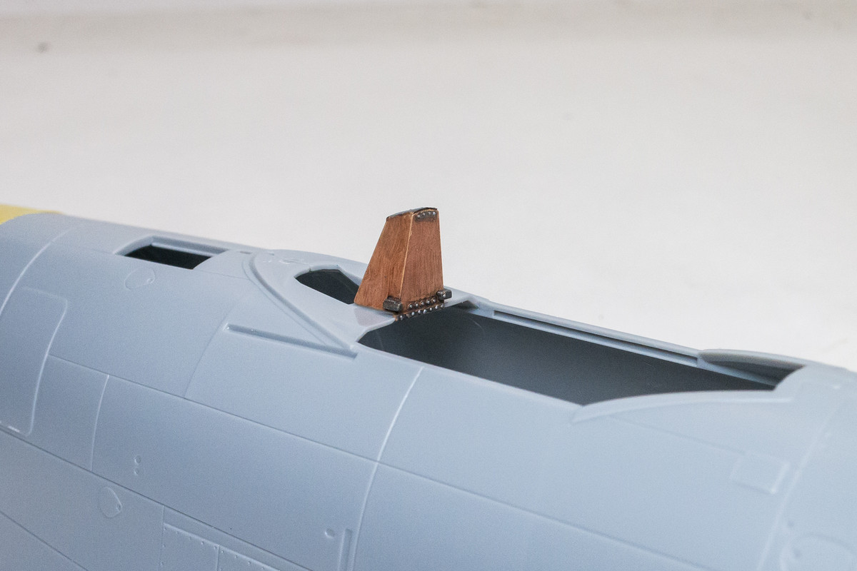

Back to some detail work... picking things that don't require to be painted in cockpit green since I don't have that color yet. The headrest is made of wood so I made a rough stab at simulating wood using oil paints.

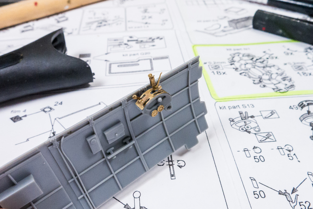

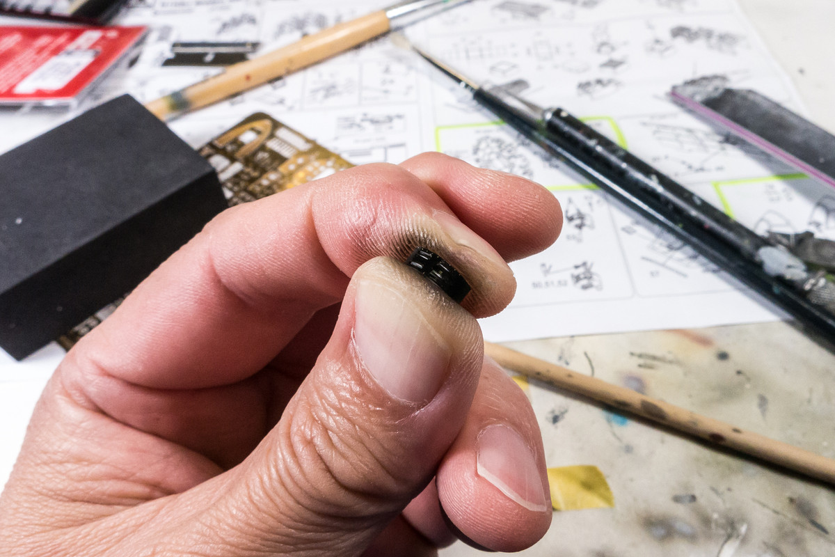

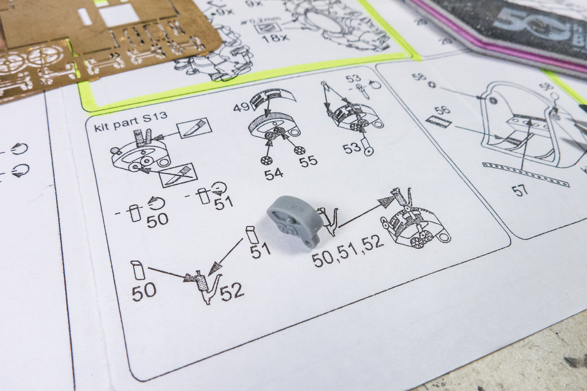

Next I tackle the throttle quadrant. First the molded levers are removed.
There is a PE piece with slots cut into it that covers the curved face of the throttle quadrant. Holding that PE part in place with my fingers, I shoot the face with black paint.
This creates a guide that I use to cut grooves into the throttle face that will correspond to the slots on the PE part.
So now the throttle body has some appropriately deep slots for the levers and throttle.
The various PE levers are glued into place. The throttle lever is an interesting pistol-grip shape. You can't see it but I've built up the handles of the levers and throttle with UV epoxy to give them a more rounded cross-section.
The throttle quadrant is placed high on the port sidewall and will be fairly visible. So these enhancement are well worthwhile.

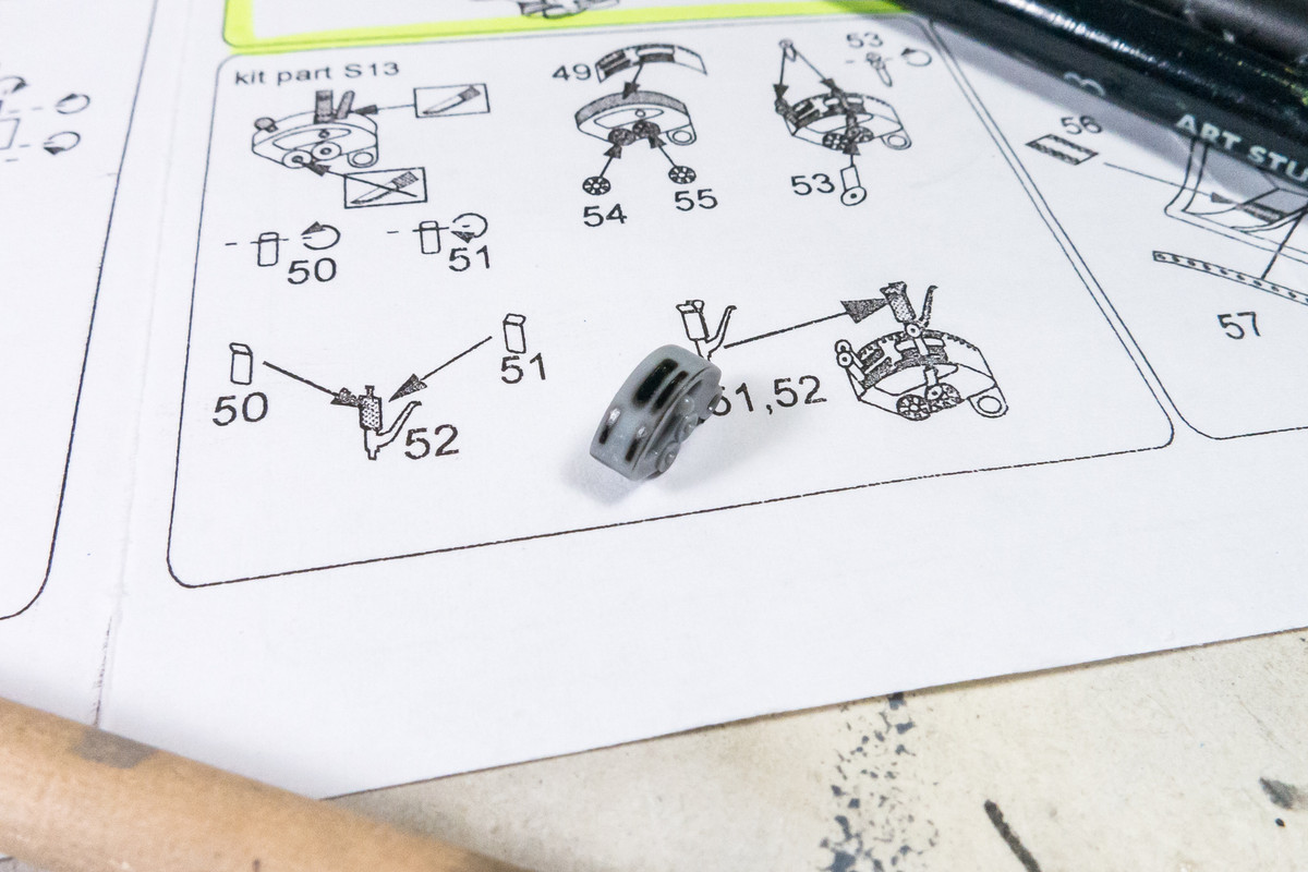

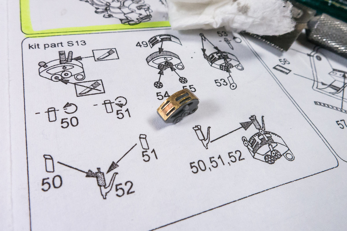

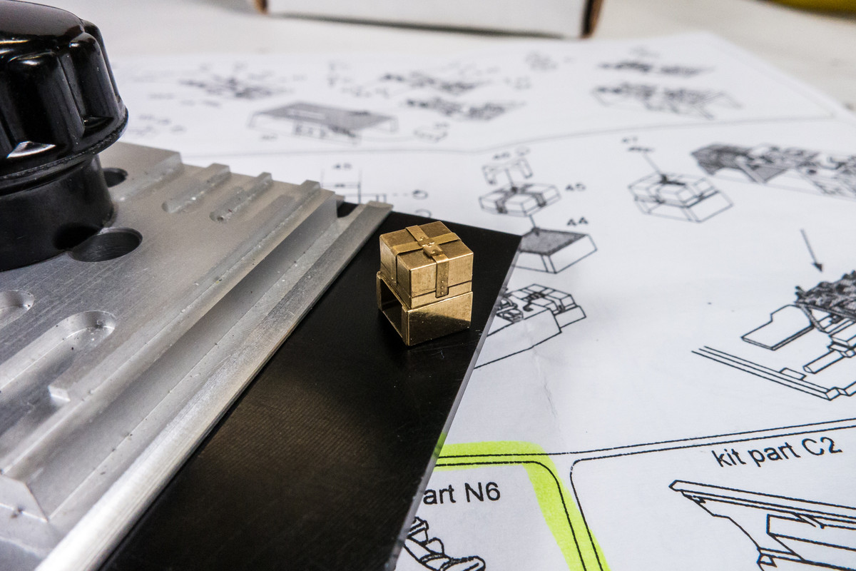

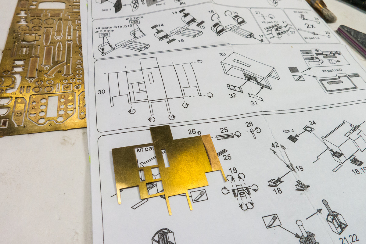

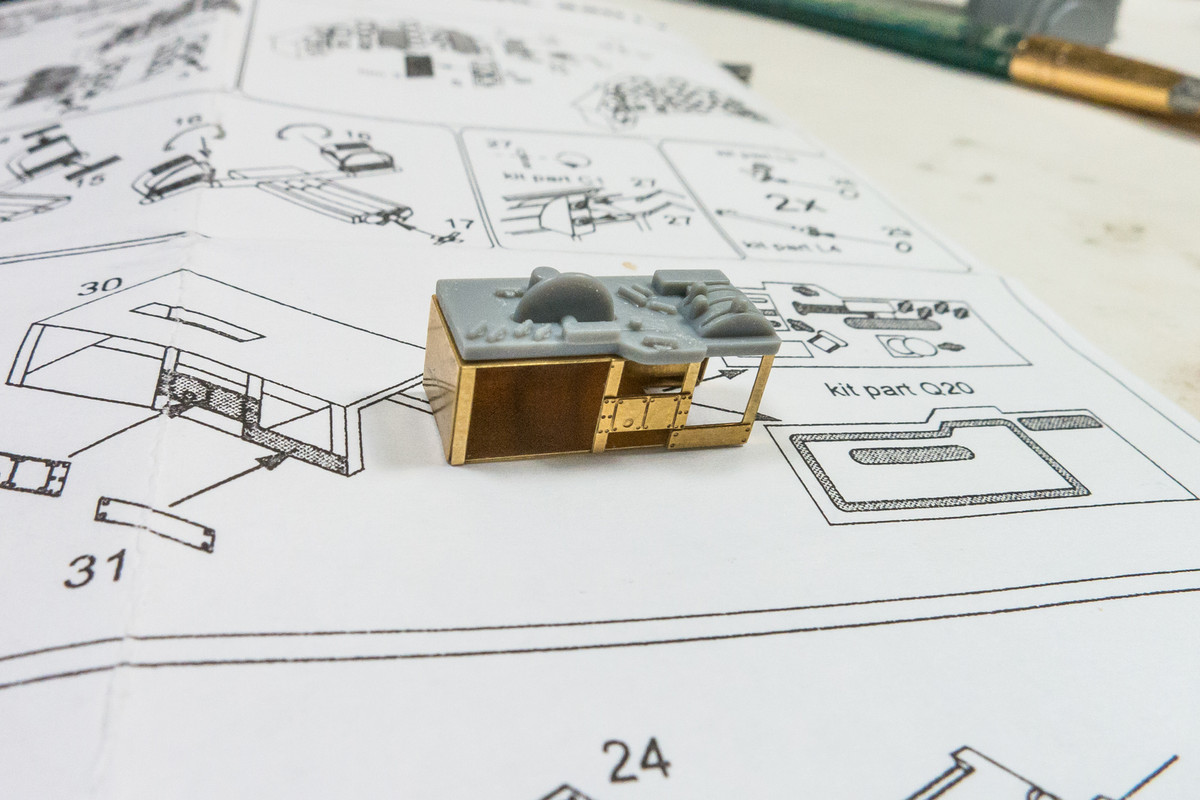

I decided to take a stab at folding the bigger box. It's not very complicated but the windows and narrow bits gave me pause.
The PE tool was used to initiate the folds but I would have to guide the final closure with my fingers.
Whew! That wasn't too bad.
The kit part goes on top of this structure but some removals, top and bottom, are necessary to accommodate the PE enhancements.

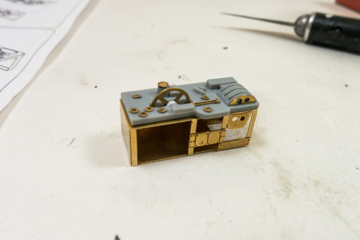

Re: 1/32 Hasegawa N1K2-J Shiden Kai

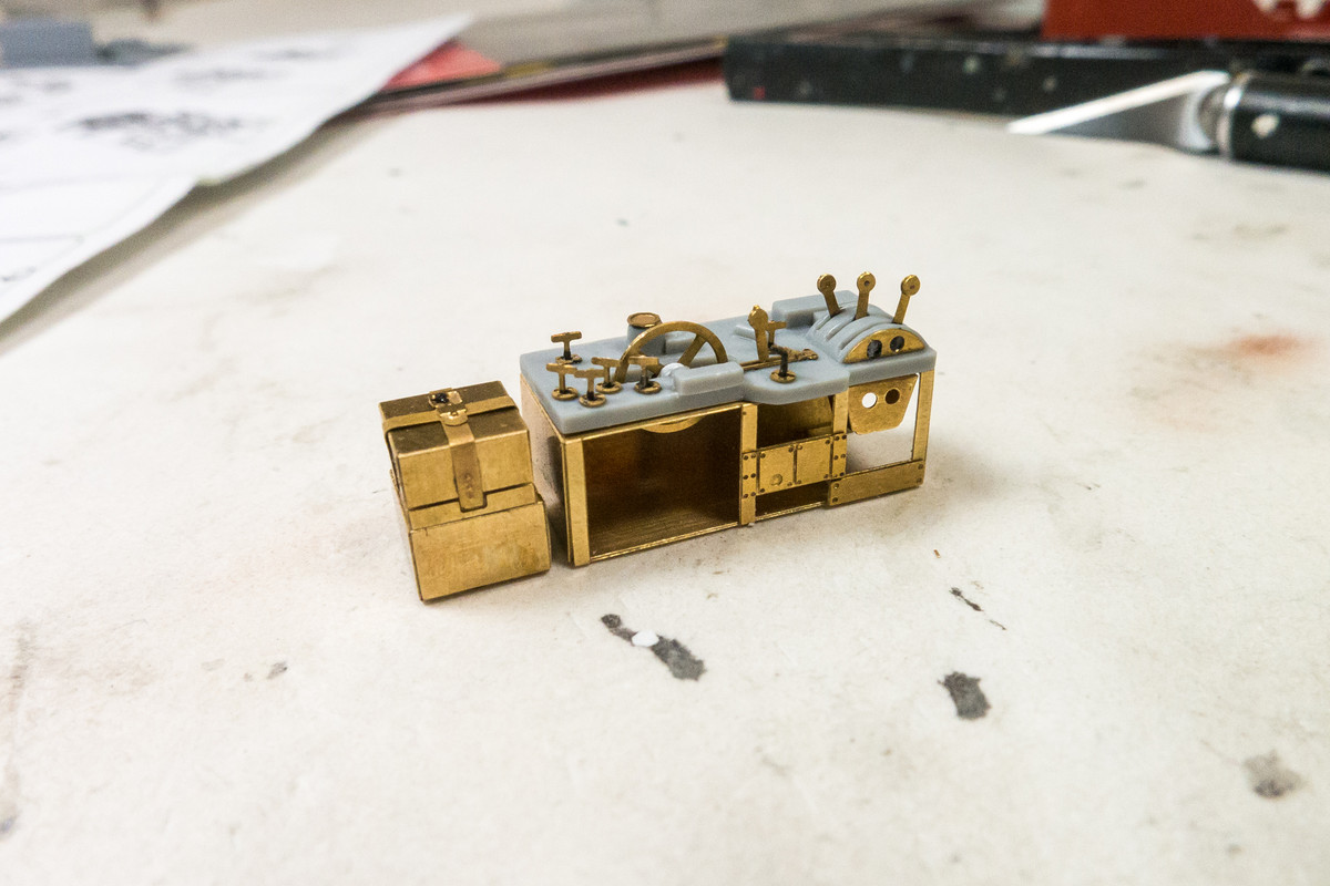

Since the two PE boxes came out ok, I sawed off the molded counterparts from the cockpit floor.
This is where a sanding tool like the David Union D400 comes in very handy.
With those structures out of the way, we can see how the replacement parts fit.
Brengun not only provides lots of small levers but the mounts, complete with a hole in the middle, to accommodate the new levers.

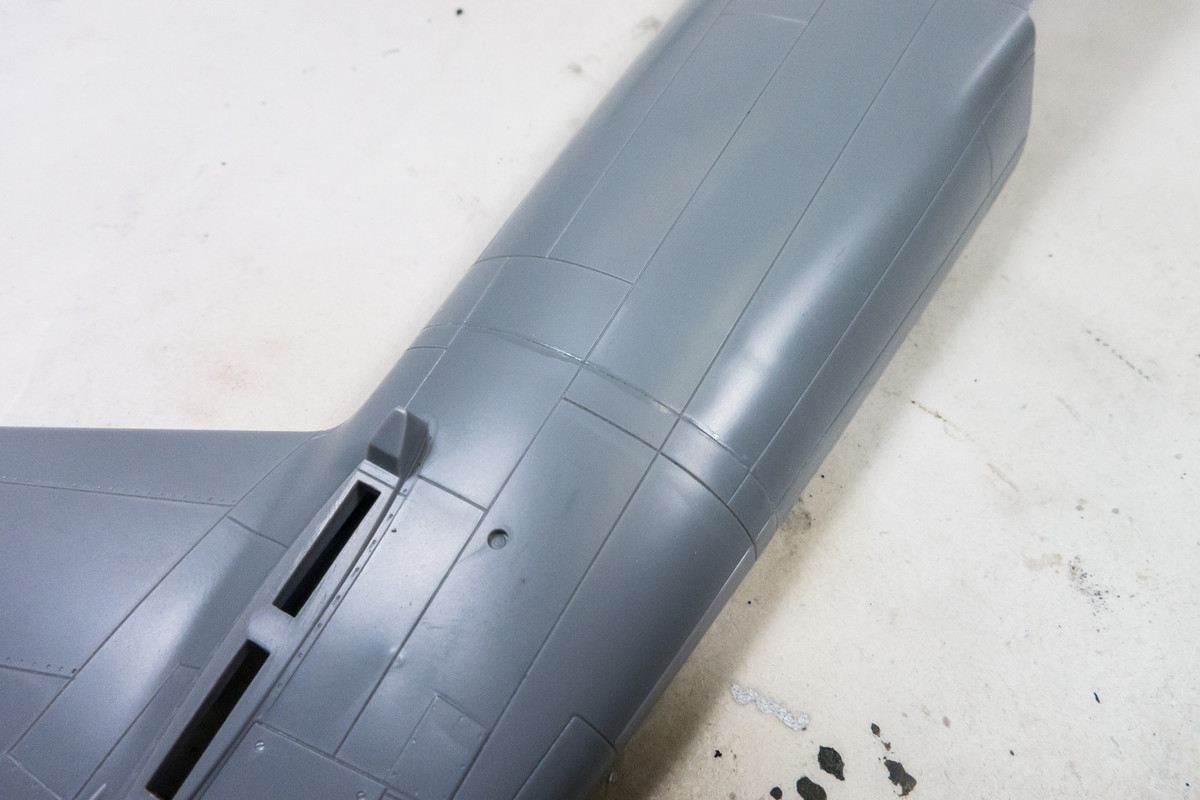

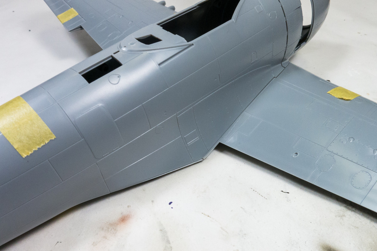

I've cleaned up the tail/fuselage joints and re-established the panel lines. Still waiting on the new riveter.
Lots of nice detail being added to the cockpit using the Brengun set!

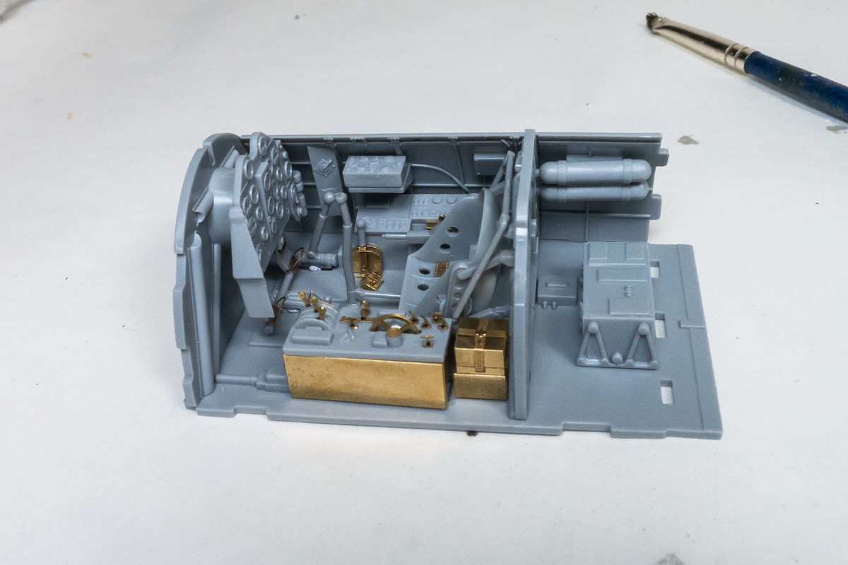

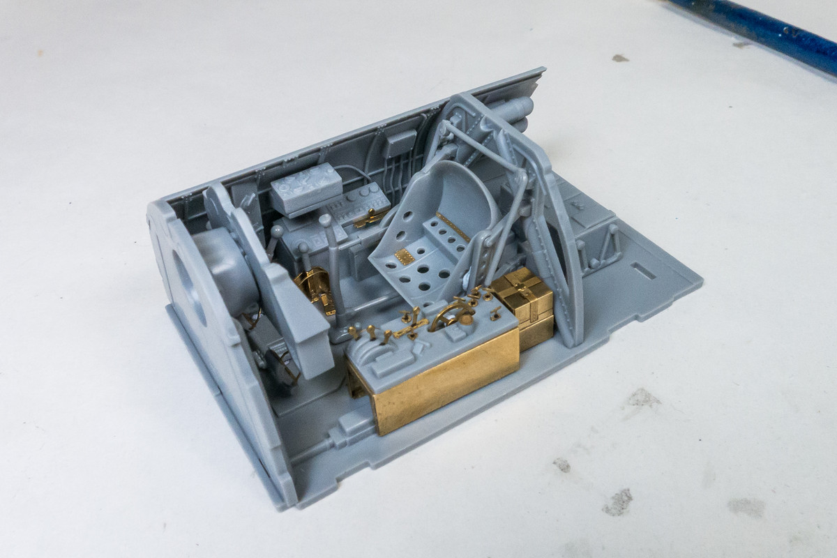

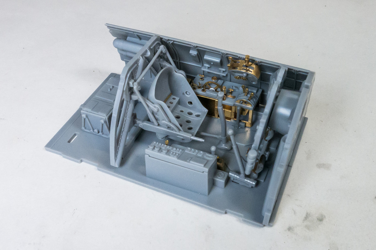

With the majority of the PE pieces assembled, if not permanently glued in or painted yet, I thought it would be a good time to dry fit the cockpit assembly. Many pieces are just sitting there so there is probably alot of misaligned and skewed parts. But it gives a sense of the scope of enhancements that the Brengun PE set brings to the table.
There is still lots to do in the cockpit including the photoetch and acetate instrument panel, seat harnesses, maybe some wiring and painting, of course.

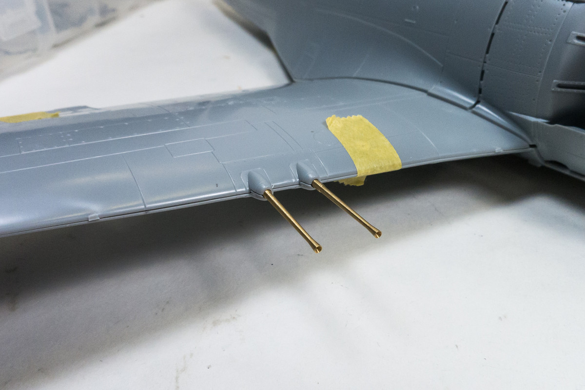

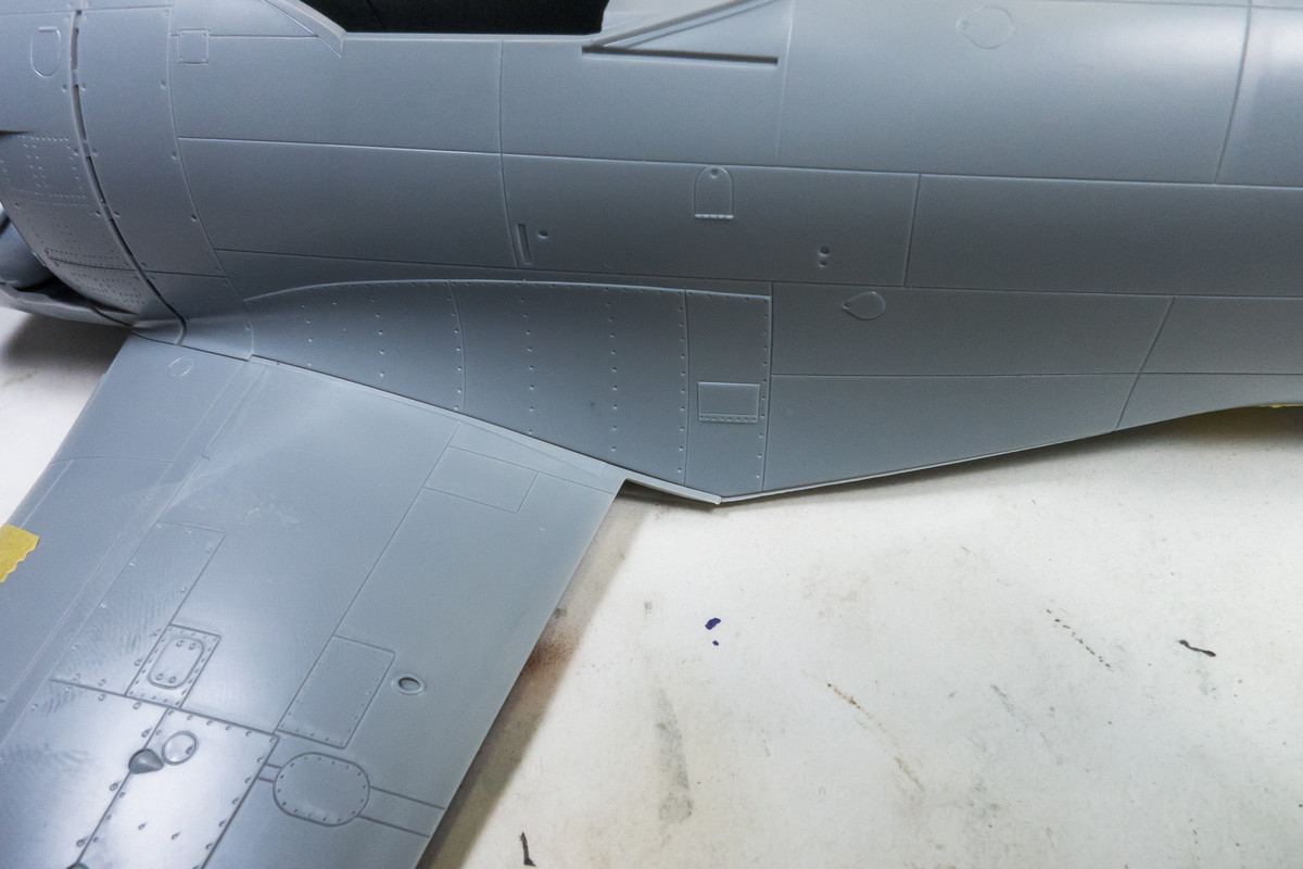

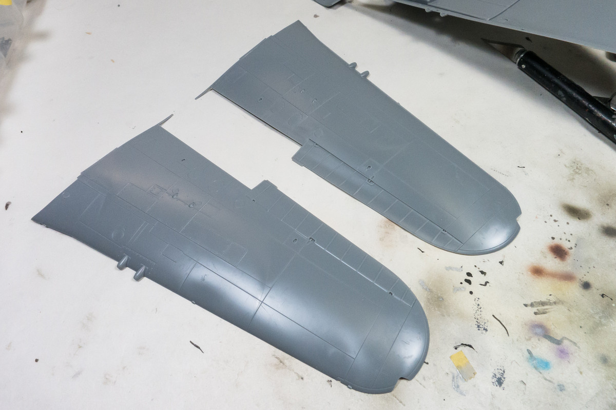

I cut the upper wings off their sprue. I was keeping them attached to protect that thin trailing edge extension that will probably get broken at some point in the build.
Rough fit with a few pieces of tape show a very good fit at the wing root. I do see a bit of that "underbite" along the trailing edge of the wing fillet that I've seen on other builds but that should be a very easy fix.
Checking to see if the RB Models brass gun barrels need any special attention for attachment but they seem to be a plug-in fit.
