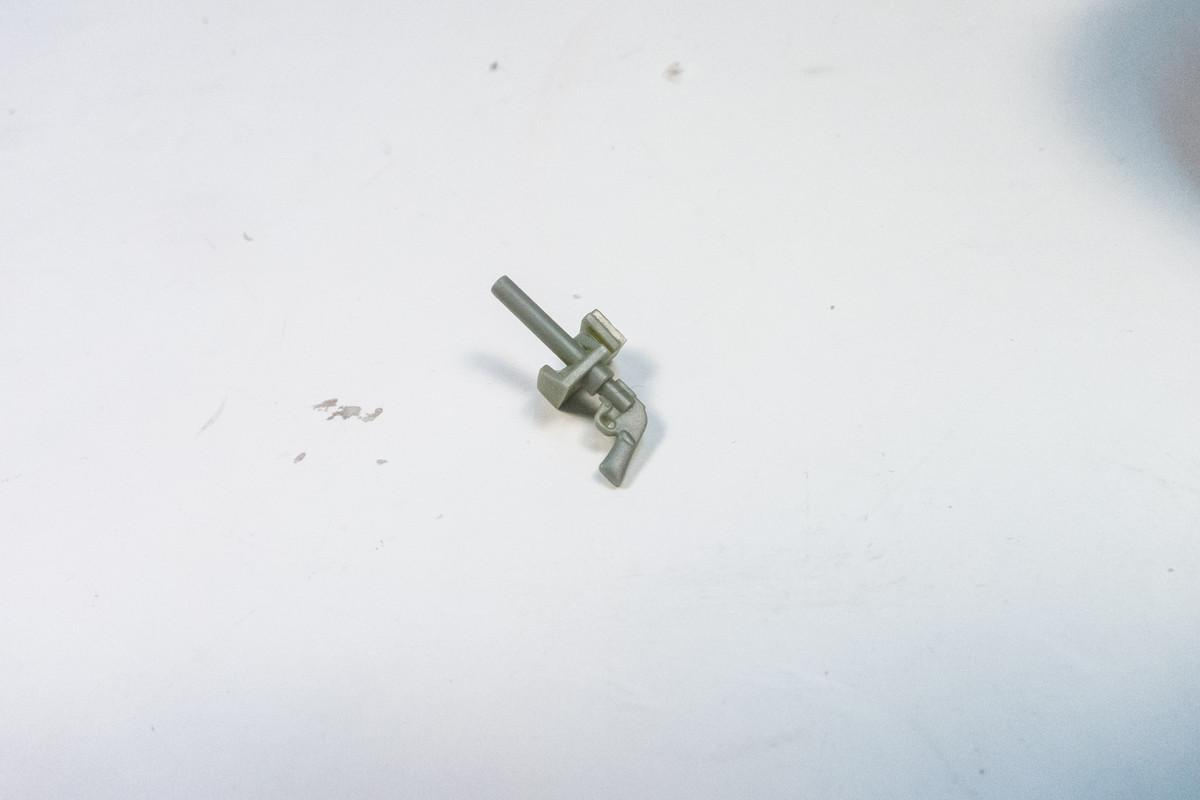

The cockpit of the Tempest has six flare holders and a holder for the flare gun as well. And I have this leftover flare gun from my Tamiya Corsair built that I left off. So... why not right? I'm surprised that more builds have not incorporated a flare gun and some flare cartridges.
I chopped off the body of the gun and glued on a piece of brass tubing for the barrel. I also cut two pieces from smaller diameter brass tube for a couple of flare cartridges.

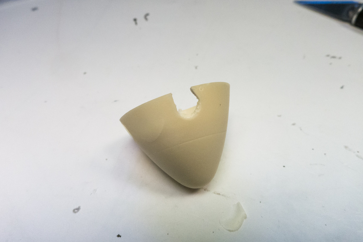

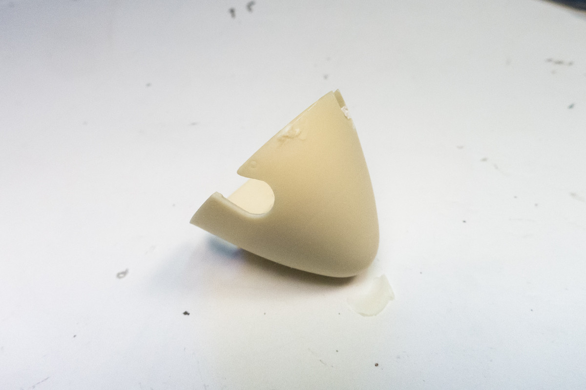

Before doing anything with the resin engine, I thought I'd check the fit of the spinner. There are some casting irregularities that need to be smoothed out.
One of the prop blade openings has a disfigured opening. Both flaws were easily corrected.

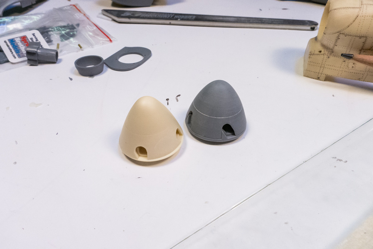

Re-shaping the kit spinner is harder than I thought. Here are the two spinners before I started sanding the kit spinner.

In stand-by mode on the Tempest build. Hours of grinding on the kit spinner and yet it is still far from the shape of the Barracuda part.
Can you even see any change? Well, here's what the spinner looked like before I started re-shaping it. It's a different angle but I think my effort HAS made the spinner less bulbous, no? I'll keep at it.

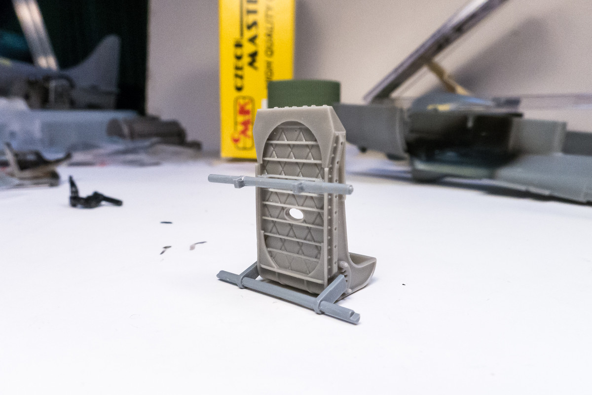

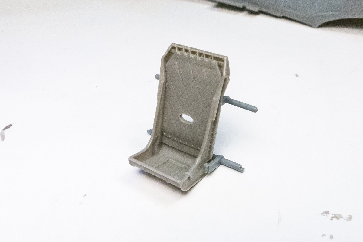

Took some time to admire the resin seat. Without knowing anything about the real seat, this one looks really nice to me with the fine stitching on top of the backrest.
Great detail even on the back of the seat.
Like most of the parts on this kit, the seat adjustment spring has a strong mold line running along its length on both sides.
I have the time so I am trying to eradicate all of the mold lines I can find. And something compelled me to rescribe the spring grooves with a fine saw.
