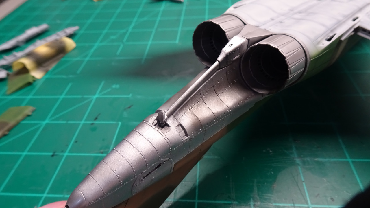

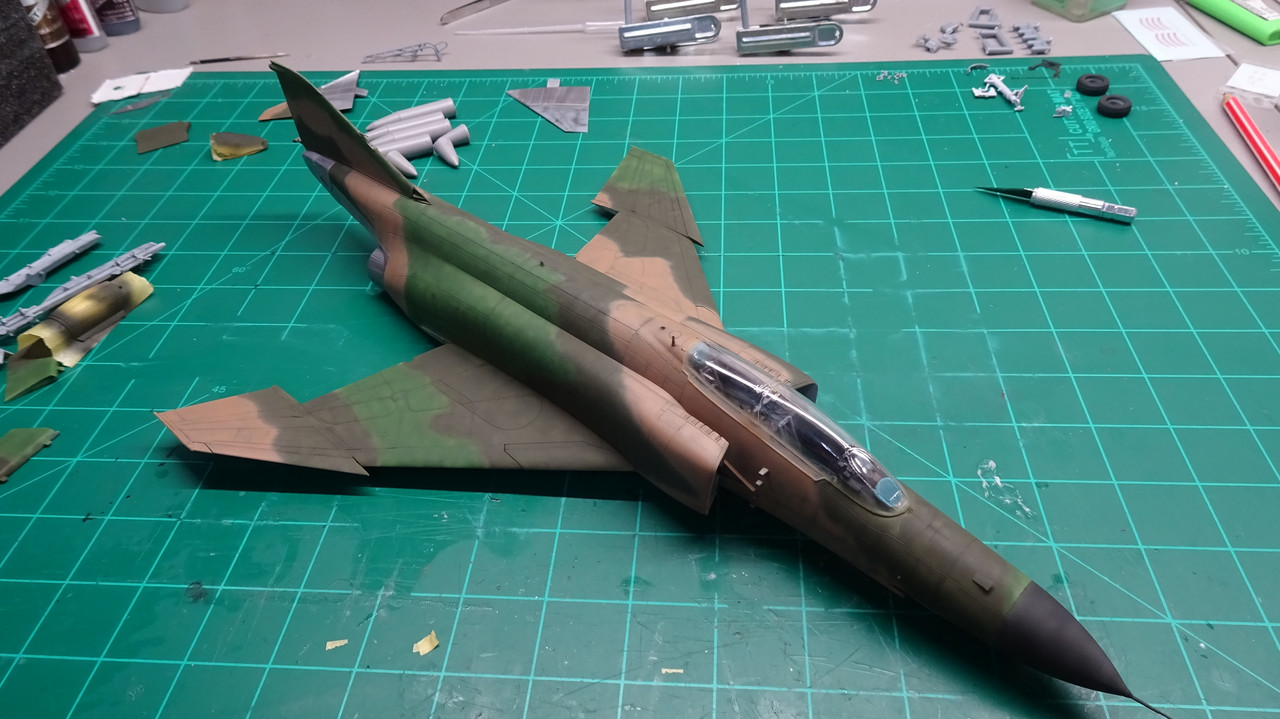

I have painted the Phantom!
Paints used was AK Real Color. AK Xtreme Metal and Alclad II was used for the metal parts. I had read reviews that AK Xtreme Metal was very fragile and even Tamiya tape detact first still lifted the paint. So I will not be using this again when Alclad is better and available at the LHS.
Using the one piece canopy as a mask for the cockpit

Clint great paintwork. The camo looks just right.

Thank you! I spent so much time painting yesterday with gloves on that I have a blister from working the trigger on the airbrush. I'm happy with the results

Outstanding! Will watch your video later on.

Man this is coming together rapidly! :shoutout: You already have the paint on!

Man that looks awesome! That's not good news about the AK Metal paints. I just got some. :headslap:

Mike the paint looks good just doesn't take too masking. Not sure what decal softener might do to it.

Great work Clint !
I find it very strongly done, painting the camo freehanded !
I am not sure if I would succeed in such, the airbrush need a really steady hand
PS. i did a test back in 2015 with Xtreme Metal: https://youtu.be/SnxLBb1Kaok

Thank you Kari, I had very lightly sketched the camo pattern on with a light green water color pencil so I could see where I was going.
You was really going at it with that tape too. How long did you let it setup? I waited about 2 hours. Could just be the chrome is more fragile than the polished aluminum
