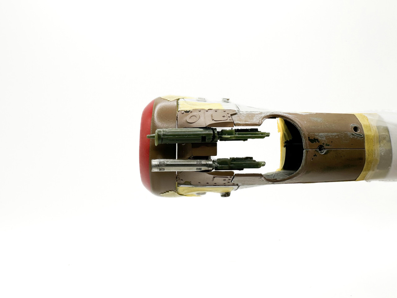

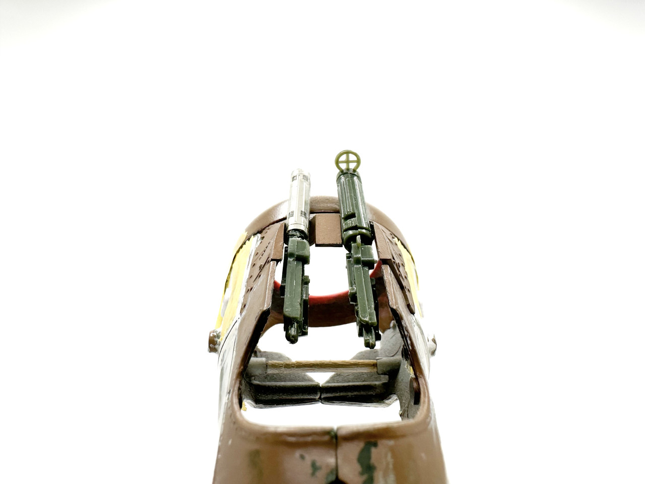

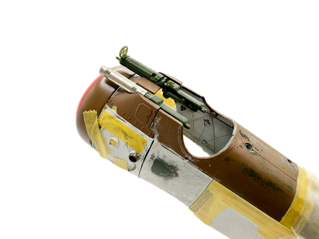

Oh hey now in a very smart move on Copper State Models’ design part, they created their photo etch from nickel-silver. You can sand and polish this. Here you’re looking at two of ten parts per gun, in this case the barrel wrap (aye, that was hard to do) and the barrel end is on but not visible in the photos (harder to do). The resin receivers were deemed too brittle so I’m refining the kit parts. I’ll be adding cocking handles and levers to the Revell parts. Lastly, you’re looking at side by side comparison with the kit part.

Oh, very nice comparisons. What a difference it makes. Bravo! This slowly makes me want to build my 1/32 scale Sopwith Camel this year.

Thanks so much, Tom, ya know based on the look of the Academy kit, what you own is a rejiggered Revell 1/28 to 1/32 and in many ways I wish I’d gone the same route. The scale choice they made is easier in terms of working arrangements.

Now you’re cookin’!!! :shoutout: Good idea to use the kit parts as the basis for the upgrades. Resin can be a pain to work with due to the brittleness that you mentioned. :hmm:

Time for some Crisco! It took 40 minutes to whittle down the kit part to sleeve the metal over it but that was worth the pain. Thanks, Carlos!

WOW Bruce - that's a huge improvement over the kit parts!

Thanks so much, Carlos! I don’t know why but it was very hard to form the flat etch into a circle. I had to use a metal rod and carefully press against a hard surface to coax the metal into a bendable shape. The next day I woke up and my left hand hurt and I had to ice it for about an hour on and off. The strain of forming that small piece of metal was formidable. There must be a better way. Also I think the 45 minute plastic carving session was part of the problem. I’ve been staying away from the second machine gun until I can figure out a better solution. It might simply be best to work in separate sessions; carving the piece first.

I’ve heard that by first heating PE, and then allowing it to cool off, prior to attempting to fold or bend the PE makes it more malleable. I’ve never used the method myself, but I don’t work much with PE either.
