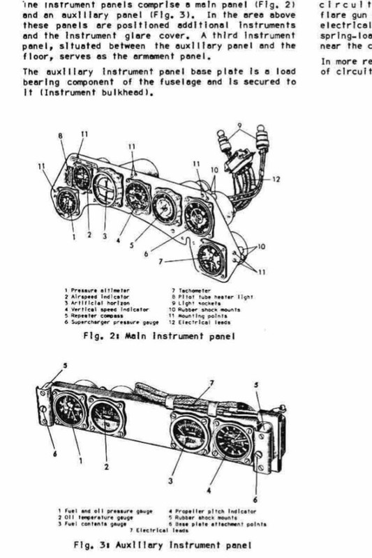

Dig this: the wiring loom explained on the IP! Pretty sure thanks go to Kari who told me to go here!
