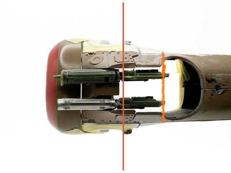

Without measuring, the red line looks like the spot for the instrument panel and the orange line demarcates where the gun butts end. Much closer with that last measurement than before.
