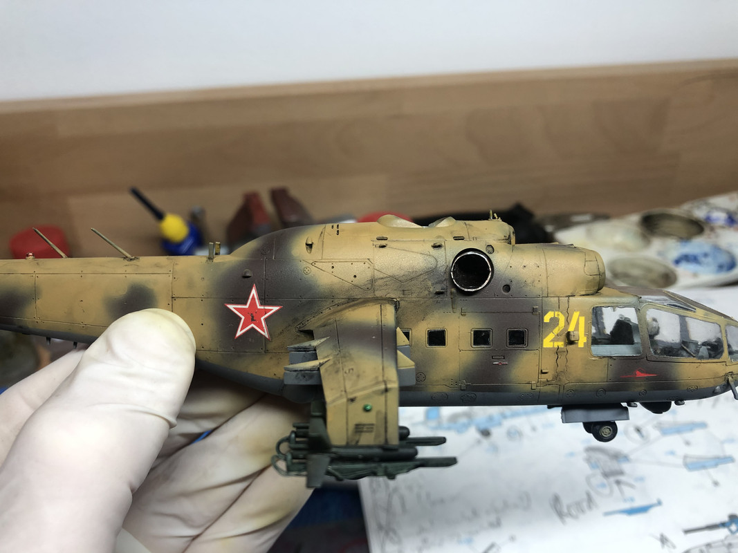

Working on the final touches. The Hind has gotten a wash (thinned artist oils) and a flat coat. I am doing the detail painting (lights, hatches, small exhaust) and adding some staining. I have seen the Hind at airshows and it can be a pretty dirty bird. The left and right side get dirty in a different way due to the rotation direction of the main rotor. I studied several pictures of different birds and left and right sides to see a typical pattern in the exhaust staining.
Here is how I do it (quick and easy)
The starting point:

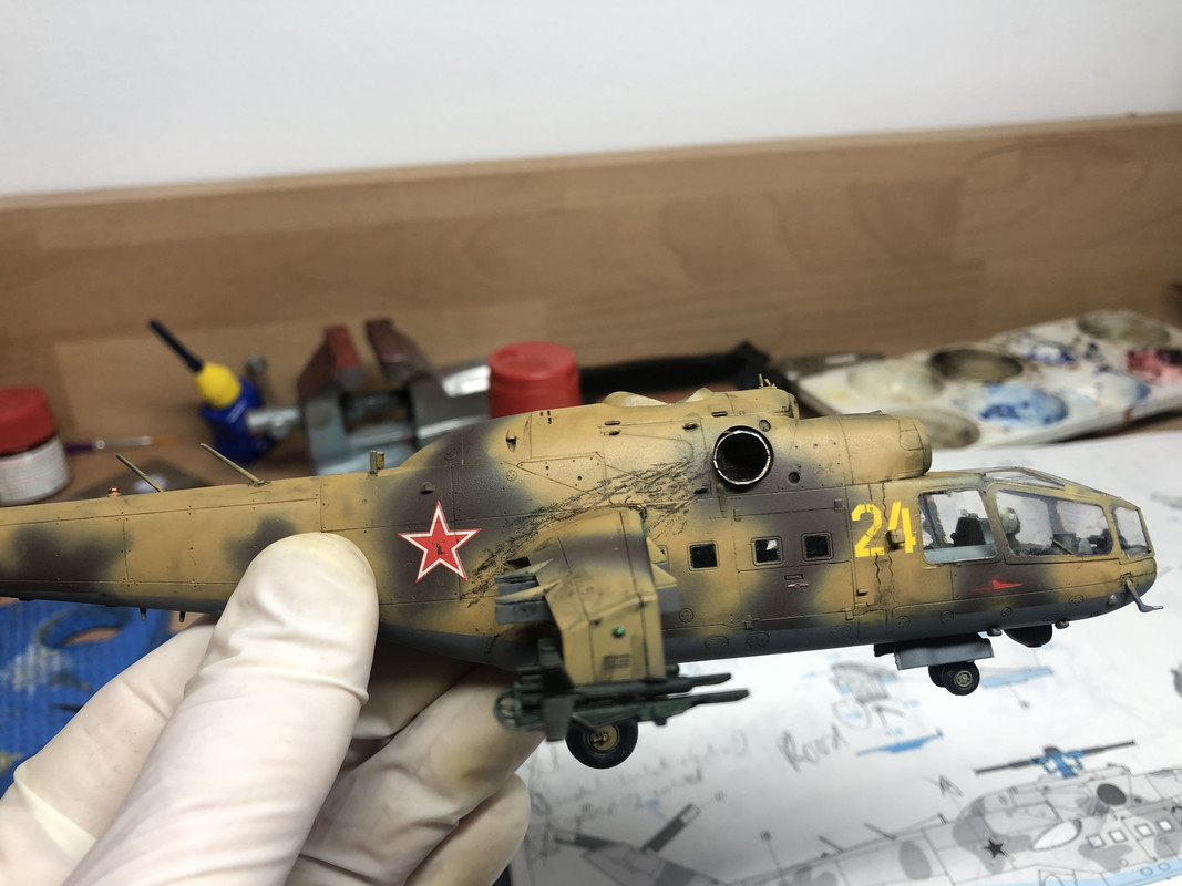

Step 1: using an artist charcoal pencil I add the saints in the direction of the airflow. It looks a bit stripey but that it dealt with in step two. Near the exhaust the stripes are more dense the further away.
Step 2: using a qtip/cotton ball I wipe over the stripes to make it one patch of staining. To much:remove with water. To little: repeat step 1. All in all this only takes a minute but I think it really adds some realism to the final model.
