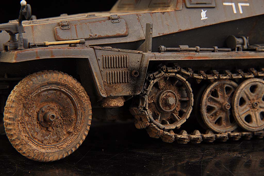

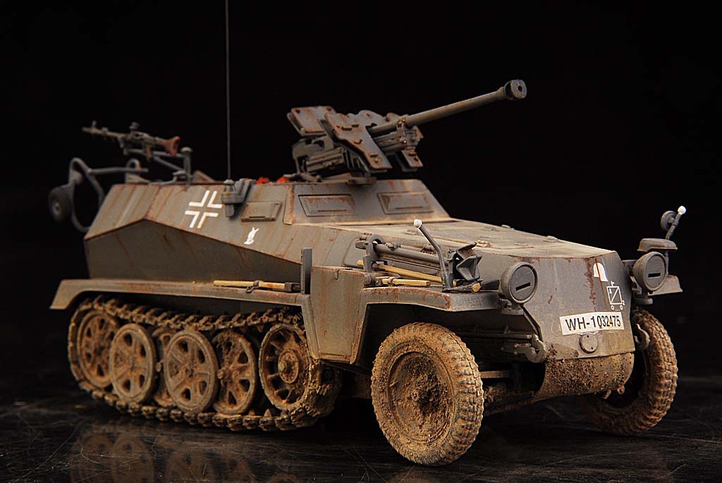

These photos are from "Dreamworks" on eBay. Builder's code name is "Volcano." These photos reveal the potential of the kit!

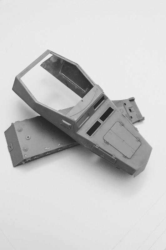

Kit plastic: I need to rethink. Yesterday I loaded Model Master primer in the airbrush and made three passes. The paint reacted badly—gummy and tacky—and refused to cure after degassing. I am in the process of gently stripping off sections, but I may have to go the brake fluid route to get rid of the primer in nooks and crannies.

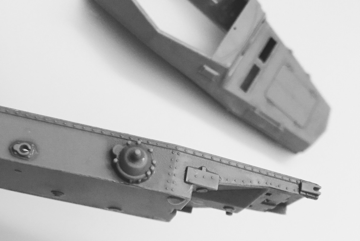

Thanks, Carlos! I sincerely appreciate your explanation, which makes a lot of sense. I am still bummed by the primer fiasco—as well as still figuring out how to clean everything. Plus, one of the sides popped open slightly...

Well stripped! But how did you actually do that?

Kari, thank you so much! Apologies for leaving out what I did, but basically this is an overview of how I stripped enamel primer from plastic. I soaked the plastic pieces in water, then used small sheets of folded 2,000 grit paper to start pulling off clumps of paint. I also use a little water at first to reduce friction. As the sandpaper clogs up I keep using it; the tack is actually increased. It is important to avoid bolts and panel lines and any soft detail areas and concentrate on flat surfaces. Then I let the plastic rest overnight. I actually let it rest for twelve hours. Since this was primer, I also soaked the pieces in vinegar for thirty minutes. Vinegar is my usual plastic degreaser before primer; not soap as this leaves oils behind. What worked really well here on the bolts, rivets and panel lines was toothpaste in an old electric toothbrush! That was how I finished stripping.
This is my variation on scraping to remove paint or in this case primer, followed by solvents, which would be the traditional methods. As far as time per step, it took me about 45 minutes to scrape/sand the flat exposed surfaces, then about five minutes to use the rotary toothbrush to polish the delicate areas.
