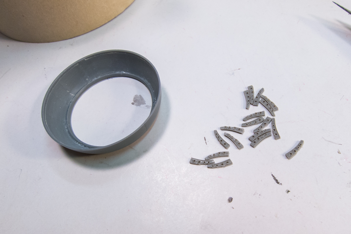

Got a chance to do a little work on the Corsair. Decided to work on the Vector resin cowling parts. The resin comes with small bulkheads for the nose cowling. So you have to remove the molded bulkheads first.
The major surgery was performed using my Tamiya snips like a pair of scissors.

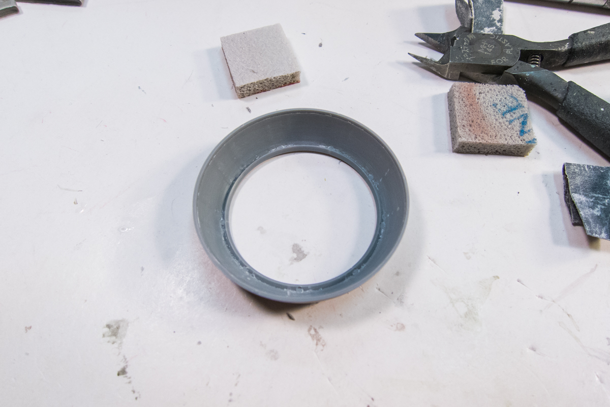

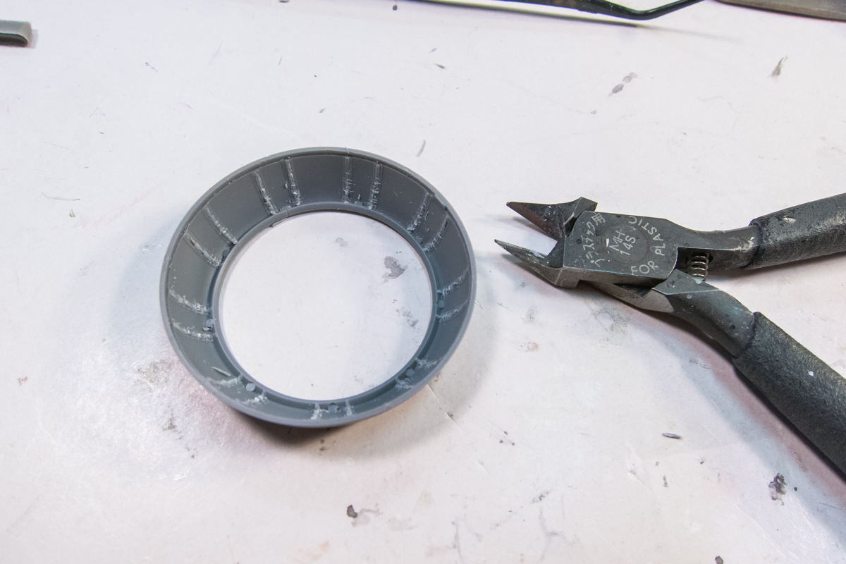

I then used a dremel to grind down the raised plastic.
The interior of the cowling was then sanded down with sandpaper and sanding sponges.

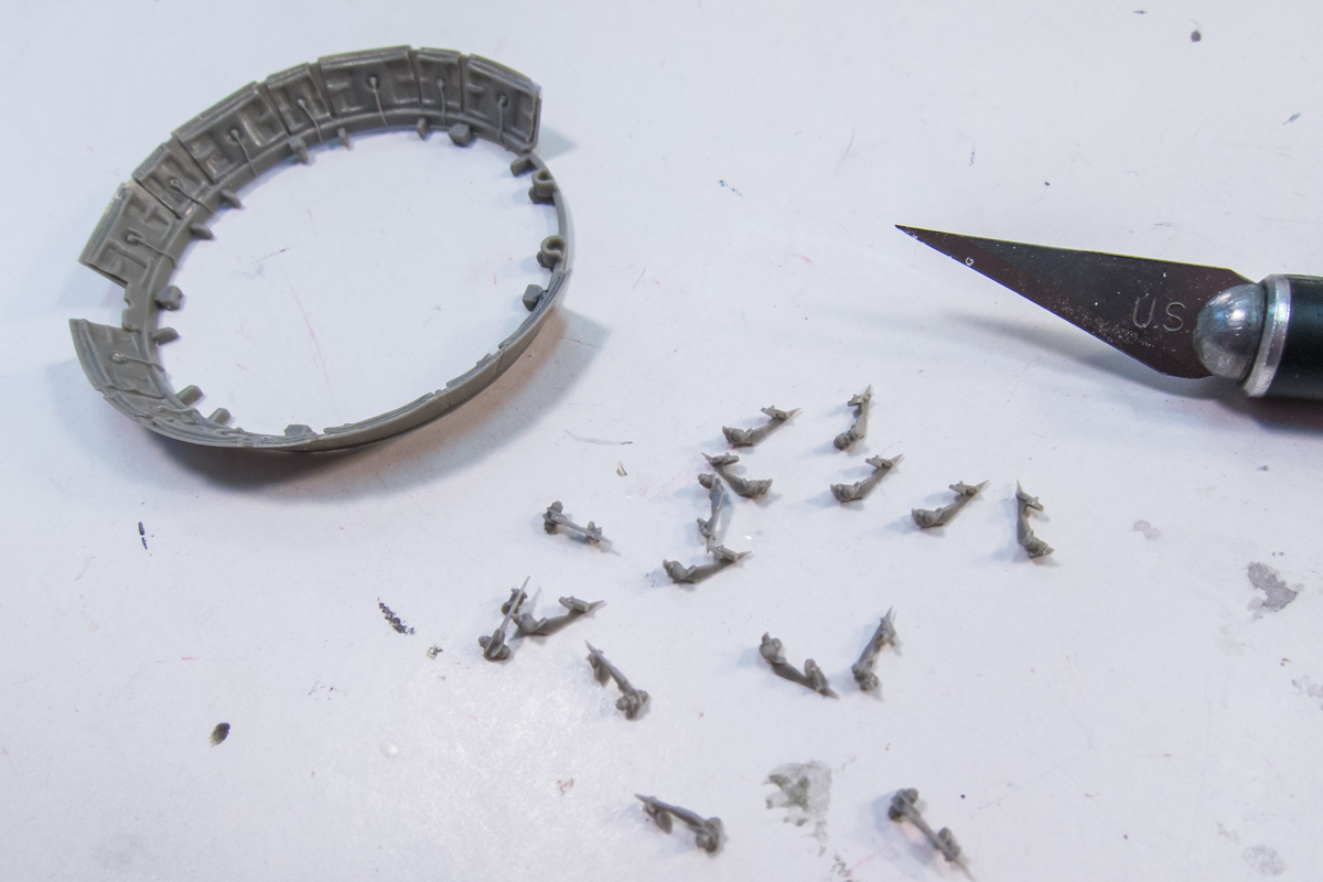

The resin bulkhead pieces were sawed off their casting bases.
I used CA glue for attachment. I'm not sure if this will be visible or noticeable once the engine inside the cowling but the additional detail is nice.

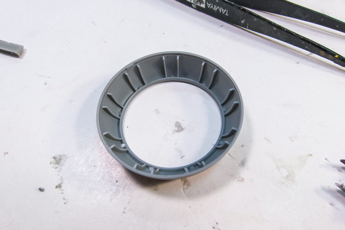

I moved on to the resin cowl flaps and decided to glue in the little actuator parts.
Stretched sprue was used for the cable that is strung along the actuators. I think this detail will be very noticeable and is a nice addition compared to the plain flaps that come with the kit.
