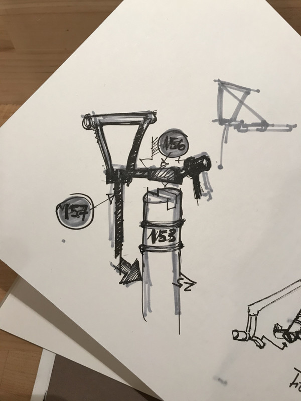

156 to 153 first then locate 157 to both 156 and 153. The key fit is 156 to 153 which is not on the angle as far as I can tell but in the center. This fills the gap the designer left in 153.

I’ve thought of that sequence. There will be a lot of dry fitting.

speedgraflex wrote:156 to 153 first then locate 157 to both 156 and 153. The key fit is 156 to 153 which is not on the angle as far as I can tell but in the center. This fills the gap the designer left in 153.
Oh this reminds me of drafting class... :wub: but drawn freehand rather that with all those fun drawing tools... lovely work!
Posts: 11358
Re: LyleW's C-54
Not to worry, Lyle—I want to be of service; and I still remember how I was frustrated by the Revell Horten instructions. I definitely think when manufacturers stopped using a copy editor to add a few lines of instruction that we modelers stepped into the gap. I know this happened long before Spam appeared in 2014, but the great strengths of the forum are its member narratives and just not being a place of judgement. So thank you both. One other note is that stepping into another modeler’s shoes is for me one of the most important lessons, and always helps me better understand another approach. I think your emphasis on construction and fidelity to the source is awesome, frankly. I truly do. And my only advice after sending that sketch was if I’m ever in this situation I take my white glue and either a toothpick or needle as an applicator, chuck the needle as applicator in a pin vise and glue the pieces with white glue first. That way I get the structure built with some degree of movement so I can adjust the angles. If the glue hardens too early it washes away with water. I’m adding this as a note to the drawing as it was clear the landing gear is really delicate and I would not want to jump to the permanent glue until as you write “fitting is done.”

Thanks, Bruce.
I did just that on the original pieces...whilst waiting for the replacement parts from Germany. Anyone know how long that takes?
May take a picture tomorrow of the gear. That pesky arm/rod piece god slip out if the notch, but there was a lot of old glue on it. Seemed to be more of what you might expect. It is also a very difficult fit in the gear well...if it will fit at all. Seems to be wider than the well. Judicious sanding required.
