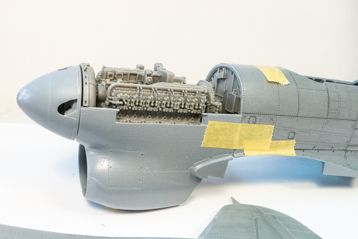

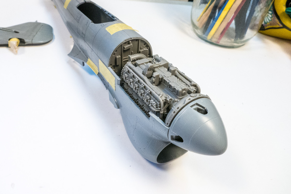

Still in a holding pattern while I wait for a new spinner to arrive. I decided to saw off the solid end of the kit fuselage to accommodate the resin engine. Using that big Tamiya saw, it's kinda fun sawing things off now. With that done, I can now do a very preliminary dry fit of the resin engine onto the fuselage. With the latest removal and the previous removal of the top of the engine cowlings from the nose section, there is a significantly reduced area for a glue connection. I was surprised I was able to get this to stay together with just tape and gravity.

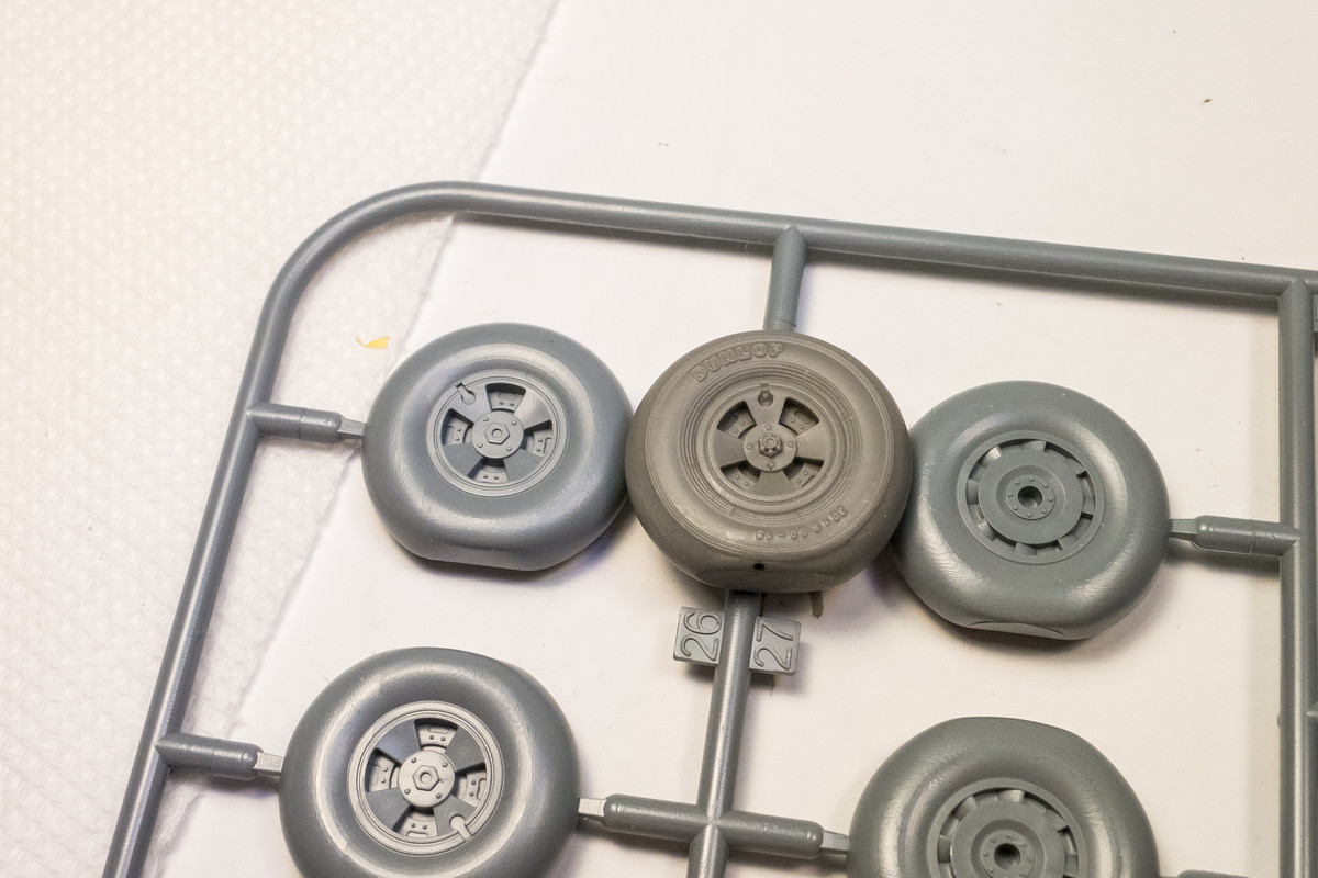

I played around with a few things on the Tempest build. The resin wheels were cut from their casting blocks, cleaned up and leveled on the bottom. They are represented as weighted with a flat spot and slight bulge around the contact area.
The kit tires are also weighted but the resin versions feature noticeably more detail on the sidewalls and hub.

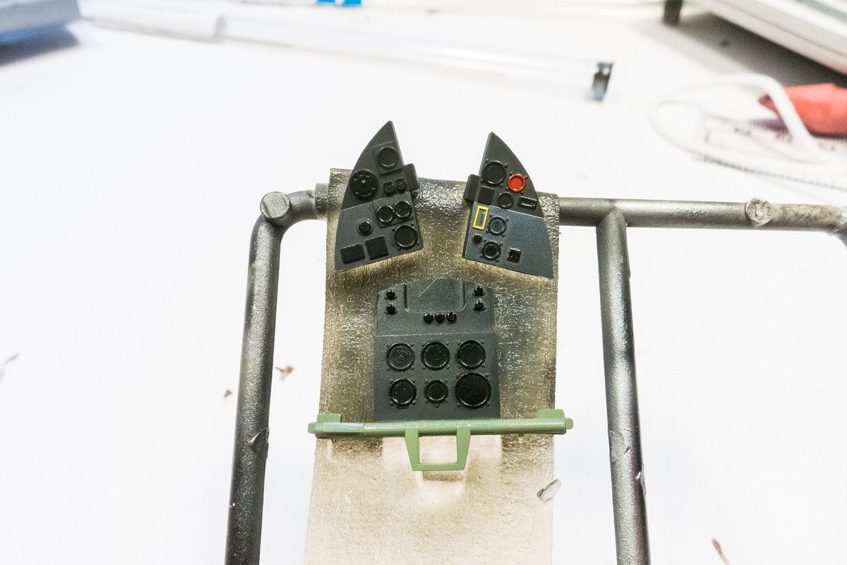

I finally received my cockpit color (Mr Hobby Aircraft Gray Green #364) so I thought I would tackle the instrument panel. It is provided in three parts and I've decided to keep the parts separate during the painting phase. Painted black has a way of sucking all of the detail from an area so I wanted to try and void that on the black instrument panel. The panel itself was painted Tamiya Nato Black, which is actually a black green color. The instrument dials were then painted straight black. I painted one of the dials red based on the reference photo I am using. The yellow box wasn't necessary as the decal already has this depicted.
The Special Hobby decal sheet provides the instrumentation as decals. It can be difficult to align these instrument panel decals so that the instruments fall into their appropriate dials. Separating them into smaller sections helps but I went the extra step of punching each of the individual instruments and placing them one by one.
After the instrument dials were put into place, the instrument panel was given a flat coat. I normally like to drop in punched disks of clear acetate for each instrument but I didn't think the raised bezels were high enough to accommodate acetate. Instead I just applied a drop of Future into each of the dials.

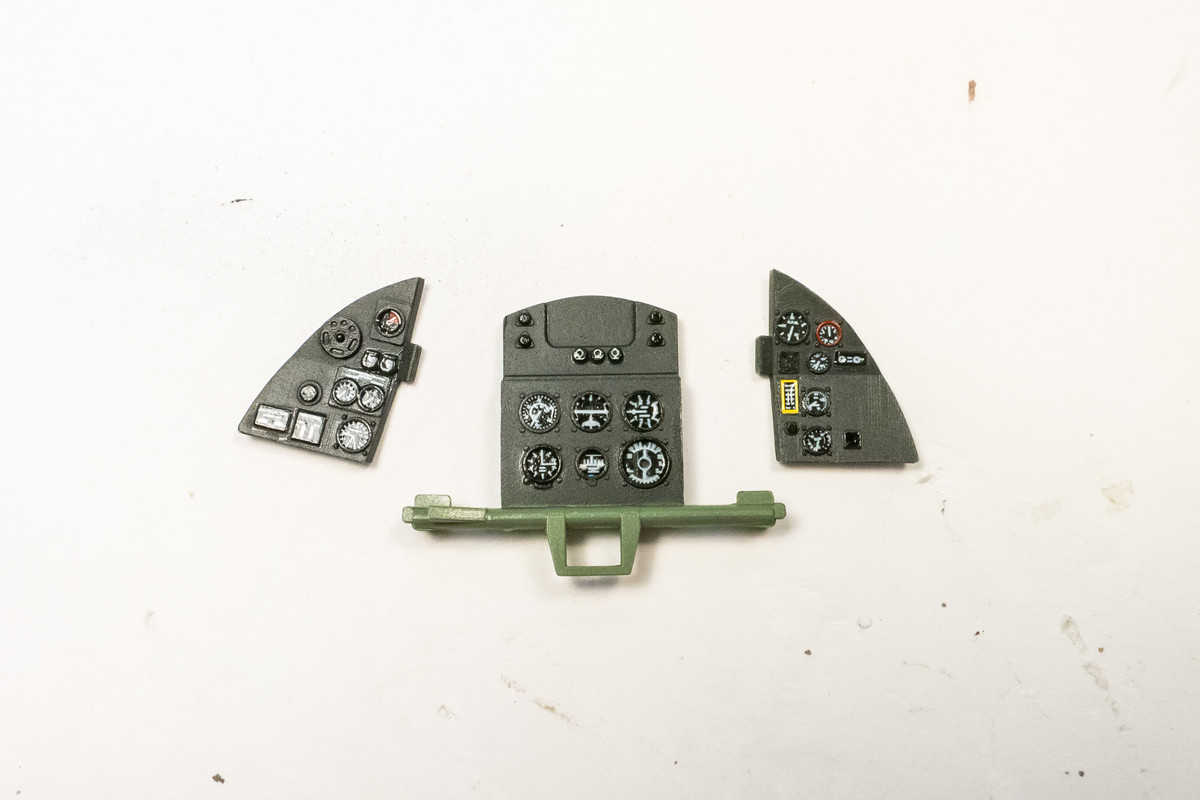

I've added some weathering to the instrument panel: light dry-brushing of silver on the edges and brown wash on the green cross bar.

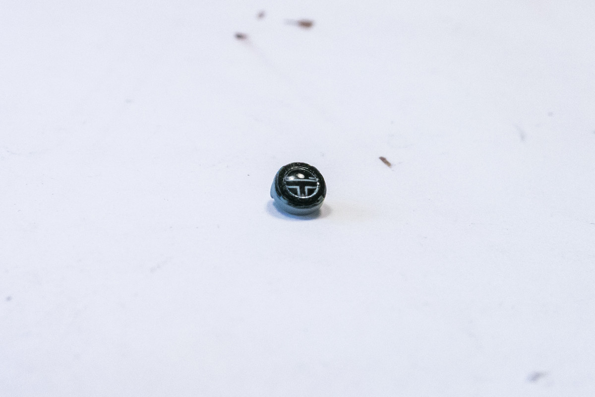

The compass has been painted and decaled. Topped off with a drop of clear UV epoxy to simulate the glass element.
Here is the completed instrument panel.
