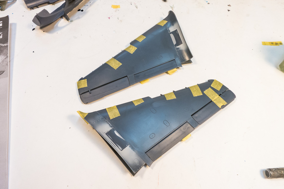

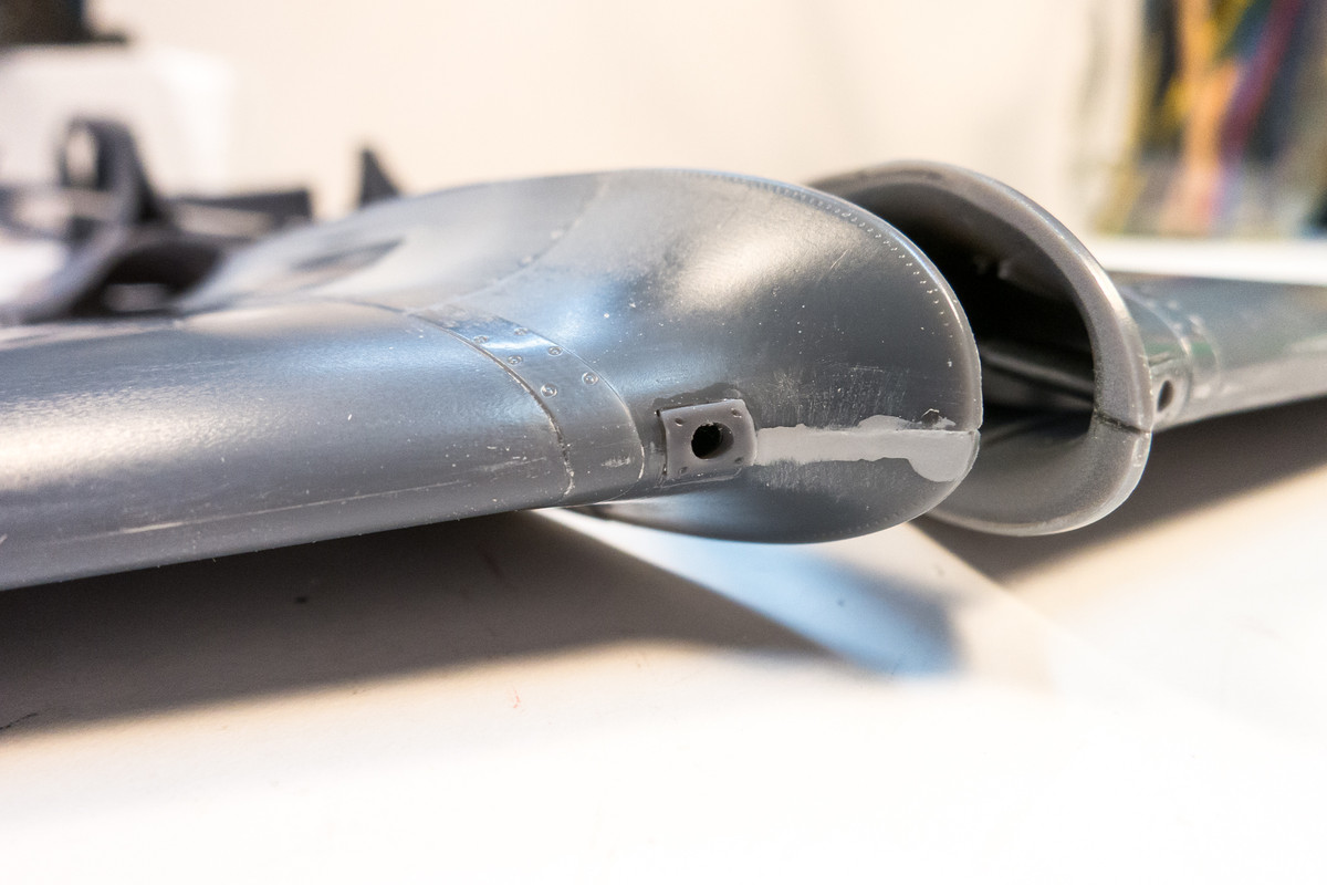

I've painted the guns and gun bay black and glued the wings together. The control surfaces are pin-mounted and therefore semi-posable.
The cannon openings in the wings are separate parts, which thankfully fit well.

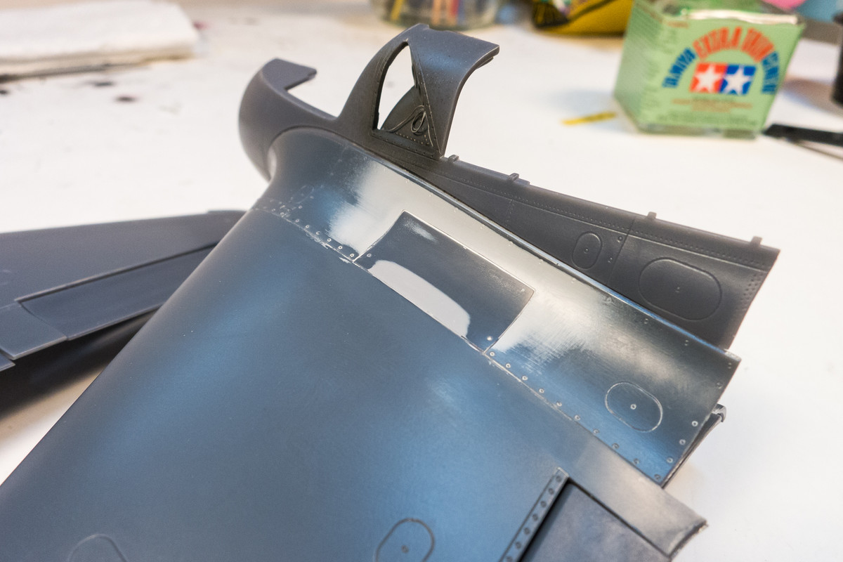

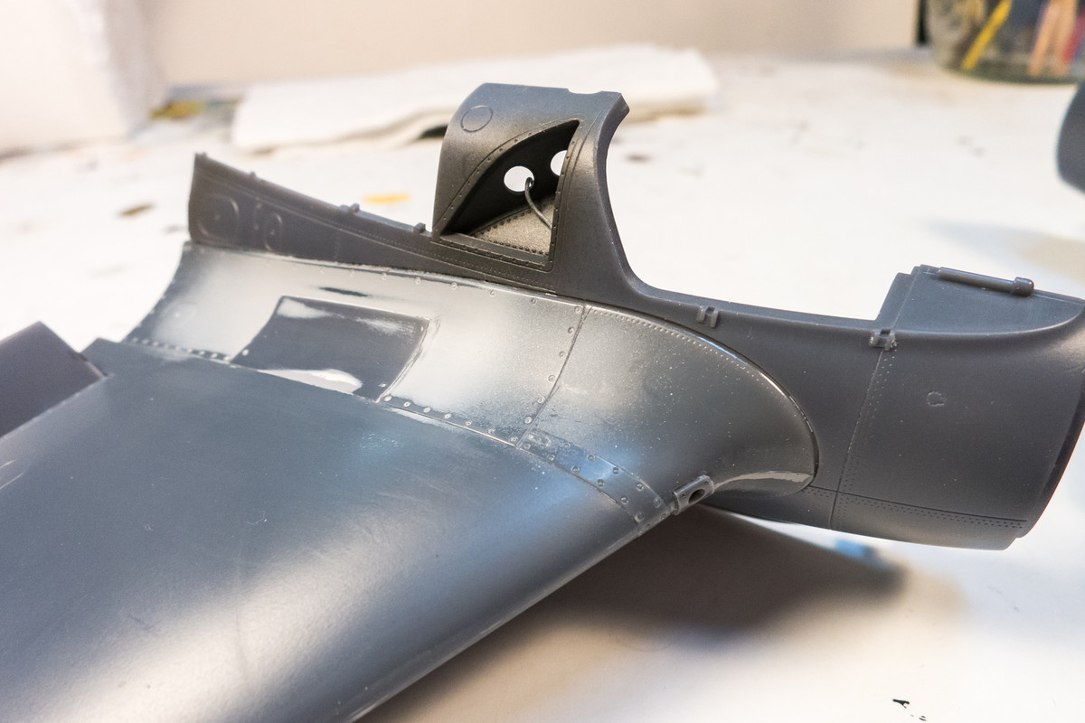

The wings are then glued onto their respective fuselage sides. To ensure the best fit possible, I've elected to fully glue in the top seam first and let it completely cure before applying glue to the bottom seam.
Fit is very good and it seems like this deviation in construction order was a good call.

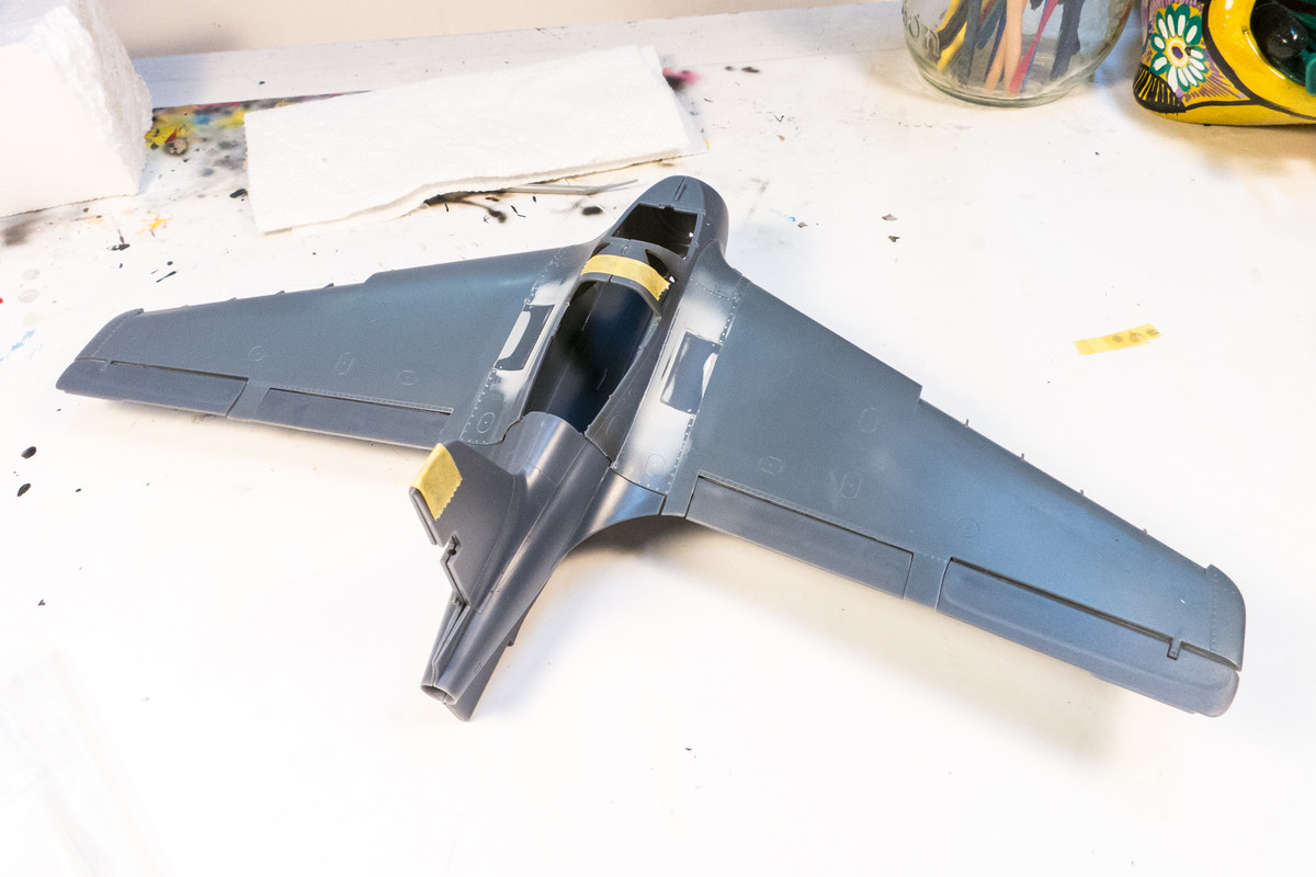

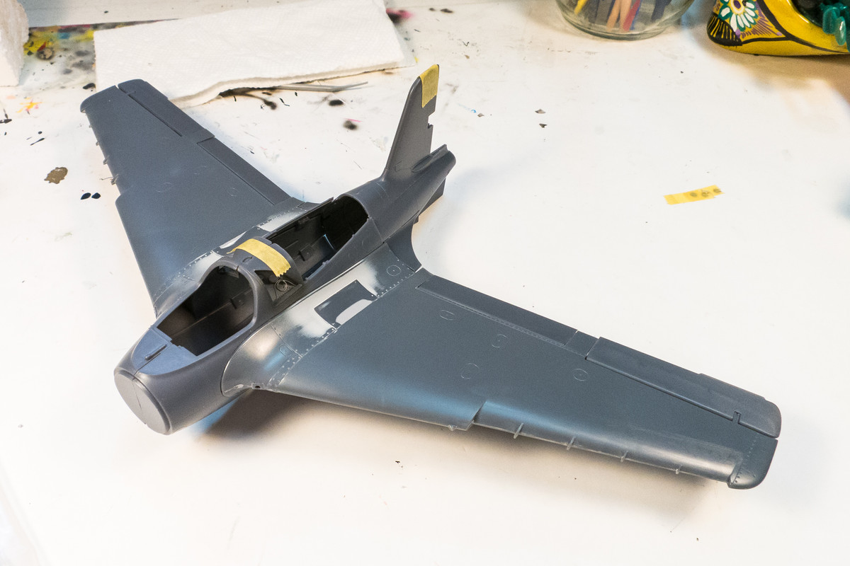

A quick pose with the fuselage halves taped together and the tail unit slid into place.
Keeping in mind that my aircraft will be fully buttoned up, there are a bunch of interior components that need to be added besides the cockpit and I need to figure out... (a) which internal parts are structurally necessary or beneficial and (b) if and how these internal parts will be painted.

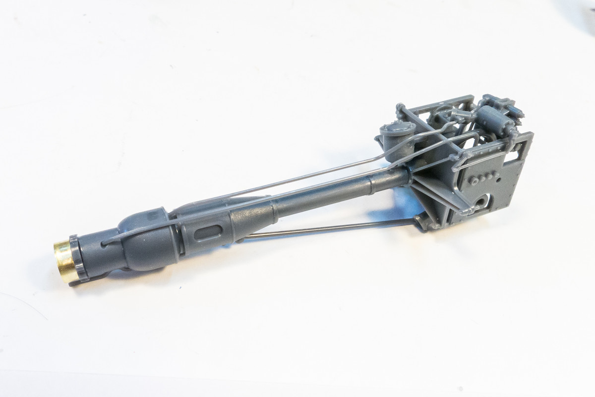

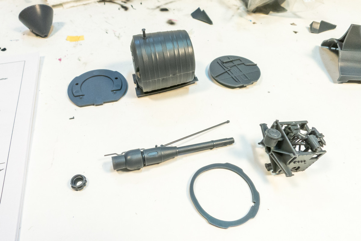

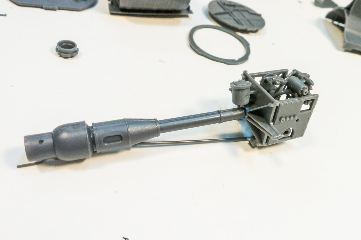

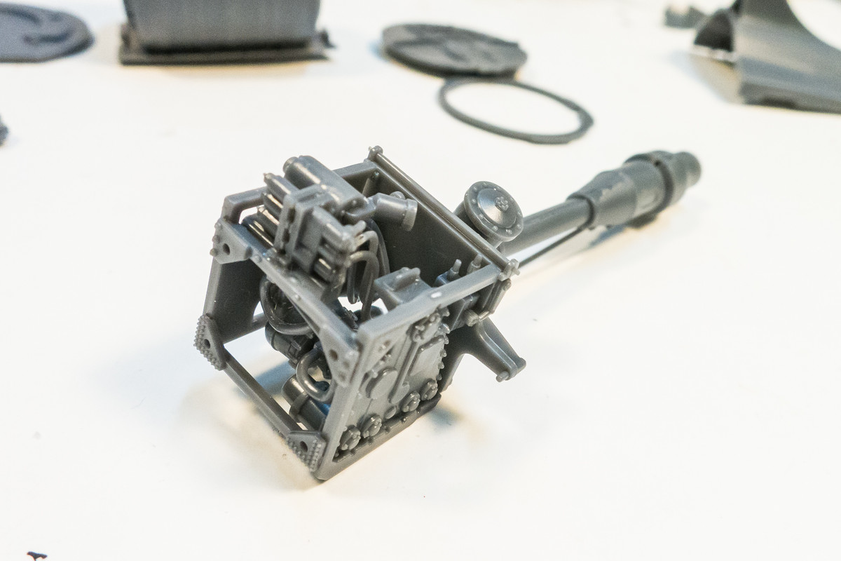

Thanks guys! I've assembled some of the internal components including the big fuel tank behind the cockpit and the rocket motor assembly.
The little rocket motor is impressively detailed right out of the box. This includes some very fine hydraulic lines, separately molded, which I rarely see on an injection kit. The rocket motor is attached to the fuel tank, which in turn butts up against the rear wall of the cockpit tub. I'm assuming that I'll need all of these in place to ensure that the motor nozzle is in the correct place, which will be only visible part of these recently assembled parts.

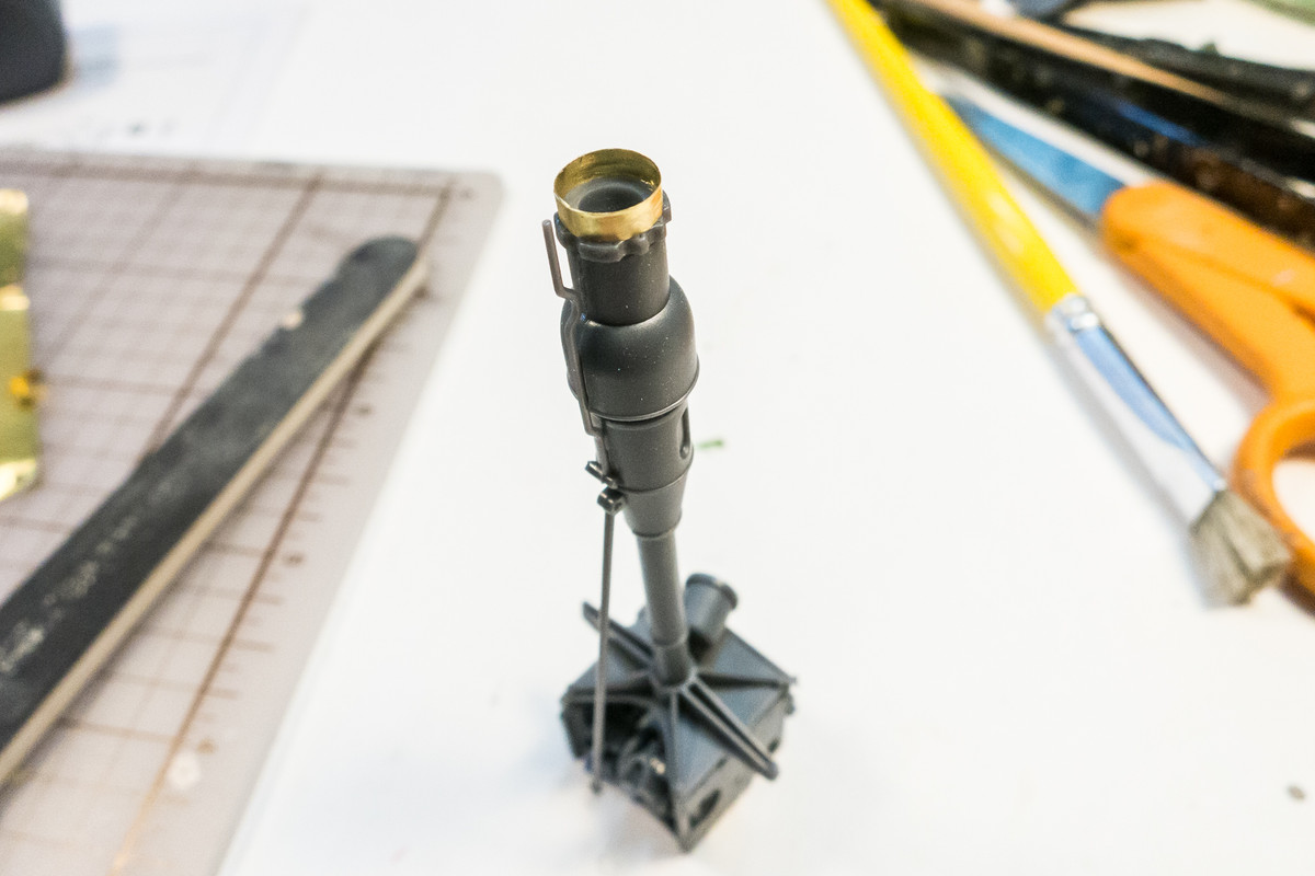

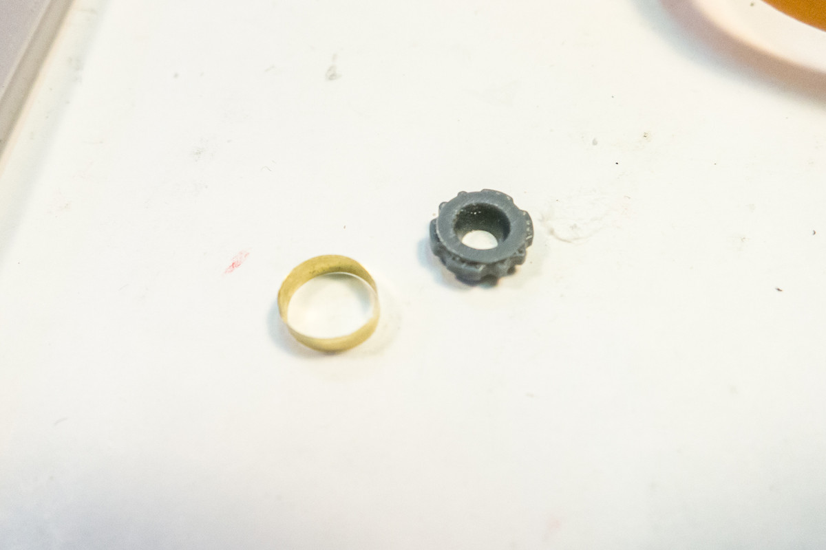

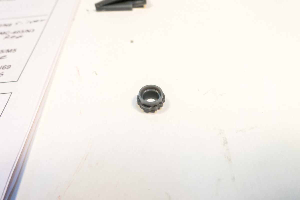

Speaking of the nozzle... I thought that the business end of the motor had such a thick trailing edge that it needed to be replaced.
So I fashioned a new one out of a strip of brass sheet.

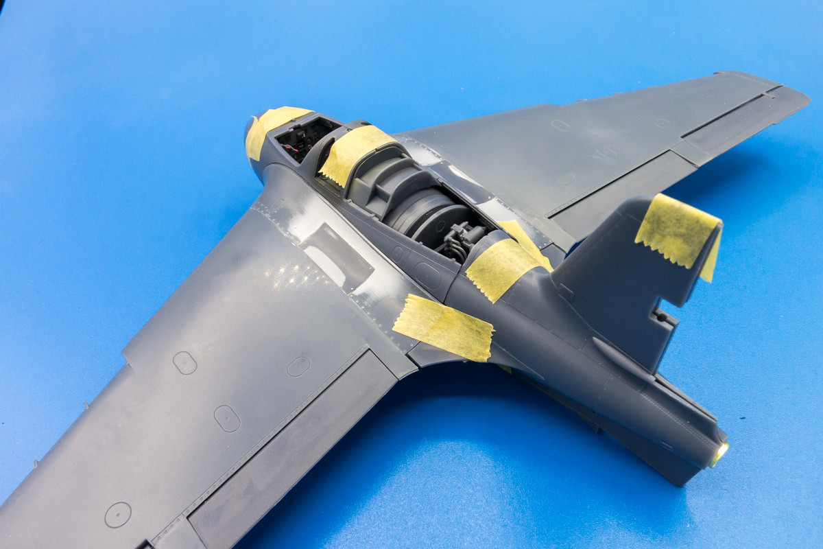

Re: 1/32 Meng Me163 Komet

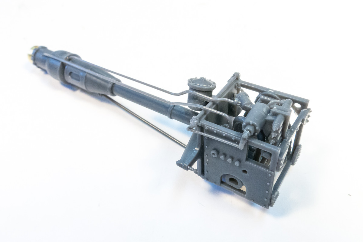

Here is the completed rocket motor in all of its unpainted glory. The last added pieces are two of those long, delicate hydraulic lines, which were impressively molded in plastic and dropped into place without any drama.

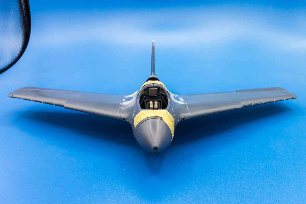

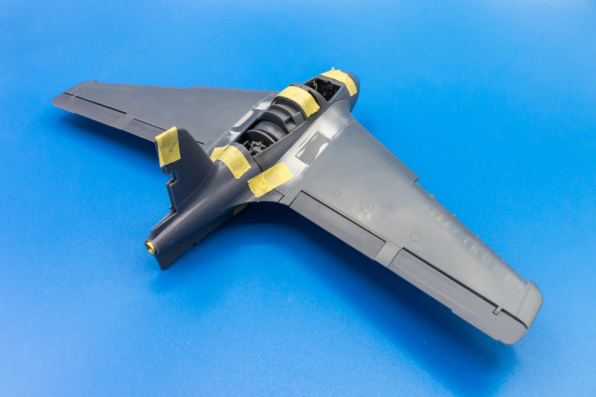

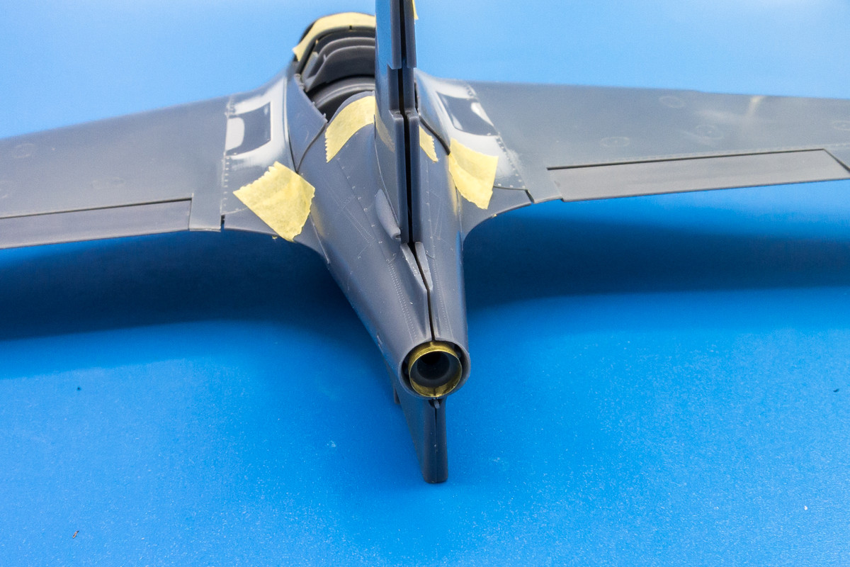

With the rocket motor complete, I conducted a dry fit of the major internal components: resin cockpit, fuel tank and motor to see how they fit within the fuselage halves and tail assembly. So far, so good!

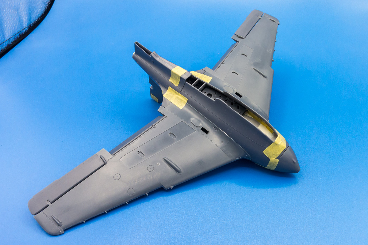

Wing dihedral seems to check out ok.

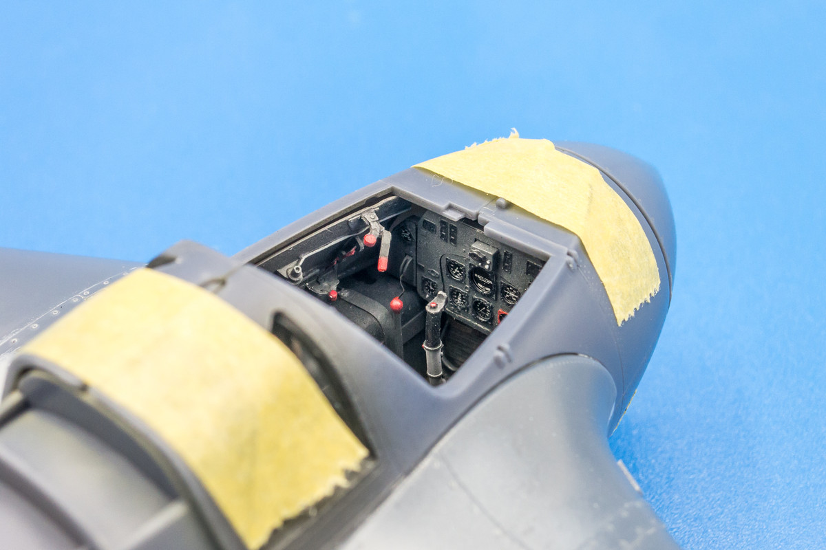

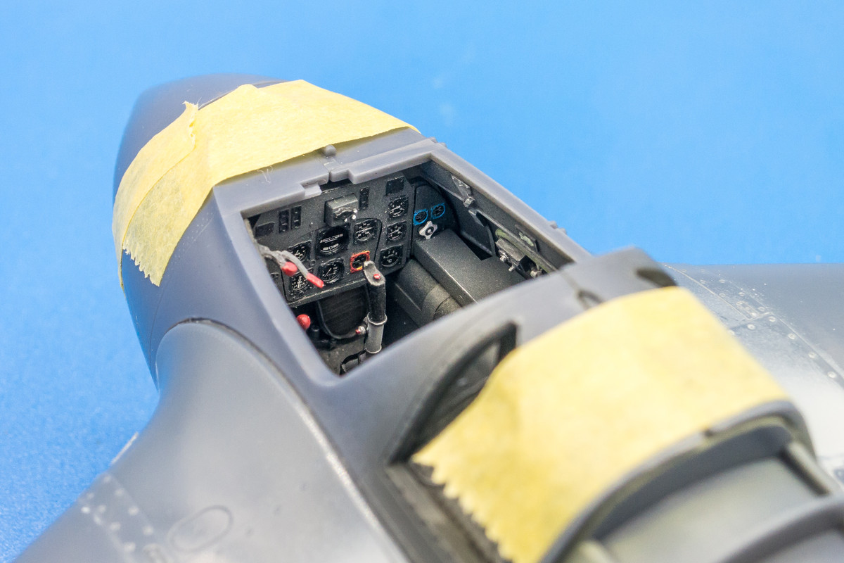

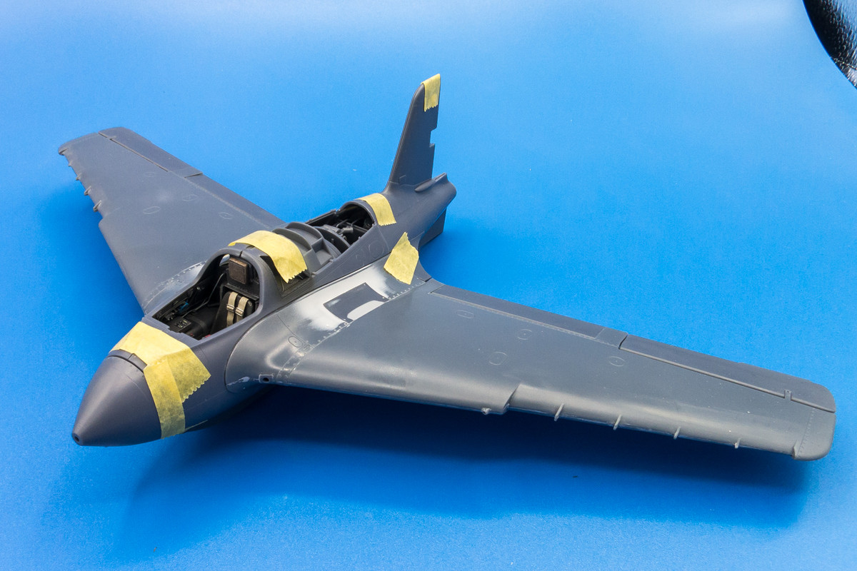

Preliminary view of the painted cockpit from the outside.
