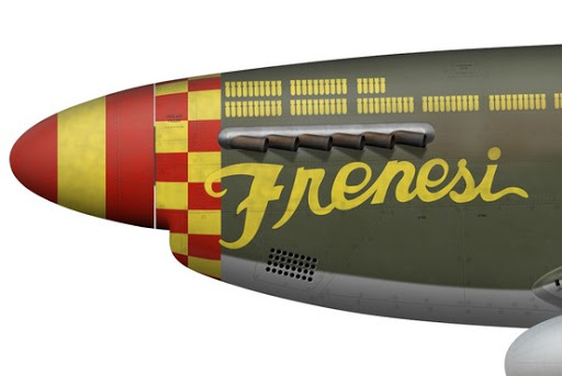

I've also been wondering about the scheme - I've seen a lot of NMF 'Stangs recently and I really feel like something different - so I'm going to go with an OD over grey scheme and have ordered this set of decals (and my favourite Hataka paints!)...
(I'm obviously going for the bottom one!)

Your new subject choice - like Old Crow - is one of my favorite schemes. Wonderful choice.
