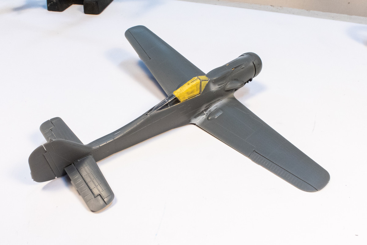

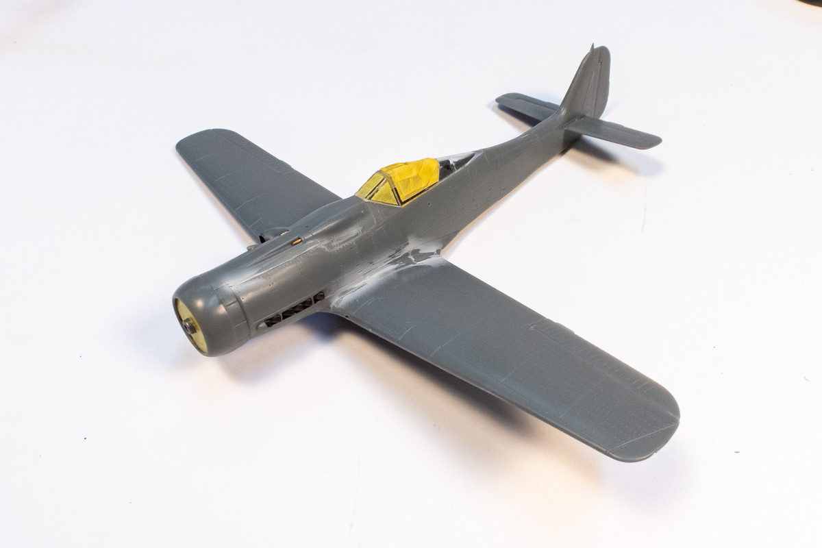

I didn't want to post again until I had worked up enough initiative to resume this D-9 build. So... to facilitate quick completion, I made the executive decision to glue the canopy shut so I don't have to futz with the slack antenna cable.

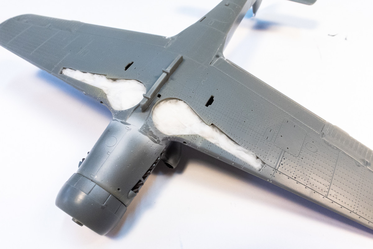

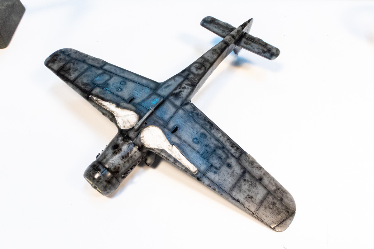

In preparation of the painting to come, I've plugged up the landing gear wells with tissue paper. When wet with water, the paper is easily shaped and conformed to the wheel well.

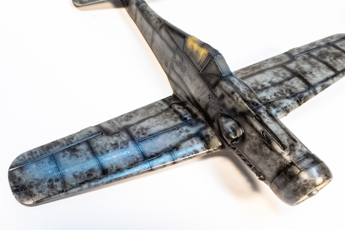

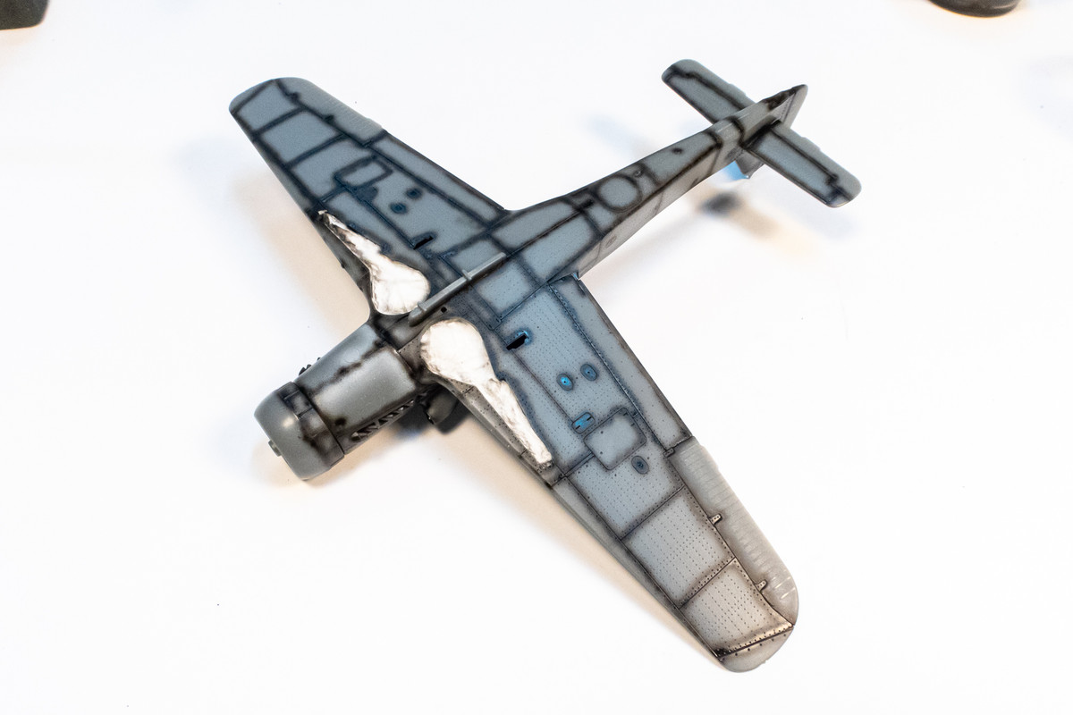

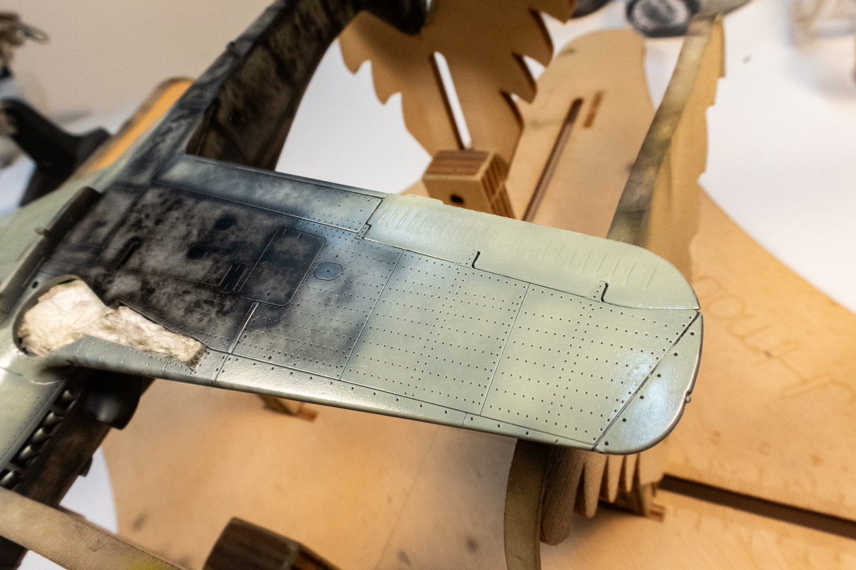

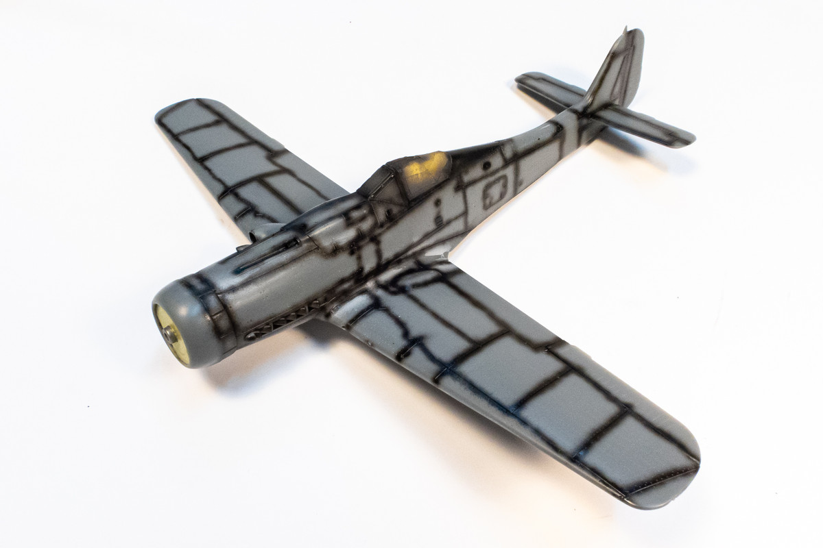

I am anticipating using my Badger SOTAR for some of the camo painting because it has a smaller needle than my workhorse Iwata HP-C Plus. I used the Badger to spray the panel lines black as my first preshade layer.

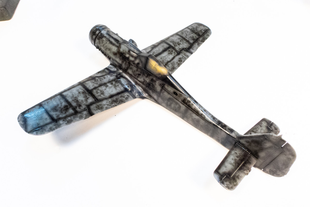

I reverted back to the Iwata to apply the second preshade layer, which is a random mottle accomplished by shooting black through a scrap piece of scrubbing pad. The preshading is intended to create some depth and irregularity upon the camo finish. This has worked fairly well on my 1/32 and 1/48 builds but obviously the first time I am employing it on an aircraft in this small scale. The good thing is that I can dial the effect from very obvious all the way down to zero, depending on how it looks to me.

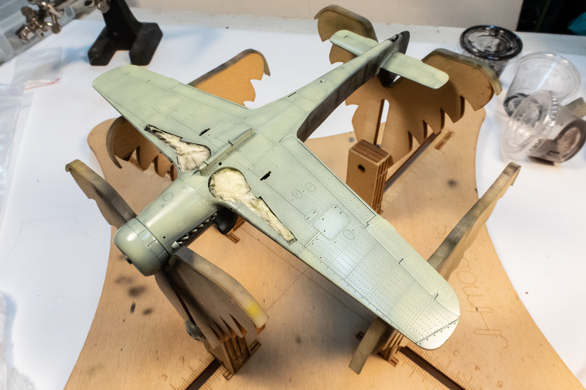

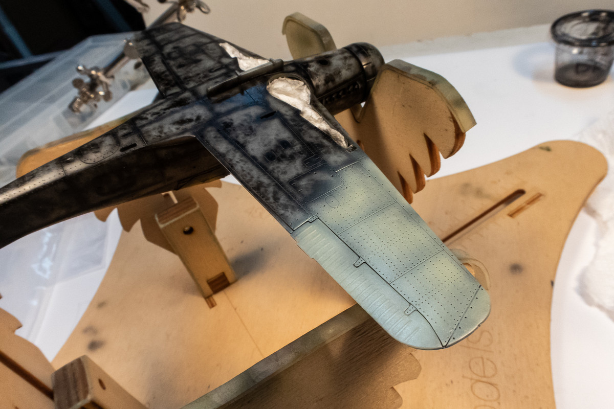

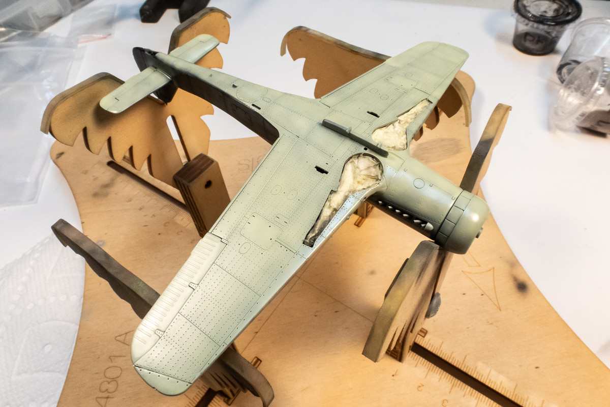

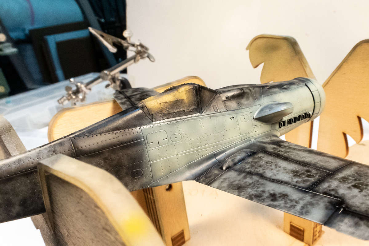

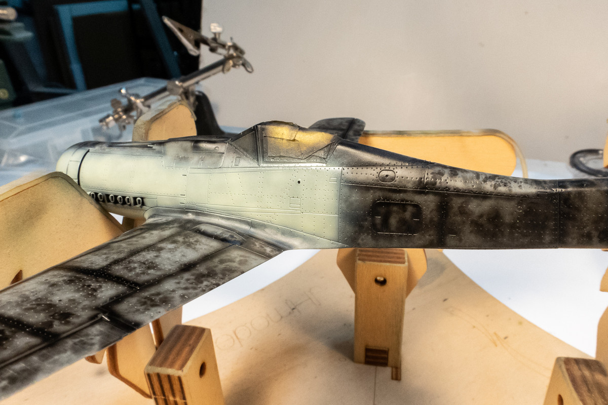

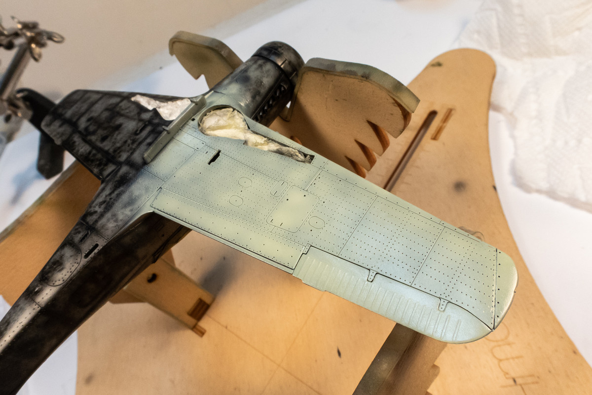

With the preshading done, camo painting can begin. The overall lower wing and fuselage color is the late war variation of RLM76. As mentioned earlier, Mr Hobby Aqueous Duck Egg Green seems to be a decent match for this shade. I've lightened this color with white, thinned to an approximate 2:1 thinner to paint ratio and started filling in this color gradually, panel by panel.
Because it is highly thinned, you have to keep the airbrush constantly moving to avoid pooling of the paint. Also, the high thinner content tends to seep into the darker preshade layer and bringing some of that to the surface so you have to monitor the sprayed areas for this gradual change.
Slowly, this base coat is established with a hint of the preshading layer visible.

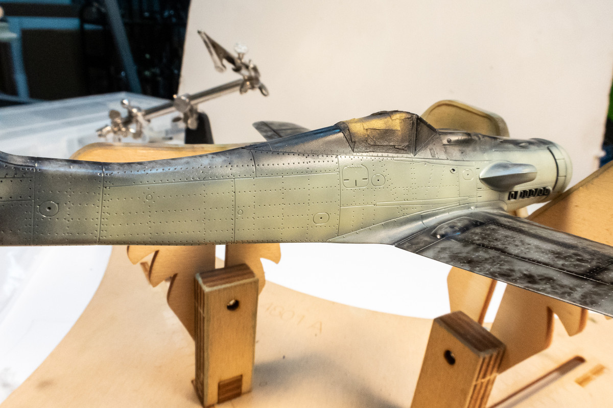

The color is extended to the fuselage sides in the same panel-by-panel sequence.

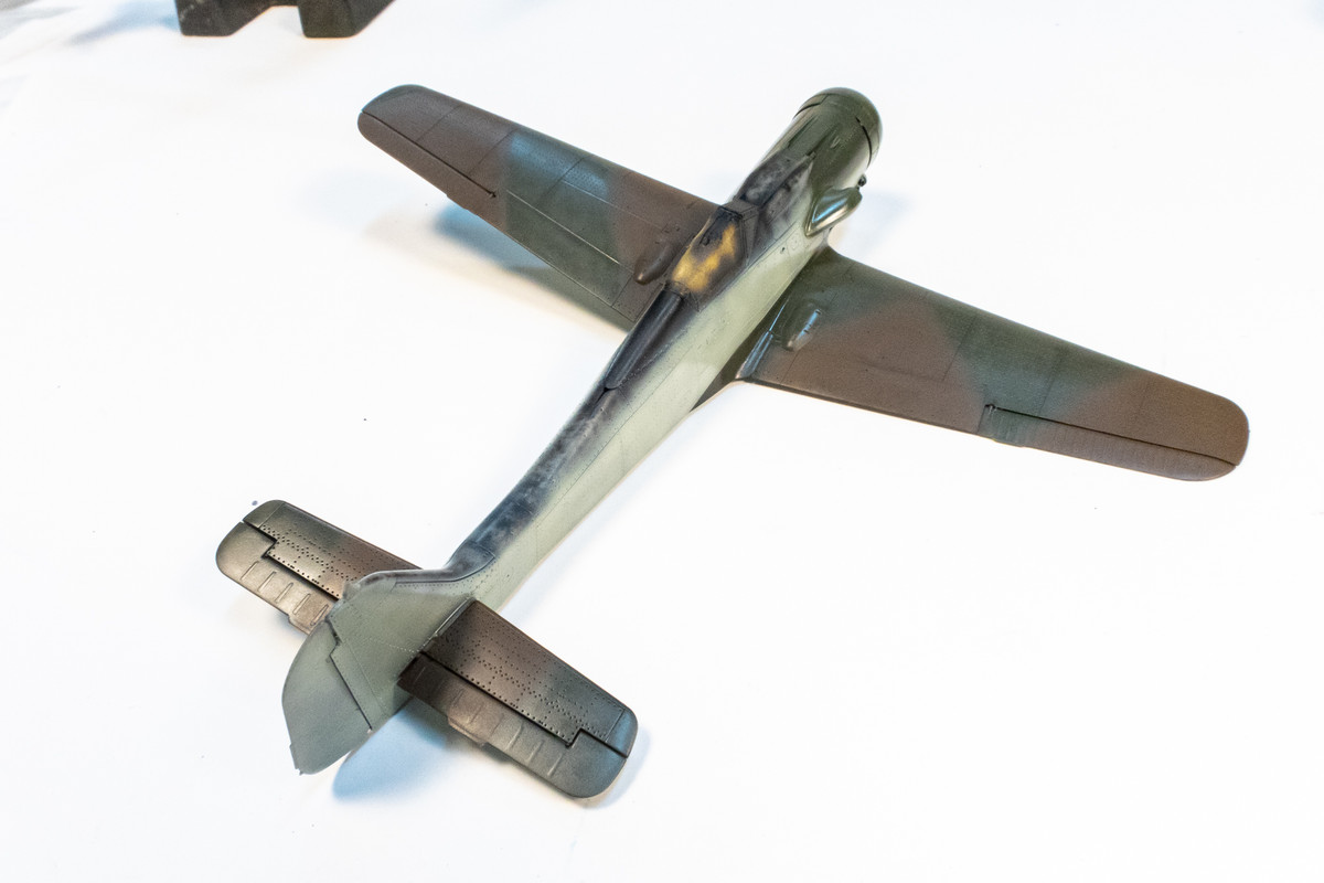

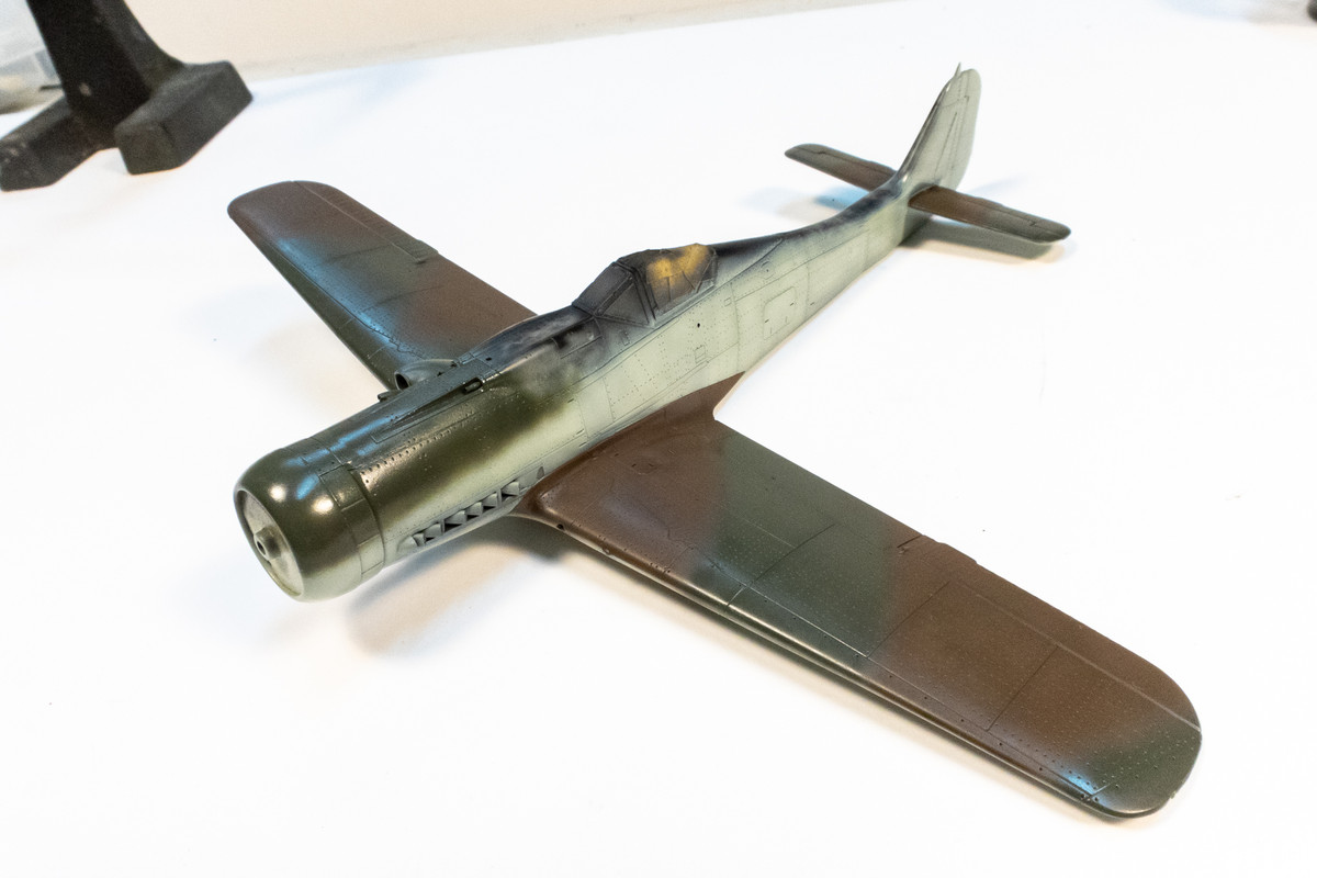

Once the RLM76 layer is finished, I paint the upper wings and horizontal stabilizers in RLM81 Brown Violet and RLM83 Dark Green. This low-contrast combination is not the sexiest look but it seems to be logically documented in Mr. Crandall's Dora book to be the likely colors.
The demarcation is all freehand with the Badger SOTAR airbrush at low pressure. I don't think I am satisfied with the demarcation that freehand airbrushing provides at this scale. I think it needs to be finer. So I am contemplating the use of lifted masks to provide a harder yet still sprayed demarcation.
