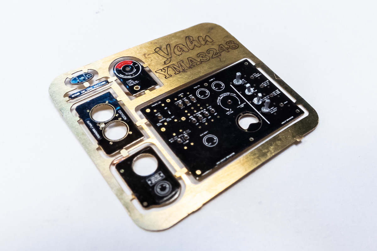

The arrival of the Yahu instrument panels completes the shopping list for this project so I can start on the cockpit.  There is a mixture of painted and unpainted brass parts in the Eduard set and also overlap between the Eduard and Yahu sets so I have to look things over and determine what AM pieces will be utilized, which will not, which ones will be installed prior to painting and which will be attached after painting.

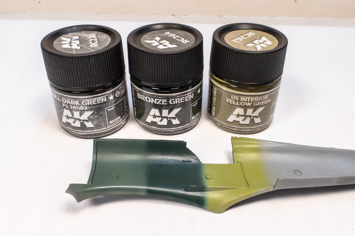

Speaking of cockpit painting, here are the AK Real Color paints that I picked up for this build. I will be using the Dark Dull Green for the cockpit.
I've previously noted the tiny holes in the Yahu main circuit panel that correspond to the switch and toggle positions.  I've ordered a set of toggle switches from ANYZ to play with on this build.
I pre-painted a few toggle switches and placed them on the Yahu circuit panel to see what it looks like. Only with a coat of paint on and under extreme magnification was I able to discern that I had chosen the flat-sided toggles.
And it's probably very difficult to see but in the upper left of the panel, I've inserted a tiny piece of copper wiring to simulate a raised switch. Adding toggles and switches will be very fiddly work, I predict. I think it will be best to glue the panel onto the port sidewall first.

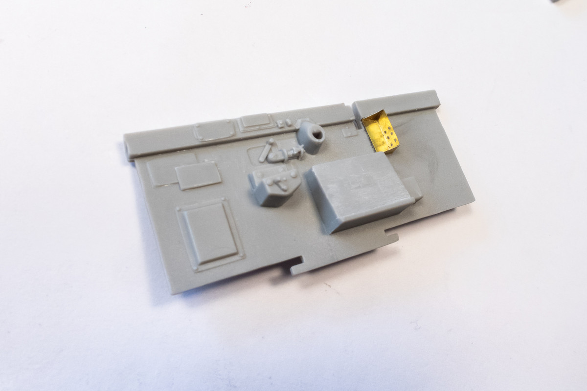

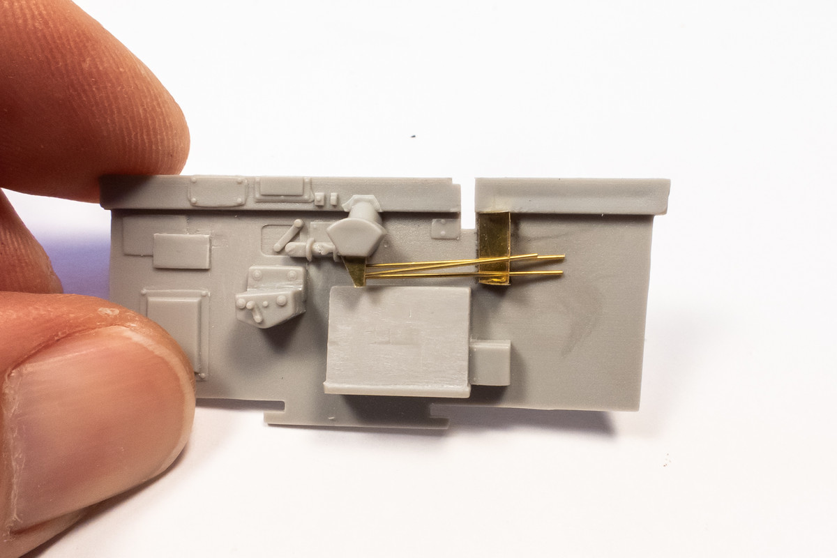

Tackling the throttle linkages is next. I don't have the dexterity to recreate the physical connections between the throttle quadrant and linkage rods so I just fabricated mounting points that will be hidden from view.
Thin brass rods will be used to simulate the throttle linkage rods.

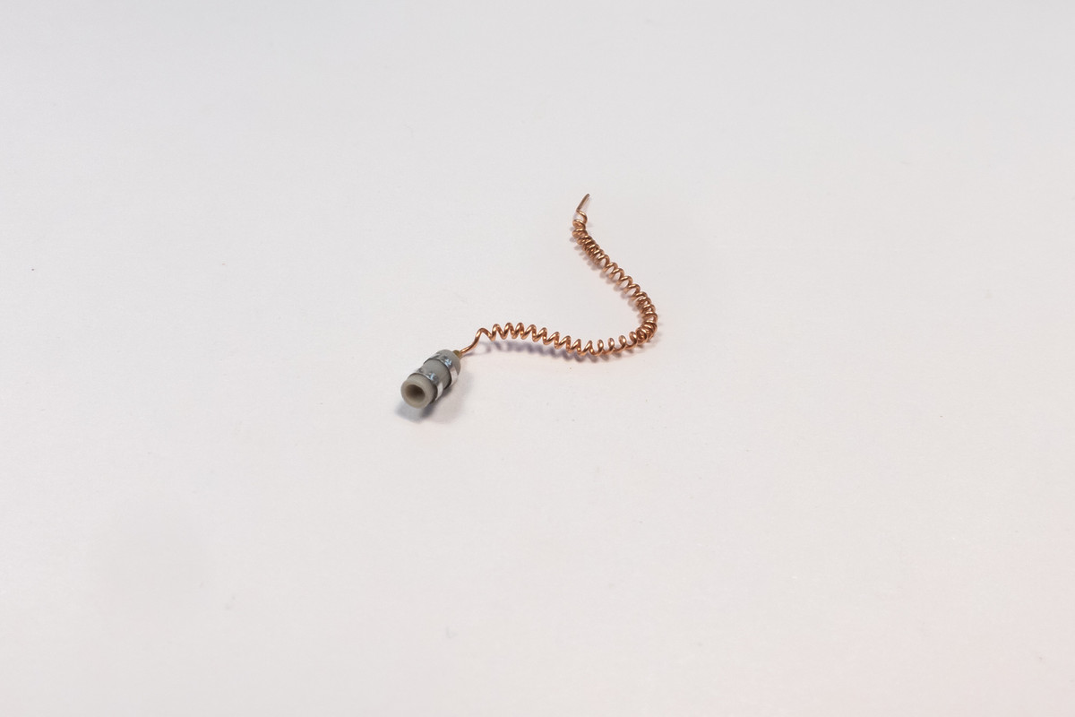

I scraped off the cockpit light that was molded into the port sidewall and fabricated a new one out of plastic. The cord was spun around a small drill bit.

Good choice on the Dull Dark Green in the cockpit. That Yellow Green looks perfect for the gun bays and wheel wells, as Republic tended to use that color on those areas.
