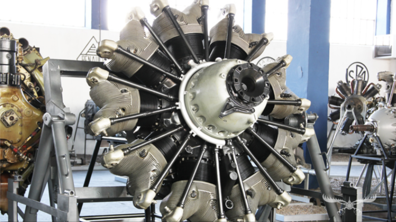

What you wrote led me there... let’s see if we are both on track! Cheers, bud! I do need to redo the sketch and probably should move these braces forward, although I think-think-think I figured out how and where the braces mount directly to the engine itself after I found a photo of the engine in a Museum in Crakow that is of acceptable resolution for me to see where these mounting points are located.

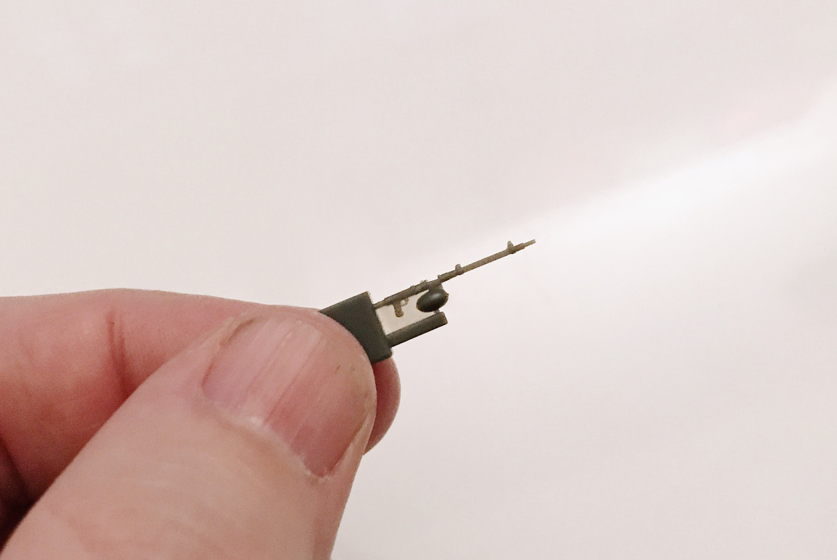

The MG 15s arrived.
The MG 15s arrived.
Re: Frog 1/72 Dornier Do 17 Z, 5K + AS8, KG3, October 1941.
I'm not sure how Chris approaches his colors. I know he uses a lot of Tamiya and he doesn't seem to be a color chip kind of guy. More instinctual and flowy... does that make any sense? I dunno... I could be completely wrong. Sometimes you can find clues in the comments section of his blog entries but he doesn't mention anything about the prop colors.speedgraflex wrote:Thanks so much, John! When you have a moment let me know what you think of Chris Wauchop’s work on 1/72 blades. Is that a Tamiya RLM mix? I would have to lighten the Gunze 18 or find an alternate color. I have a few RAF and IJN dark greens I was going to try as well. Each prop blade will be a different color....
Great detective work on the engine bracing. My god, that gun is SMALL.
I’m with ya buddy! You got this! Now that you know where the mounting points are, and the configuration, you should be good to go! It may very well be that they need to come forward a bit, but that won’t matter if you’re going by where they mount to the engine, because theoretically they’ll line up right where they belong on the cowl if you get them in the right place on the motor. That is, if the kit’s engines and cowls are all to scale. But yeah, you’ve bacically cracked it now, and that’s awesome! And I appreciate that you’re going this extra step, those braces are gonna look awesome in there.
Nice fun too! A big improvement over the kit’s armament.

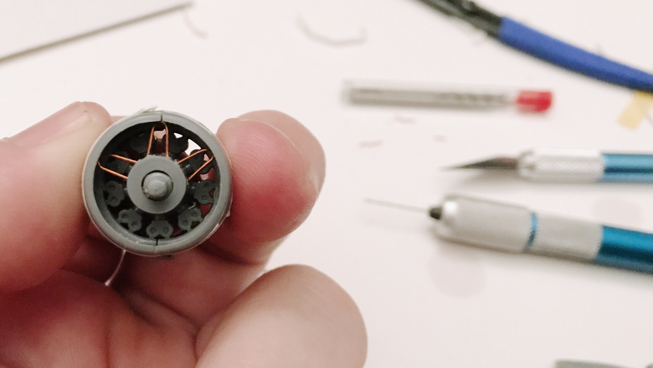

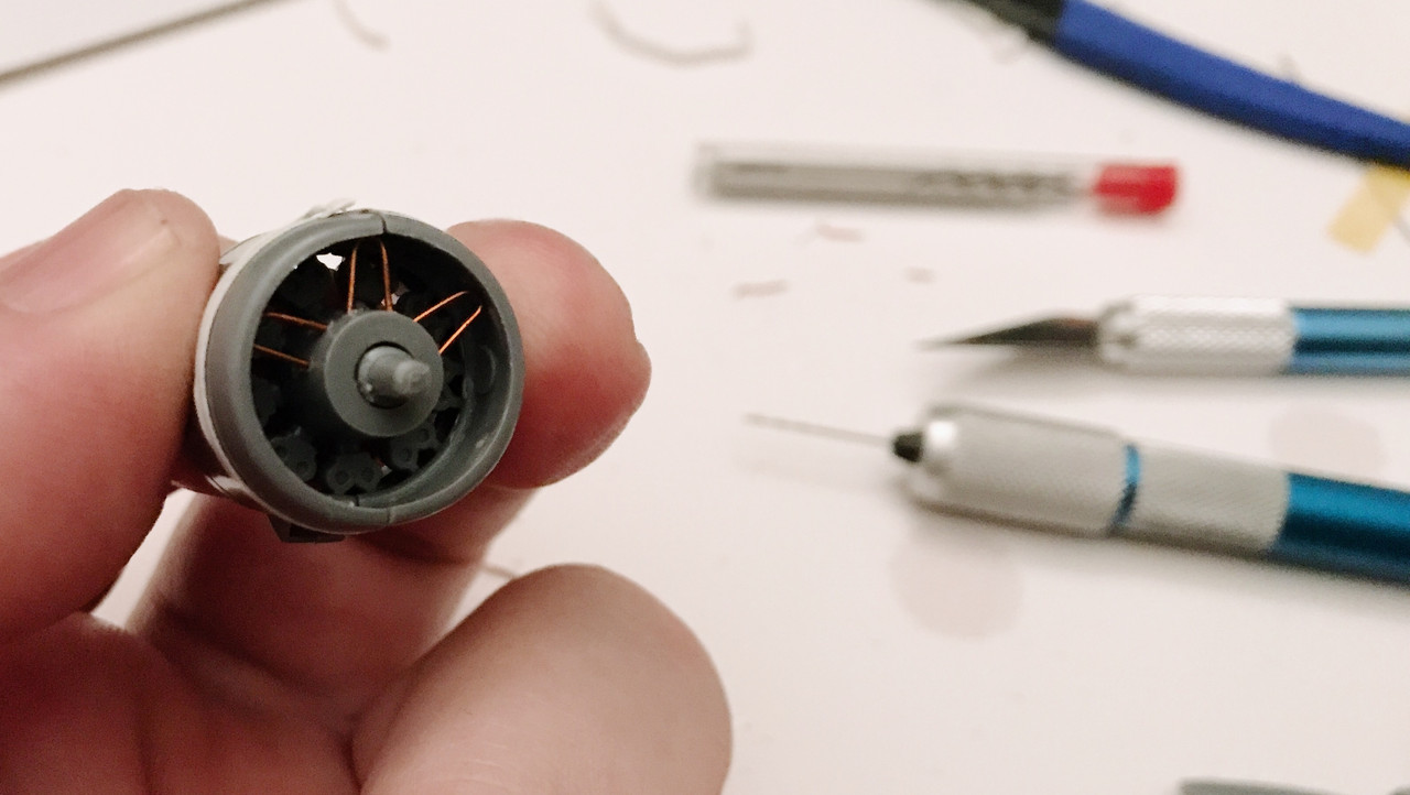

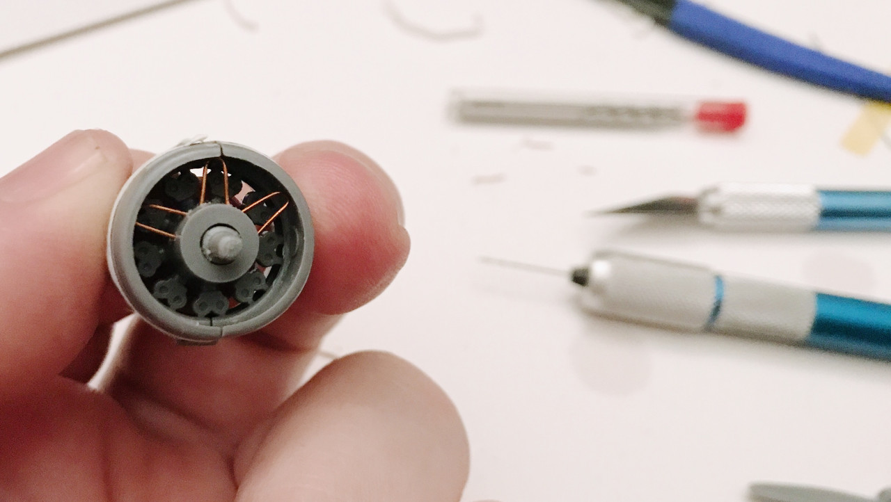

So, here is another idea—wire: this time I did three samples (I became better at bending as I went along so I have the option to pull the first two which were toughest). I measured tightly. These press against the plastic snug as a bug in a rug! I am not sure by making these essentially paperclips I am achieving the same accuracy from all angles so here are theee shots from different angles. Please do let me know what you think. I did go to a smaller diameter wire, which I believe looks better. I did move the braces forward.
