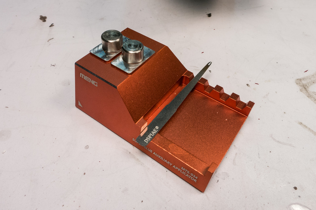

But here's a photo I forgot to post. I just picked up this CA glue station. The station itself if probably unnecessary and a bit overkill but I thought it was kind of cool looking. You drop your CA glue onto the one of those two metal pillars (you could use almost ANYTHING instead) and use the applicator to apply the glue. The applicators are what make this useful to me and it's packaged with about six of these. The two-prong end supplies enough surface tension to hold a drop of thin CA glue and you use capillary action to apply the glue. This will be useful when I start with the photoetch flaps. Before I was using a toothpick and it just wasn't working very well. To clean the excess glue off the tool, you just burn it off.

That is a cool and good looking thing indeed! I guess it's heavy enough to stay pretty much where it's put ?
Actually, most of the stuff that DSPIAE comes with is cool. Great it's also branded as MENG, easier to "talk about"

That's a cool looking setup. I have a sewing needle with the eye cut in half and the other end chucked in a pen vice. Still find myself using a toothpick for a lot of stuff.

That looks a lot more advanced than the Pringles lid and cocktail stick set up I use :grin:
