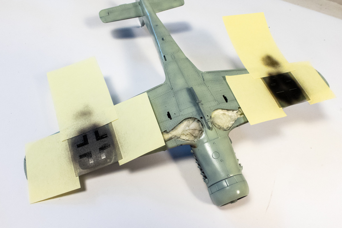

Before addressing the spray demarcations on the upper side, I thought I'd shoot the bottom wing crosses. Using the kit decals as a template, I've prepared custom masks for the major markings using my Silhouette Portrait craft cutter.

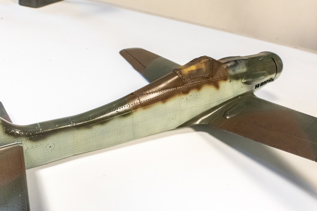

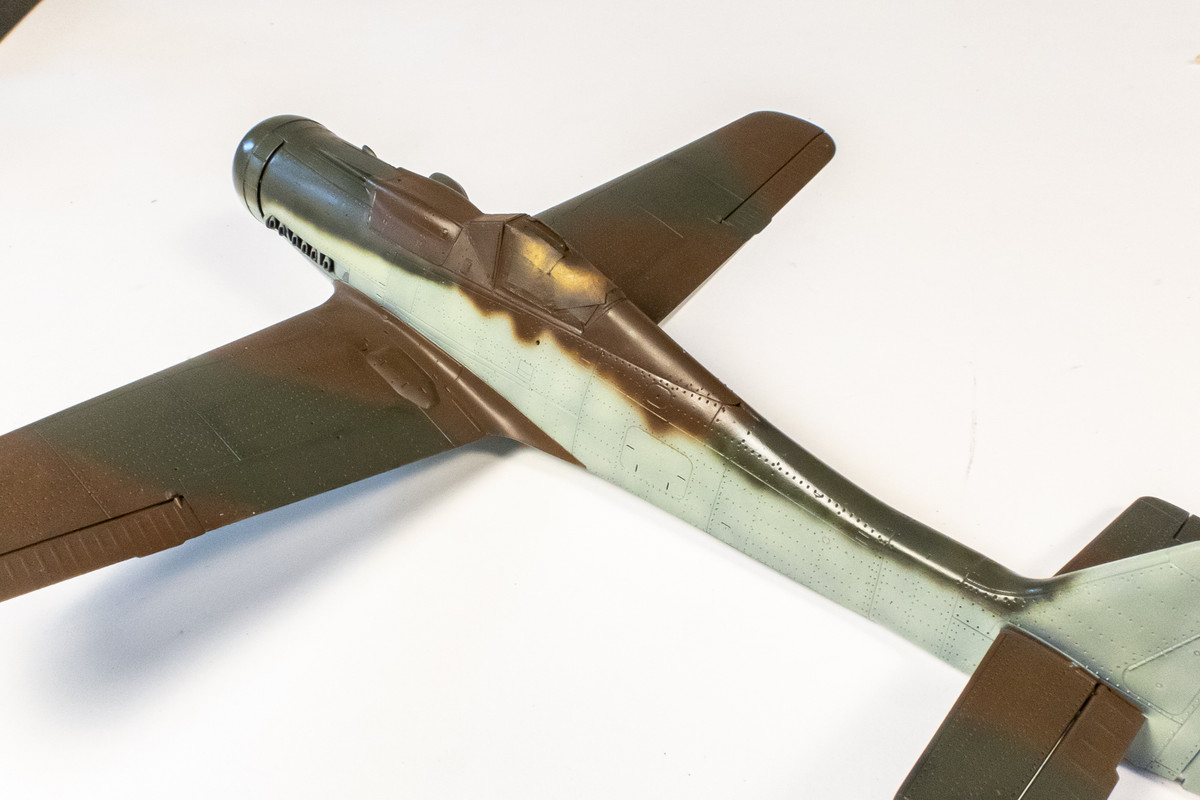

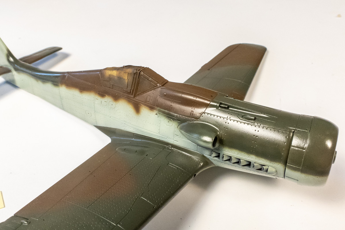

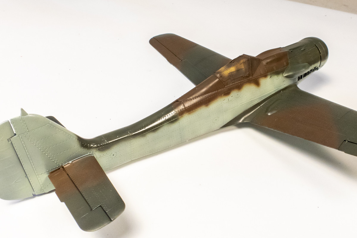

Flipping the bird over, I've tightened up the spray demarcations using little strips of torn paper suspended a few millimeters off the surface of the model using little blobs of Blue Tack (poster putty). It's fairly easy task at this scale since the model is so small and the makeshift masks are correspondingly small. FYI... these photos have been cranked up in terms of brightness to illustrate the corrective work and may not be representative of what the naked eye is seeing.
I've also been getting better at milking the Badger SOTAR's performance by dialing in the paint/thinner ratios and reducing the air pressure. I thought I was going to use masks for the fuselage sides but found that I am getting an acceptable spray demarcation without any aids.
I've deviated slightly from the all of paint references (Sundin, Crandall, kit instructions) and decided to paint the upper fuselage with the same RLM81/83 combo as the wings and giving the gun cover a hard demarcation all around. These late war Doras were often manufactured and painted at different factories and hard, mismatching transitions between the front and rear fuselage assemblies was often seen.
Adjustments to match the camo closer to the archive photos, the tail mottle, the mottling on the gun cowling and the yellow/white/yellow ID band are still to come.

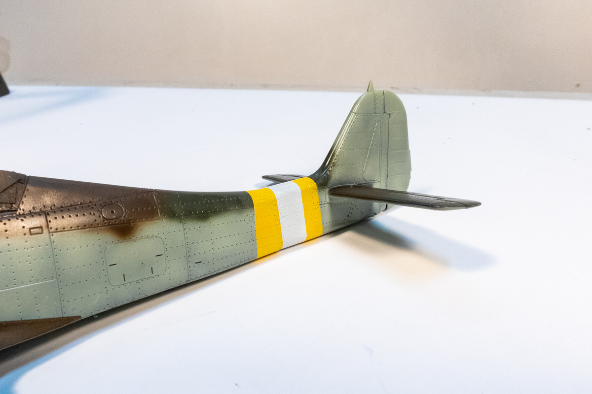

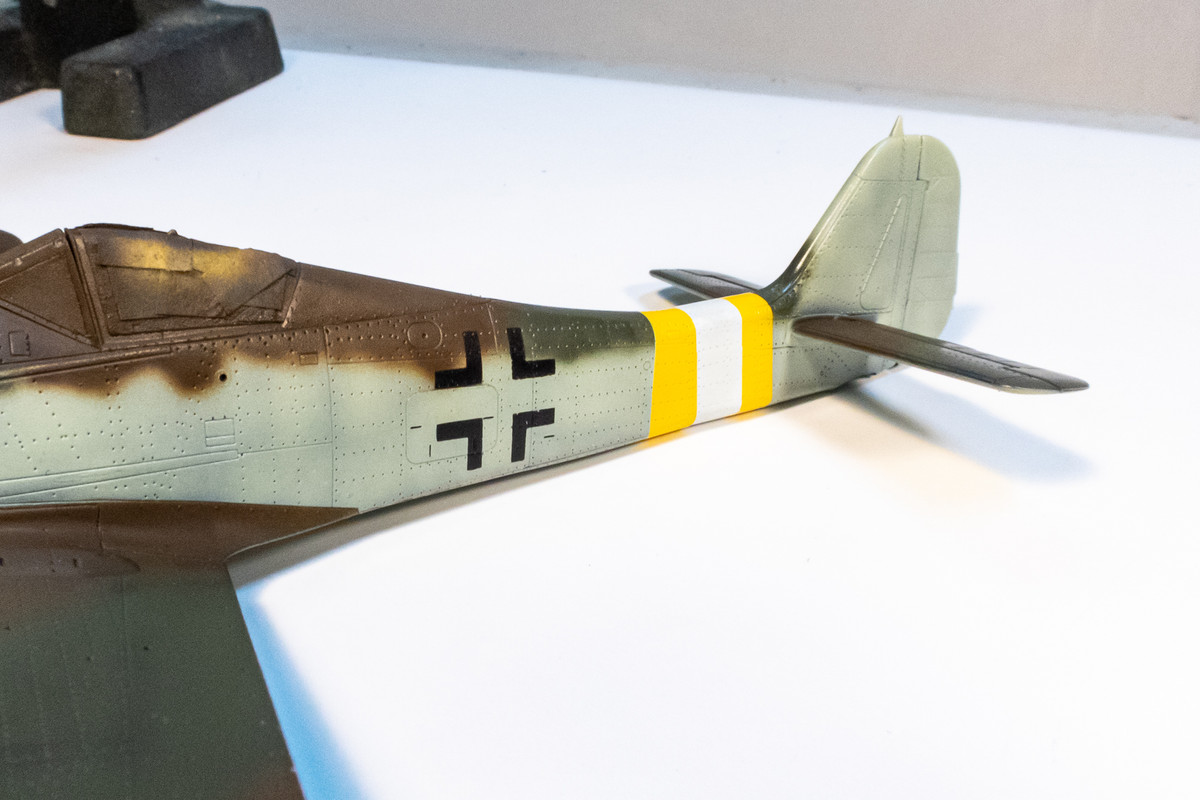

A little more paint work was completed this evening. I got the yellow-white-yellow ID bands masked and painted.

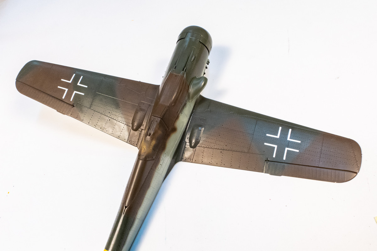

The skinny white upper wing crosses were masked and painted next.

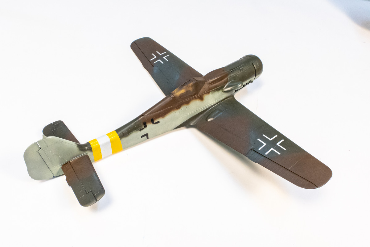

A periodic perspective reminder...
The black fuselage crosses are painted. The starboard cross has been partially obliterated by paint repairs, according to the archive photos. This is my initial attempt at replicating this but some more will most likely be done to fine tune this effect.
A brief pause to summarize the work up to this point. Still a bit of camo painting to do including the tail mottle.
