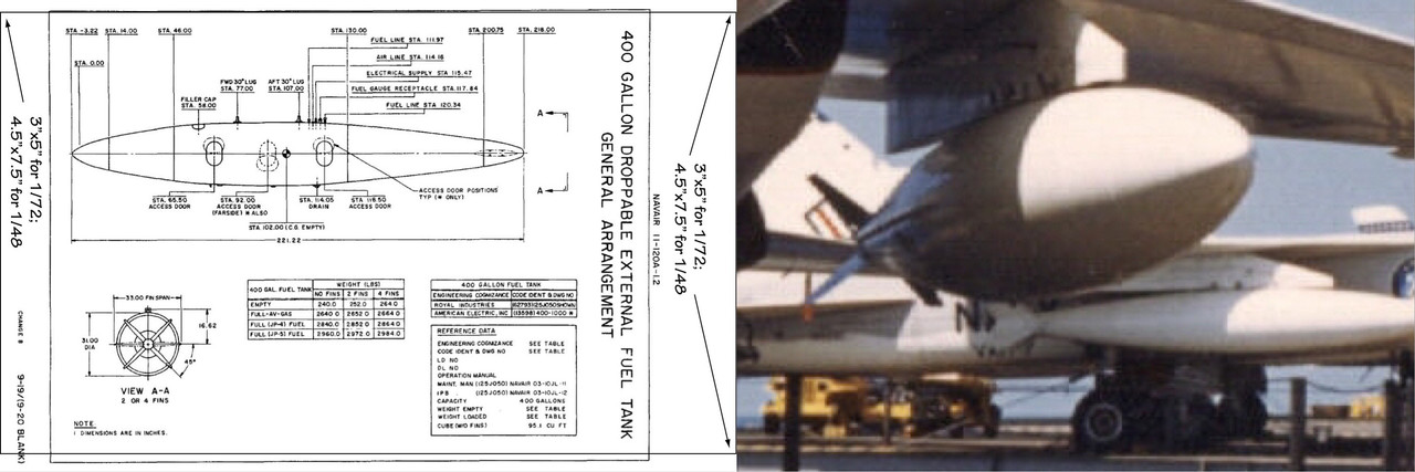

Note the 400 gallon tanks as well. Not part of the kit. I keep circling around the idea to find aftermarket to add these to the model. However the approach I am taking—the vector, if you will—is that of protective build of the kit itself. Not quite out of the box. More of an attitude similar to the pilots in the photo above... an attitude of respect.

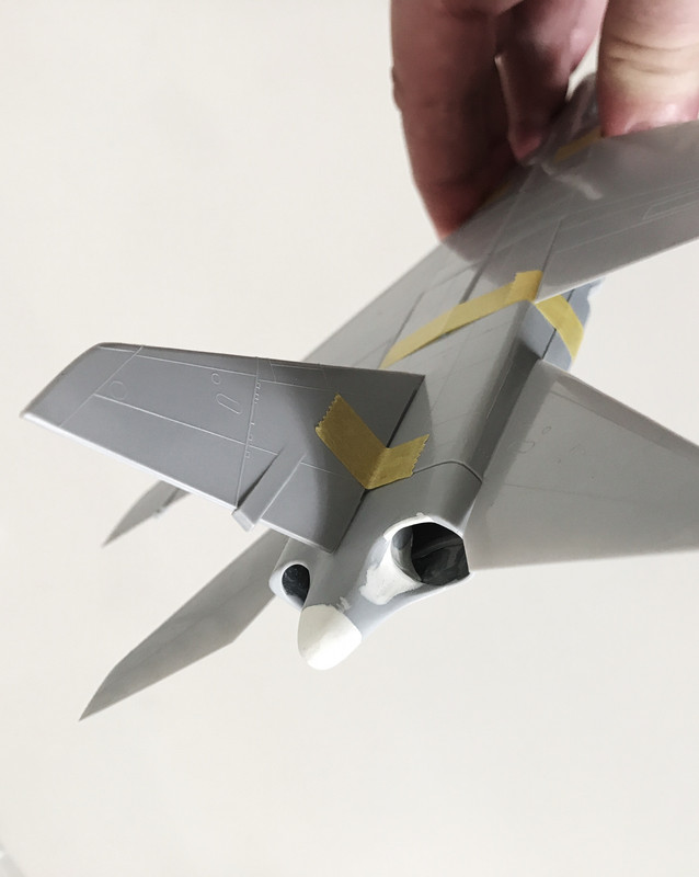

I am keeping the raised rivets. Personally the raised rivets look better to me than the holes in the Trumpeter kit. I am going to minimize the raised engraving on the wings and add the paneling lines that are missing by scribing these. Most of my work will be on the tail, and as I made some progress last night on this task, I need to add the documentation here.

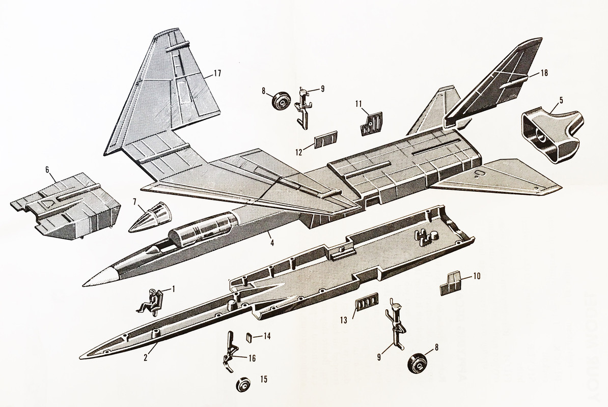

Good morning! Thank you and with your permission I would like to dedicate this project to you in the spirit of your classic builds as well as with respect to your approach as a modeler. There is so much to be learned beyond gluing parts, and this kit has a very few number of parts, Carlos. The landing gear may have the most parts—9 pieces total. Seven pieces for the airframe including the pilot. That is what... 16 pieces? I know most instruction sheets from the era advise the modeler to build slowly and carefully, but this kit could be assembled in a few minutes. Actually the count is 18. So long rambling short, this one’s for you, bud.

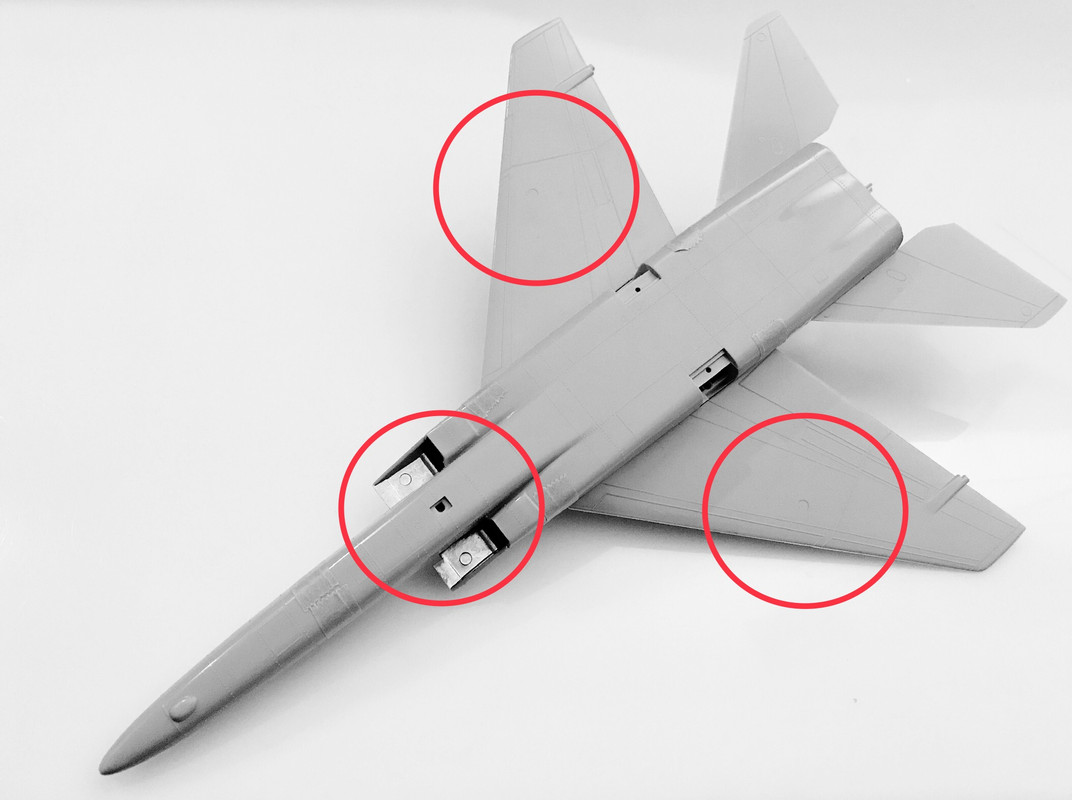

Wow! Thank you so much, Carlos. That link is incredibly helpful! Painting the pilot figure is going to be one of the most enjoyable experiences of the project itself for me. Tonight I am going to sand and patch these recessed molding pin (sink holes?) with Milliput.
Re: Monogram 1/72 US Navy A-5A Vigilante.
Those are ejector pin marks.

400 GAL FUEL TANKS ON THE A-5A VIGILANTE
by Carlos via email
Looking at those sites that have been previously been linked, it would seem that the original A-5A/A2J had no wing hard points. But the photo you sent here shows an A-5A w/hardpoints and tanks. The A-5B added wing hardpoints, and the humpback fuselage tanks,but only two were made. The RA-5C version added the recon equipment to the A-5B airframe. So apparently the A-5As were retrofitted with the wing hardpoints. An educated guess, says that the basic wing structure was unchanged, and that the hardpoint location would be the same. Yes the wing did evolve a bit over time, but not drastically like some other aircraft types.
