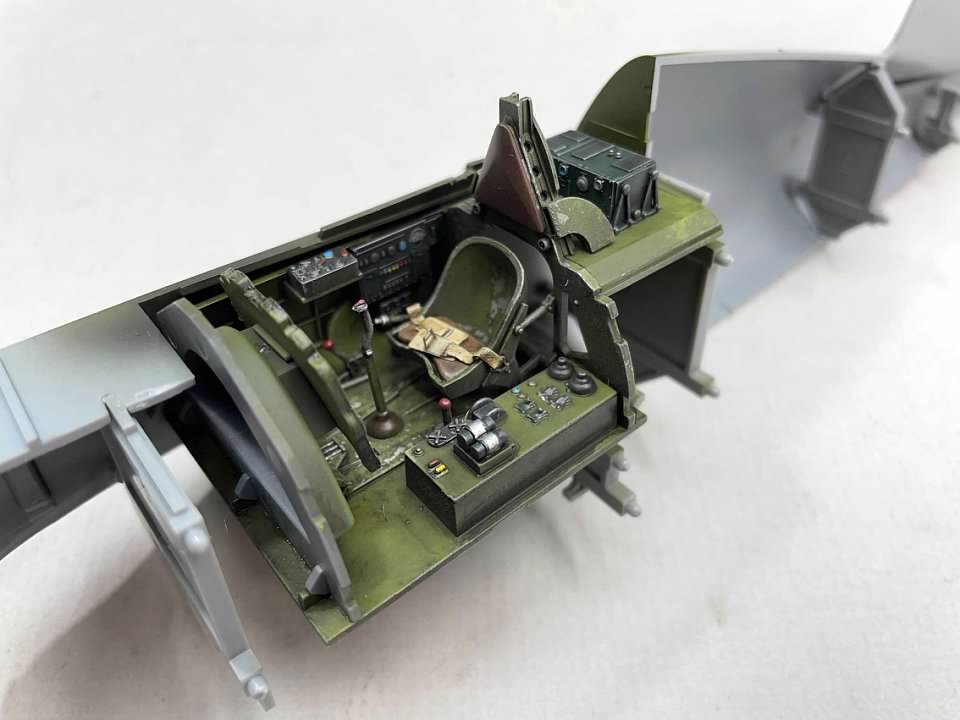

It's nice to be back in the "easy on the eyes" scale. The pit looks fine out of the box, but it's nothing fancy. I added a seat belt from the stash (old FW190 lap belt) and I wired the radio. I sprayed the interior AK Real Colors Mitsubishi Interior Green. Seems a bit too olive to me. Oh well.

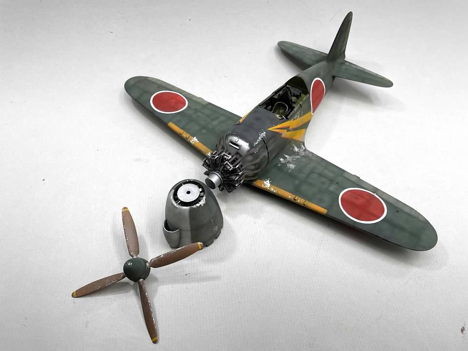

The engine is fantastic. So is the cooling fan detail. Like the FW190, he engine will be hidden. What a shame. I painted it up anyways and gave it a Tamiya panel line wash.

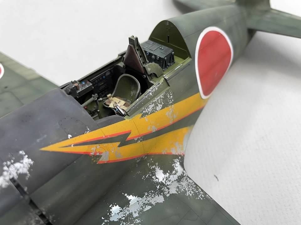

I added Alclad Aluminum to the areas I as going to chip, namely the wingroots and cowl. Time for paint.
I then began my experimenttion. I sprayed hairspray down on the silver. Once dry, I added some liquid frisket on a sponge to some areas, mainly the wing roots and cowl. I then did my normal painting. After a black preshade, I used XF-19 Sky Grey on the underside then XF-11 JN Green on the upper side. Both were then reverse black based by lightening the colors to produce a tonal fading effect. These turkeys sat outside and i bet they oxidized quickly. The grey was cut with XF-2 white and the green with XF-57 Buff. Once done, the frisket was wiped off to reveal chipping. I like the effect. For other areas, I wet the paint which activated the hairspray underneath. I then chipped with a toothpick. The meatballs were then painted and so were the arrows (which were an exercise in patience, but better than trying to use Hasegawa decals this large). I suppose I could have documented this better, but here's how it turned out.

Lovely. The chipping of the paint is much better than anything I have achieved. If were to try to improve your result (only in my mind, not in fact!) I would try to get a less stark transition from the bare metal to the unworn paint, in my experience with airplanes and other machinery paint wears thin before it disappears entirely. That may not apply to Japanese late war aircraft entirely though, I've read that like the Martin B-26 there were adhesion problems due to no primer.
