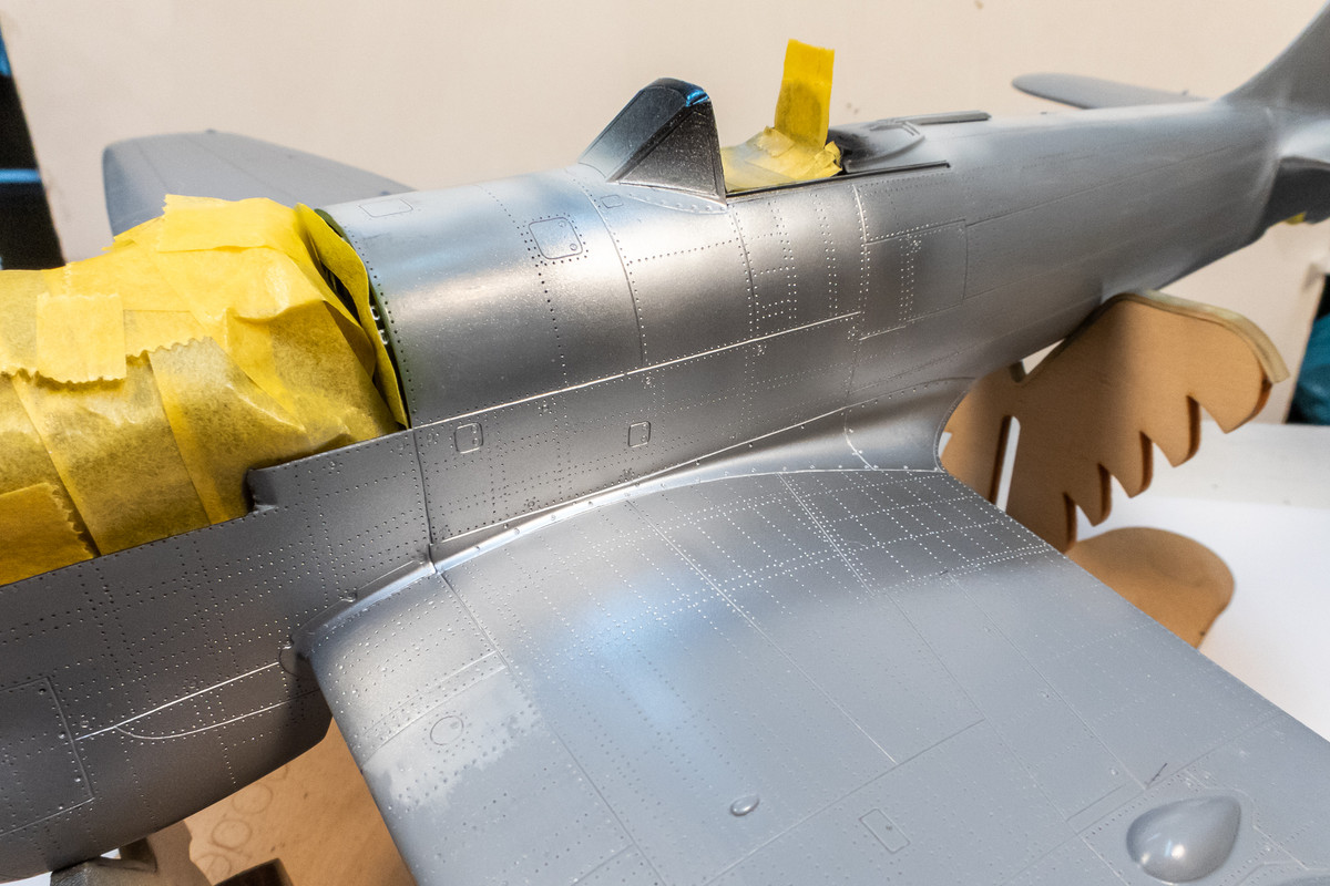

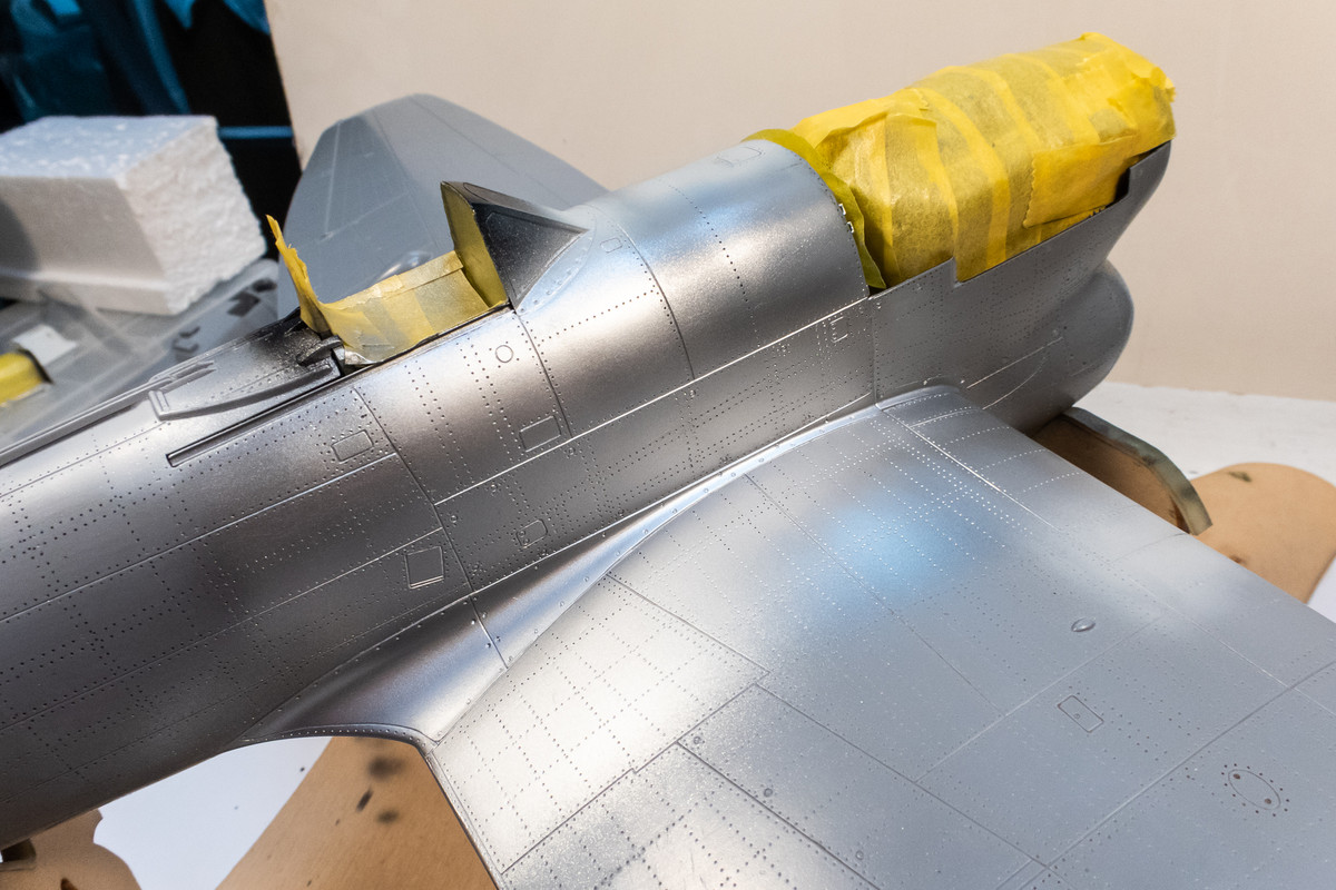

I've had good results by simply spraying Tamiya spray can (AS) paints directly into my airbrush cup, adding a couple drops of Tamiya Acrylic Thinner or Mr Leveling Thinner, mixing it for a few seconds and spraying onto the model. No bottles or straw necessary and no need to de-gas.
Examples of Tamiya AS-12 Silver sprayed this way on my Tempest build...

John, your results speak for themselves, as they’re superb. But I would sure love to watch a video of your decanting method.

That's an interesting method I'd never heard of before. And as Carlos already said, your results speak for themselves indeed.
Thanks for passing that along, John!
Re: Decanting question
Give it a try! As I stated, there is nothing additional needed. I'm using an Iwata HP-C Plus which has an average sized cup on top and I've had no issue with paint flying out of the cup. I may get a little bit of paint on the finger tip pressing the spray can nozzle but it's minimal. Almost too simple of an idea for a video but if I have some time, I may do it.
