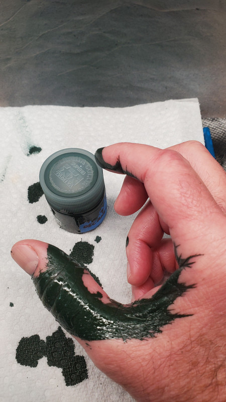

After some self-debate, decided to share my mistake of yesterday morning.
I had plenty of really good advice, and still screwed up. Thing about advice, I guess you gotta actually follow it.
If there is one bit I really should have paid more attention to, it's John's below.
How this happened: I did this before enough coffee and waking up first, mistake #1. I thought for sure it would be ok by now, but how about a final stir, see what happens, right? So what do I do, put in in my paint shaker for 15 seconds. Duh.
First time I haven't been gloved up and wearing my apron playing with paint all summer. Was I surprised when I opened the lid, or what? (ruined my favorite summer shirt, too).
How did this happen? I never stirred at all, despite each of you telling me to. I just gently shook the bottle a few times. If I would have stirred, I would have seen the reaction immediately Replaced the lid thinking I was all done way too soon.
Maybe I won't do that again. Or not. Who knows.
But your advice was all spot on, that part is for sure.

I did the opposite, and here's what I ended up with...jeaton01 wrote:I don't put a lid on the container until I am sure it is degassed well enough.

Re: Decanting question
Wow - I love science. When it happens to someone else. I must say that I have never had that happen. Dumb luck I guess. I usually just knock the jars over and make a mess. Same result, different method.
