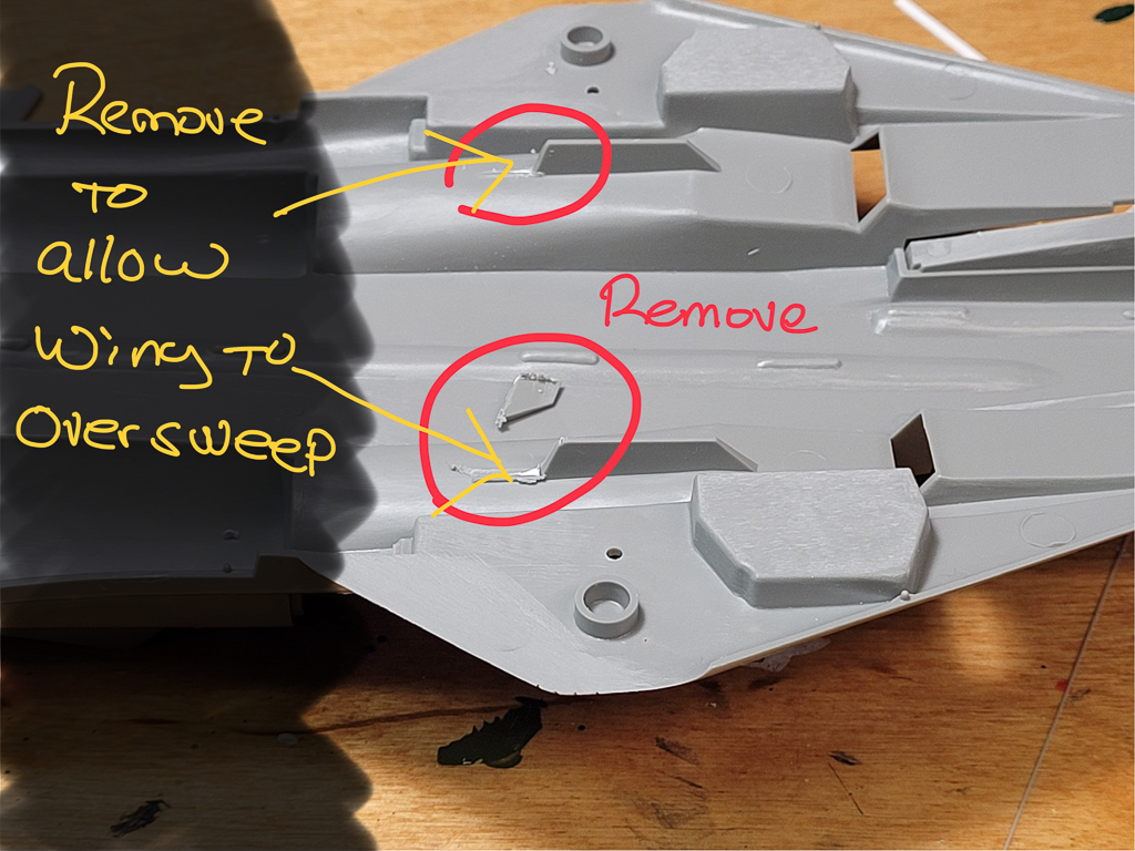

It's a bit sad, but it is a model and not a toy after all. Sweeping the wings in and out would damage the finish anyway.
That being said, it might not be that hard in the era of 3d printing to fashion some pivot extensions (like the Tamiya kit) that the wings would slide onto at the end. Now I have to think about that... :hmm:

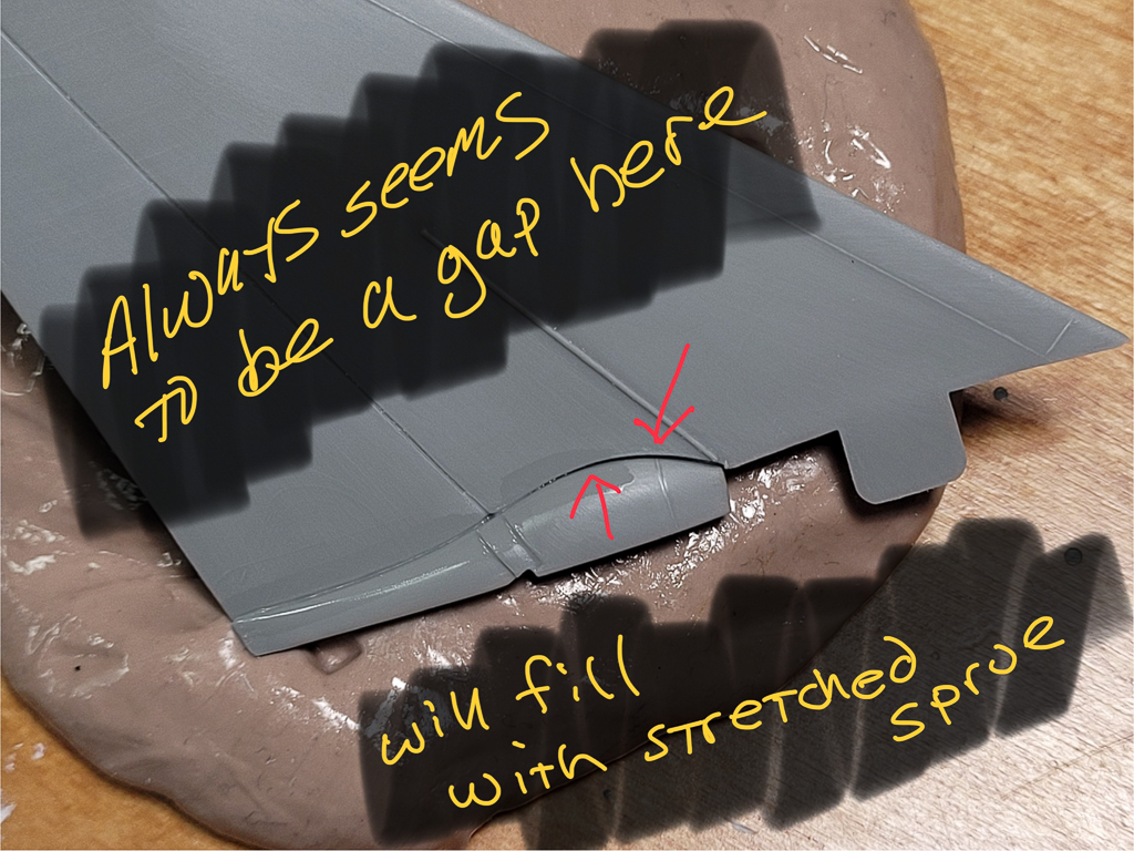

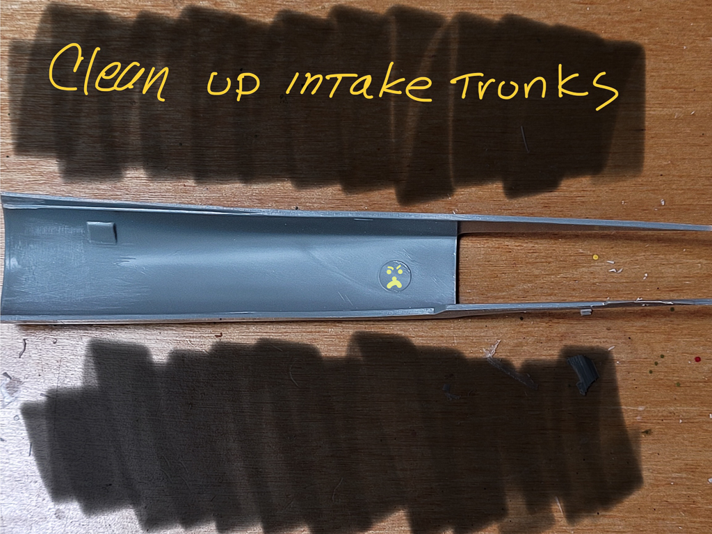

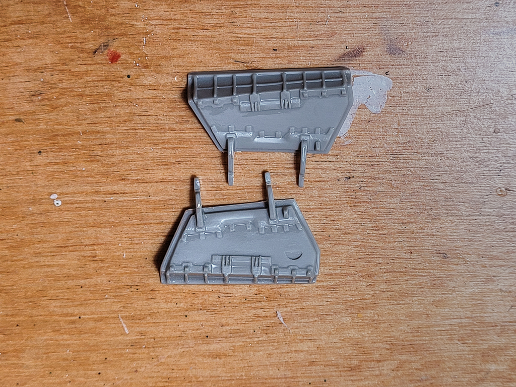

Cleaning up these gear doors is wearing me out :ballbat:
Alsmost have the bottom one done.

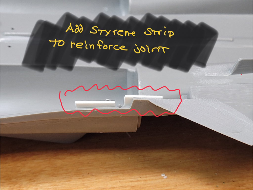

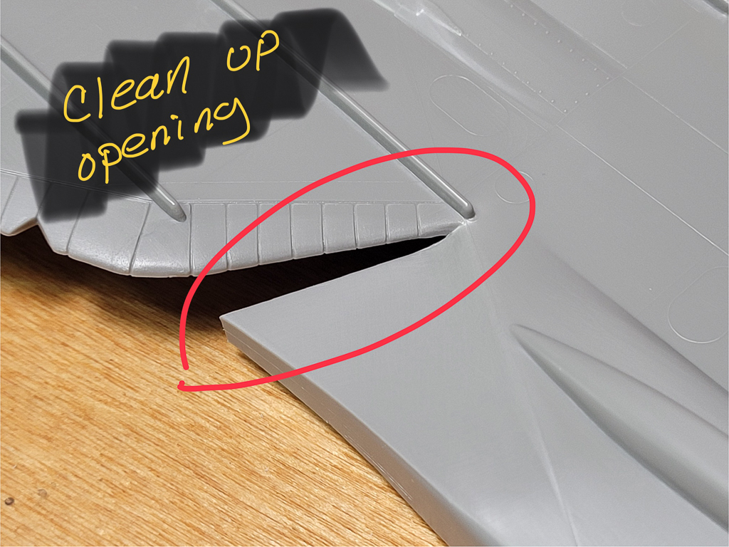

Made or making additional changes as shown below...
This joint always give me issues. Not taking any chances this time...
Flash and Styrene turds everywhere on this thing.
