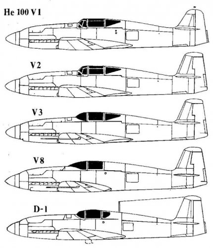

I believe we are going to disappoint you, Lyle, but I hope you will not be too disappointed. The plan is to use the very well proportioned model kit parts as a foundational springboard for more accurate modifications. With all the sanding and gluing these modifications will entail, the kit will still be a Lindberg but the finished model will reflect the kinds of alterations necessary to bring the model as close to the subject as possible. That will entail choosing the proper version, which I believe in both cases will be the last produced by the factory, but as you see here, there were a few others to consider, including the Japanese and Russian exports as well.
Earlier versions have a completely different cooling system, wing and tail fin size changes, and canopy alterations.

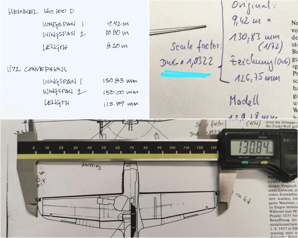

I hope what I wrote makes sense, Mike. Right now we are converting the D version specs to 1/72 measurements.

Thanks, Stuart. Well. So much for the Lindberg proportions. The cowling shape and the canopy location and size appear to be off. I believe the cowling issues can be overcome, but I am less certain about moving the canopy forward due to the wing root position. I am not sure how to proceed but we will proceed somehow.

Moving the cockpit, canopy and adding the missing rear side windows is a surgery which is not easy. Always the risk to lose the kit. The critical thing currently is that we or better I haven't find the actual failure or where it is located.
Bruce, I suggest to fix the front shape issue first. Then trying to find the easy solution for the cockpit?
